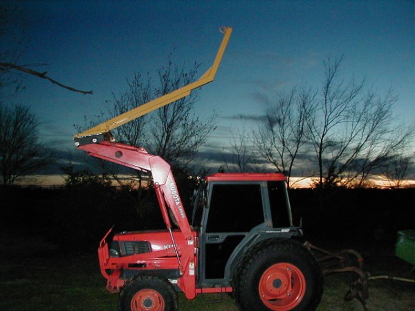

This is another type attachment you can use on your loader with a skid steer attachment. KennyV.

Hey KennyV, is that boom from DirtWorks? I seen one like it on their web site. I am think of getting one next summer to set trusses in the pole barn I hope to finally build. How high can you reach?
