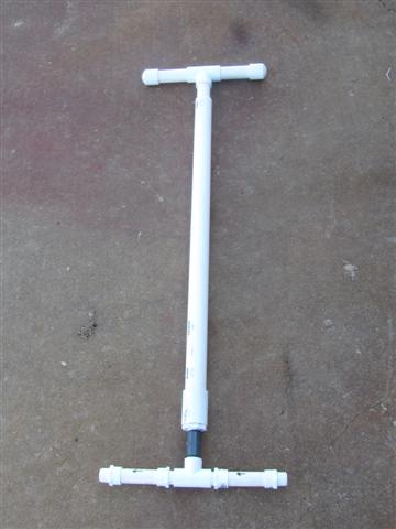

I was in need of a water pump that would move a bit of water. The ones I have are of low capacity. In a search of the internet, I found a few links on making a PVC hand water pump. The one I linked below is the model that I followed. Fabricating it is straight forward. I did not use the #320 O'ring nor the drilled out slip cap. IMO these 2 parts would tend to work against the pump. The pump works fine without them. I made mine with a 30" cylinder.
The O'rings on the piston and the check valves are the key components that make this pump work. Making the check valves was where I ran into a problem. I could not find the right ball to use; no marbles, acrylic balls nor rubber balls of the right size. I was dead in the water. So I had to look for an alternate way of making the check valves. I found the answer in the fishing department at Walmart. I used a balsa wood oval float. I had to modify and cut the thing but it worked.
Once I had the check valves made I did a quick test out of a bucket of water and this thing does pump the water. I held the pump in one hand, pumped with the other while holding the intake in the bucket of water. The water shot out and I tried catching it in a gallon jug. Most went in the jug and some on the ground. A few strokes and the jug was almost full. Not a good test but it proved the pump works.
Tomorrow I will get 2 threaded couplings so I can attach hose nipples and an intake and output hose. True test tomorrow.
So if anyone is interested here are the links. Note the parts list calls for a 1" plug. It should be a 3/4" plug.
I give credit to Grant Thompson "the King of Random" for these videos.
