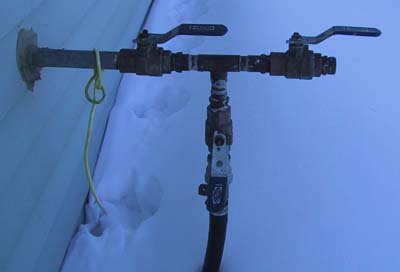

Rockportred, I've buried 100's of feet of plastic 1" line with a subsoiler or single tine middlebuster. There about $85 at Fleet-Farm (King Cutter).
Put a chisel point on it.Take 2" grey plastic electric conduit about 2 to 2 1/2 feet long and heat it up by slipping it on an exhaust pipe and curve it a gentle 75 to 80 degrees. Using 3 or 4 worm gear clamps, fasten it to the back of the tine so the curve points backward at the level of the chisel point. After 2 or 3 passes to get as deep as you can feed the plastic pipe into the conduit as someone drives the tractor slowly. I can get about 6 to 7" deep ; with a longer tine/shank on a true subsoiler you could probably go deeper. Make sure you have plenty of diameter on the conduit; even a 1" water line takes quite a bit space to make the curve, especially with soil bubbling up around things. Here in central WI, I have to blow these out for winter. One hint,don't leave ball faucets closed with water in the ball, they'll freeze and and bust the brass housing. I leave them open with aluminumn foil over the opening if the are pointing up or in an underground access box that can flood in the spring.
By just "slitting" the ground there is minimal damage to the lawn.
Here is a picture of the faucet arrangment so I can blow out the lines.
RCH<P ID="edit"><FONT SIZE=-1>Edited by Rch on 1/1/01 01:54 PM.</FONT></P>

Apparently you cannot add a picture on "edit", so here it is.
RCH
