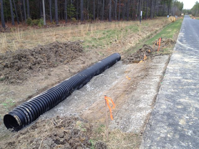

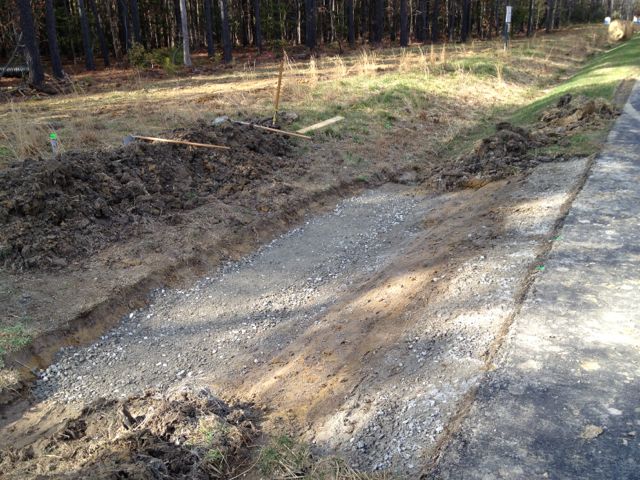

I just finished putting an entrance culvert on our new property. I thought I'd walk through the process with some photos.
After determining the culvert location and layout, the first step was to strip all grass, weeds, and topsoil from the area and lay down a bed of compacted crusher run:

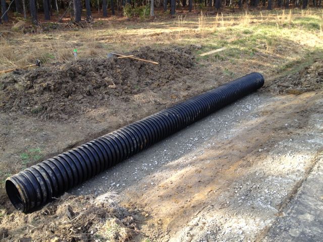

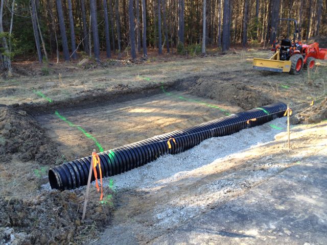

Next, the pipe was placed. I used a 15" ID / 18" OD dual wall polyethylene pipe, ADS N12 (cost $165). The bedding was 4" deep, and placed so that the inner wall of the pipe was about 1" below the ditch bottom.
attachment.php

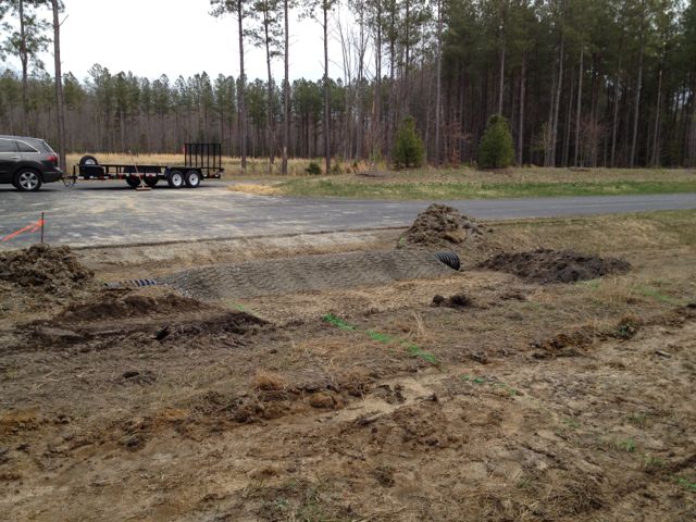

The next day, I got more crusher run and placed it around the pipe to hold it in place before doing further work:
attachment.php
Once the pipe was in place, I excavated a larger area to complete the driveway entrance. I had to remove 8-12" of topsoil from this area, totaling about 8 yards. I used the front loader to dig out the uppermost soil, and then switched to my box blade with rippers once I got close to the clay base. I found that I could back up about a foot to let the rear cutting surface seat the box blade down into the soil, then go forward to scrape a layer off.
attachment.php

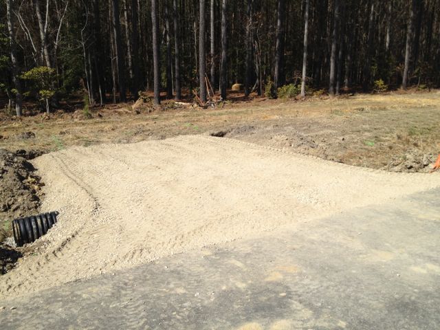

From there, I finished covering up the pipe with crusher run, and thoroughly compacted it. This would let me safely dump a bigger load of crusher run on top of the pipe.
attachment.php

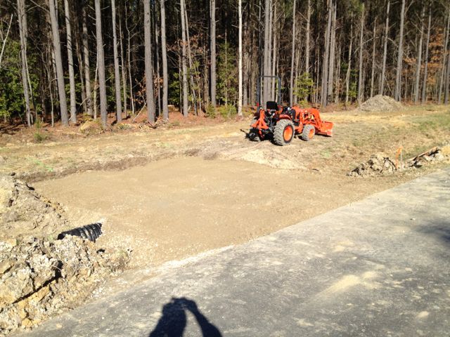

Here's the first 10 ton load of crusher run spread over the whole area, and compacted:
attachment.php
And here's the second 10 ton load:
attachment.php

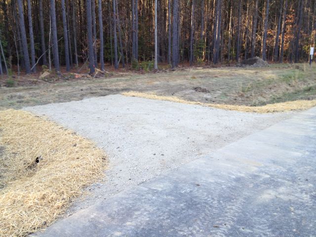

I compacted this second layer, and then used my box blade (without rippers) to shape it and add a crown. I estimated the depth of gravel over the pipe to be about 13", just above the 12" I was planning for (more is better -- the minimum according to code is 9").

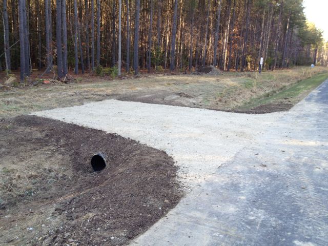

This afternoon, I used some of the excavated soil to buid up a shoulder, which interleaved with the edge of the crusher run and got compacted, then I finished it off with some top soil.
attachment.php
Finally, I threw down some grass seed and covered it with straw, just in time for rain tomorrow.
attachment.php
The rain will finish tying everything together and help it all settle out. After giving the entrance some tractor and vehicle traffic for a few weeks, I will add more crusher run as needed to fine tune the surface shape.
