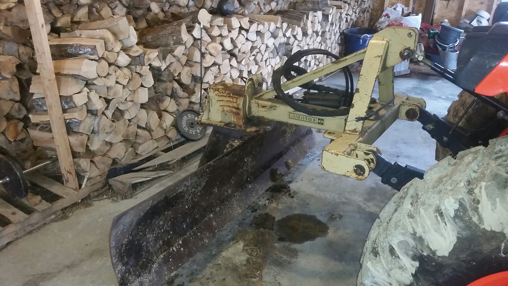

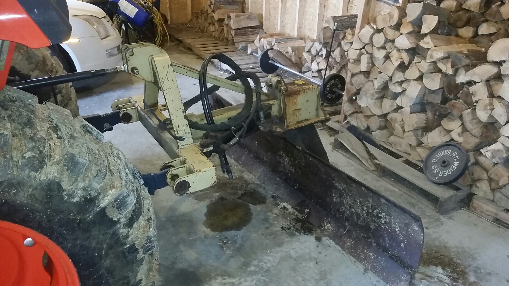

I picked up a new toy/attachment on Easter Sunday.
It's a Landpride RB3584 (7'). It's in fairly good shape, the kick stand needs to be fixed and the king pin is a little loose.
It has an offset cylinder but I would like to modify/move it to control the blade angle.
If anyone has done this I would love to hear your opinion, or better yet see some pictures!
Also I didn't know if this belongs here or in customization, so sorry if this is the wrong place.

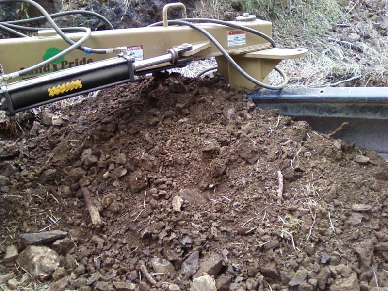

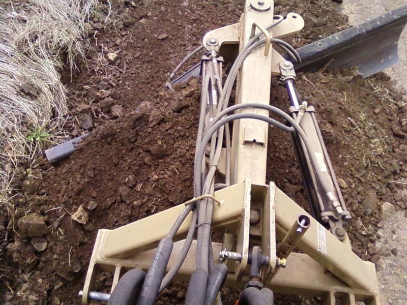

I have a Landpride RBT 4096 with three cylinders on it and really like it.
When I was looking for it I evaluated several options that involved ones without cylinders and had manual brackets. I looked at what I would have to do to put cylinders on it as a retrofit. What you are wanting to do is just retrofit the 3584 as I considered before I ran into the one I did that was already configured. I have digital manuals for the 40XX series and may have them for the 35xx series and will look for them. You might find them online as that is where I found them. In those manuals you will find the specs for the cylinders to run the different modes. I doubt that you can use the existing cylinder in the angle mode as they are probably different stroke lengths. Might be the same however, you would have to check the manual to confirm. I will look and see what I can find but you may be able to beat me to it as I am on the road and will not be back for several days. Take a look and you can find the specs. The cylinders are not cheap but not that bad either. If you are using it for ditching and the like, you may find that you want both cylinders. I know I have all three and I would not want to try to do the ditch and road work I do without the three working together as I am constantly adjusting it as I work.
