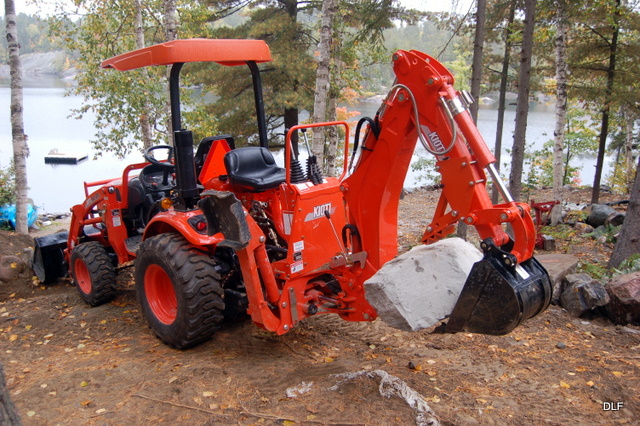

I am about to buy a CK30 HST with a loader and KB2375. I wanted to have the dealer put a manual thumb on it because I need to pick and place rocks with it. Has anyone else done this? also what is the difference between the KB2376 and KB2376 ?

Have not put a thumb on mine....yet. The KB2376 does not have a so called sub frame, what it has is a quick connect system. with one pull of a lever, you can lift the unit ,with help of the outriggers & boom, and it comes right off the tractor.the frame for the hoe is attached to the right and left axle, the rear of tractor, and also down both sides of to the front loader. This gives you much more ground clearance and departure angle, also moves the operators seat closer to the center of tractor. The hoe itself only has around 4" clearance between the rear of tractor and the hoe unit, far less cantilevered out the back.

Well, maybe you mean the difference between the KB2365 and KB2376? About a foot in reach.
</font><font color="blue" class="small">( The KB2376 does not have a so called sub frame, what it has is a quick connect system. with one pull of a lever, you can lift the unit ,with help of the outriggers & boom, and it comes right off the tractor.the frame for the hoe is attached to the right and left axle, the rear of tractor, and also down both sides of to the front loader. )</font>
According to Kioti's spec site on the KB2376, it is a subframe model. What you describe is the backhoe that is made for the LK3054XS TLB unit, the sister to the LK3054XS (which is a less dedicated TLB). It is the only tractor that backhoe is now made for, has a subframe with a four point mount at the backhoe connection, but has a subframe. It's just that the subframe stays on the tractor, and as you said, doesn't interfere as much with clearance. This backhoe also has the control deck that can be tilted to or away from the operator for easier control of the levers, is easier to load on a trailer, and as you said, come off with one lever and lifting with the stabilizers and boom. It's a nice unit and I hope Kioti will go this way for all their backhoes.
