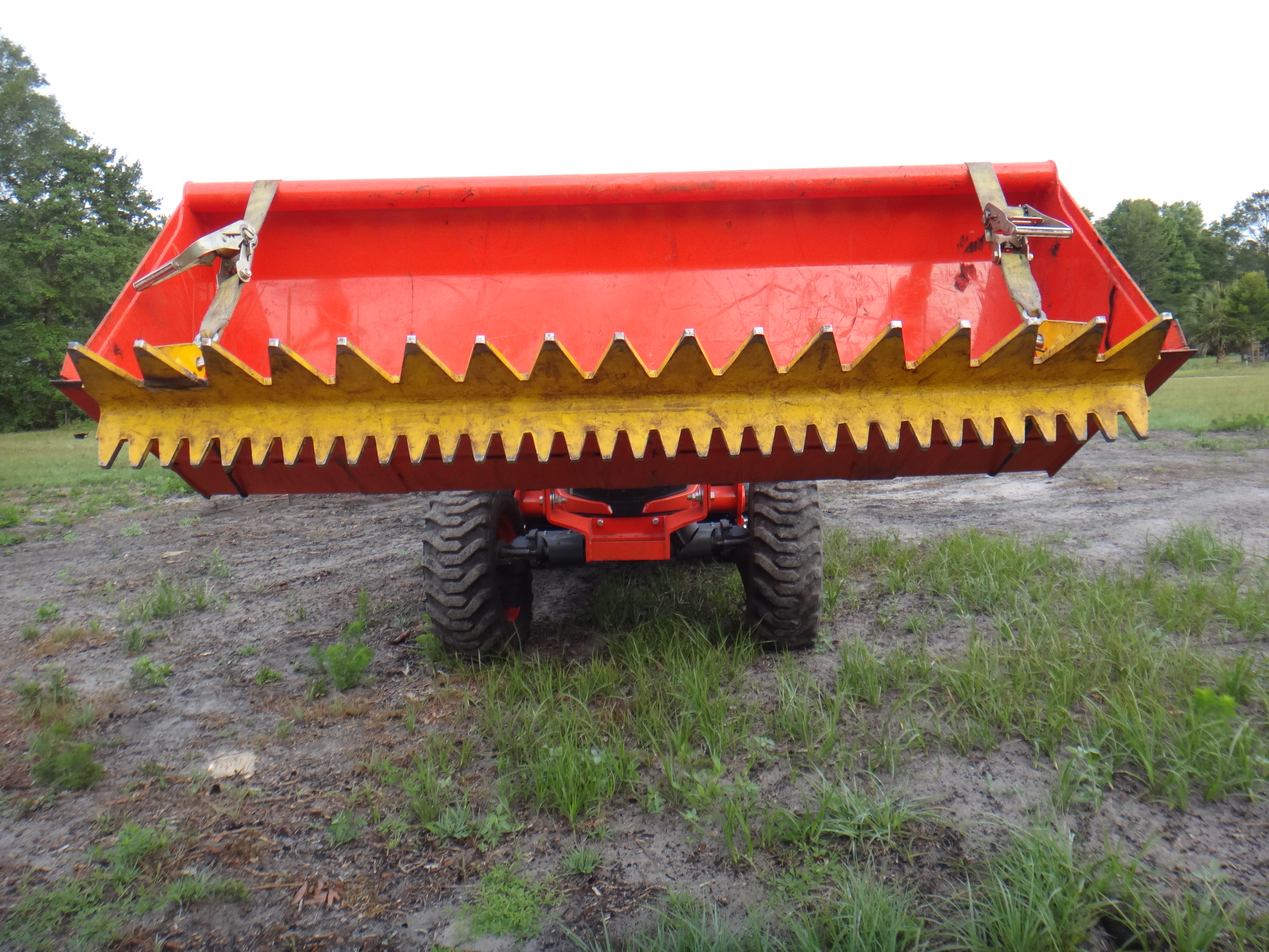

Consider that a Ratchet Rake bucket attachment may be cheaper and work as well or perhaps work better.

Try googling front runner grader rake, heres a couple pics

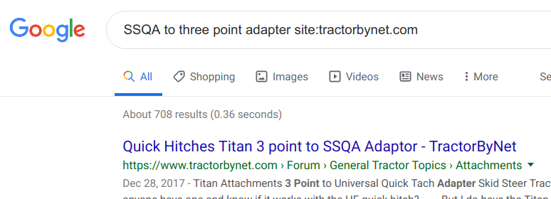

I just did 鉄SQA to threepoint adapter in google.

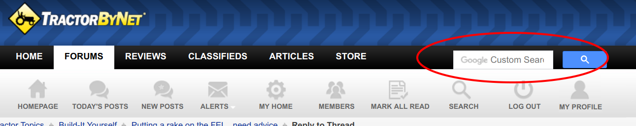

At the top right of the TBN page, there's a "Google Custom Search" box that will look in TBN.
You'll have to scroll past all of the ads in the output, of course...
You can also search from normal google, and include "site:tractorbynet.com".
This works for any website, and you can also exclude sites by using a dash, eg "-site:pinterest.com" (super useful when you're trying to figure out what is in a picture and all you're getting on images is pinterest, I've found pinterest to be pretty but vapid, doesn't give any information about what the stuff is).
