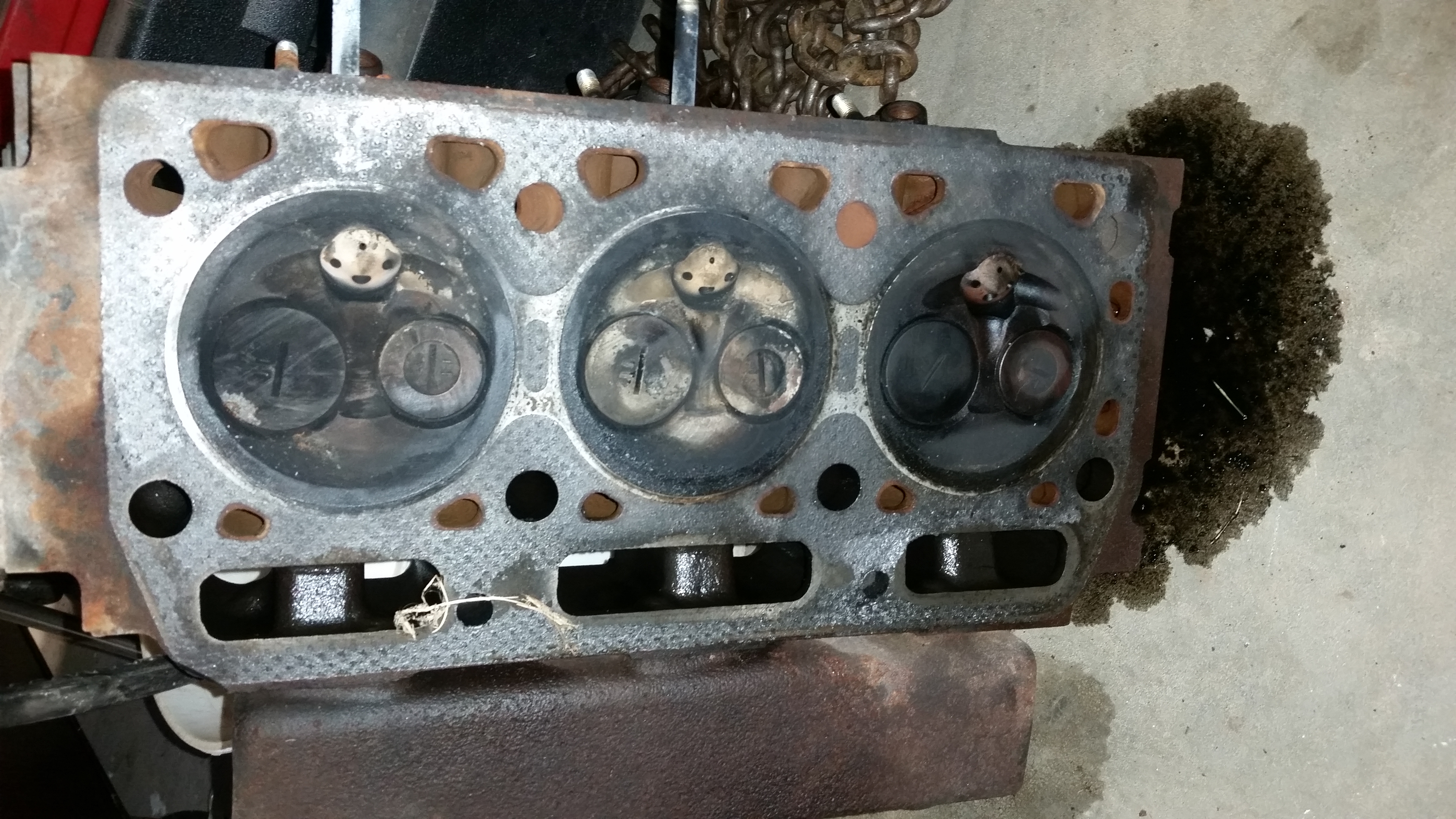

I had a few minutes to look over the cylinders and it looks like #1 and #2 have problems. #3 is too far up in the cylinder to tell much. Hopefully we can pull the pistons this Sunday and see.
Here is a of pic of one the cylinders.
And head.
I do plan on getting the head surfaced.

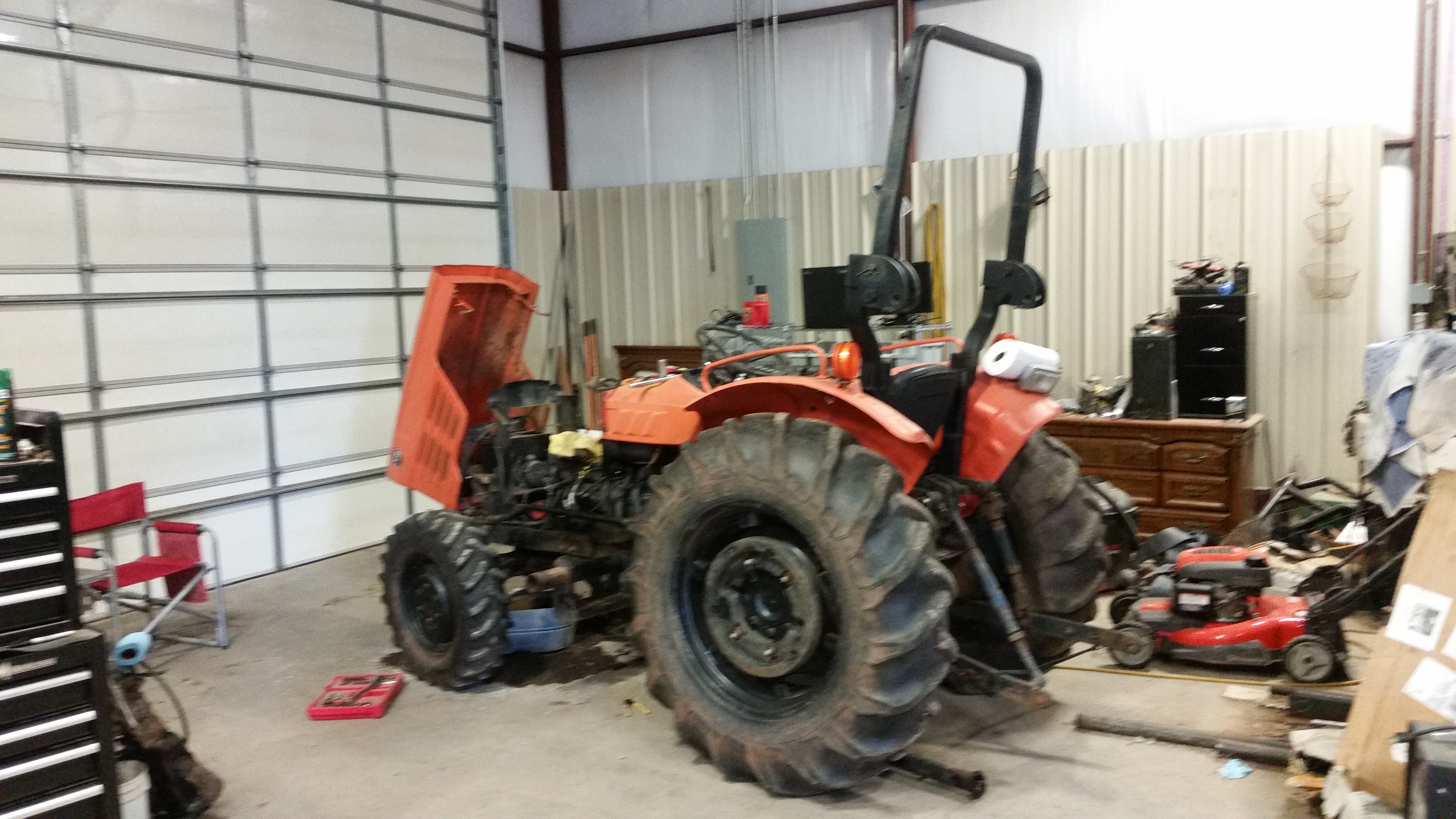

I didn't mention it in the first post but I gave this tractor to my son just for being a great guy. He is pretty excited about it. When we get the motor running I am considering a quick hitch for the rear and changing the FEL to SSQA. Maybe a 3rd function later on.
Here is a pic of the tractor torn down. FEL is outside.
Looks like we are going to need a ring and pinion for the front end. Anyone know where to get a R/P? Seems they are scarce.
Looking at the axle attachment to the frame it looks simple enough to switch the whole front axle out even to a different model. Anyone know of a model that will work or the diff ratio of this front end?
Off to search, thanks in advance!!

Honestly I don't think that cylinder looks bad enough to be seized up. Not sure on the other's. Scoring of some type. Broken rings?

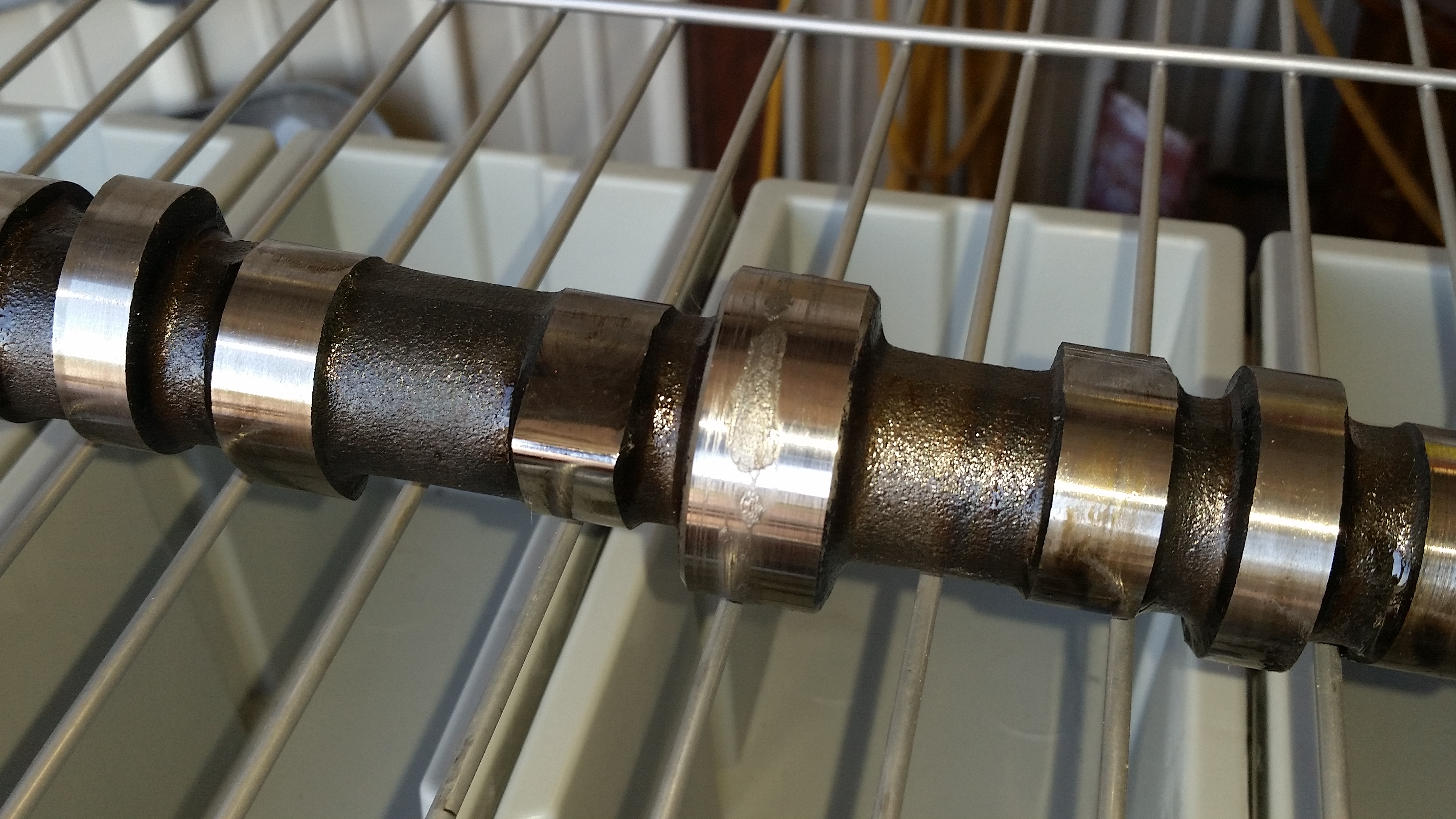

We did get the rest of the motor apart and found the problem. #2 cam bearing was seized. #2 piston/cylinder were scored to the point they are probably ruined. Crank spins properly after taking the cam out.
We are calling around to find someone to regrind the camshaft then we should be in business!
