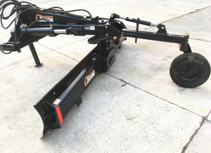

Would it be possible to add gauge wheels to the back, so you could adjust the height?
   / Putting a 2.75" hardened steel pipe on rear blade for plowing in soft conditions?
The blade came with a hydraulic gauge wheel, but it sits back about 3-4ft behind the blade. It didn't seem to work very well with my roller coaster roads, but then again I was new to tractoring back then. I could see gauge wheels that are right next to the blade working better, but that's a lot more of a project than fitting a pipe to the blade.

Farther back the better, I'd think ... Think about a big road grader, there blade is in the middle between there v e r y long stretched out wheelbase.
I'd may take awhile to get the road smooth, but once smooth, the snow removal will be so much easier/faster, and much better for general driving ...
My driveway is only about 1000' long, it was rough when I bought it, but my land plane smoothed it out, not I can easily drive over 25 mph if I want to, usually less than 10, because I'm not in a hurry ...

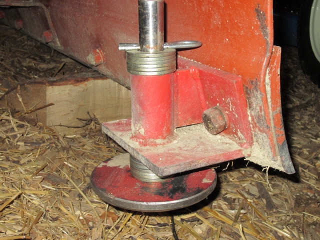

I made brackets to hold snowplow shoes for when the ground is soft.

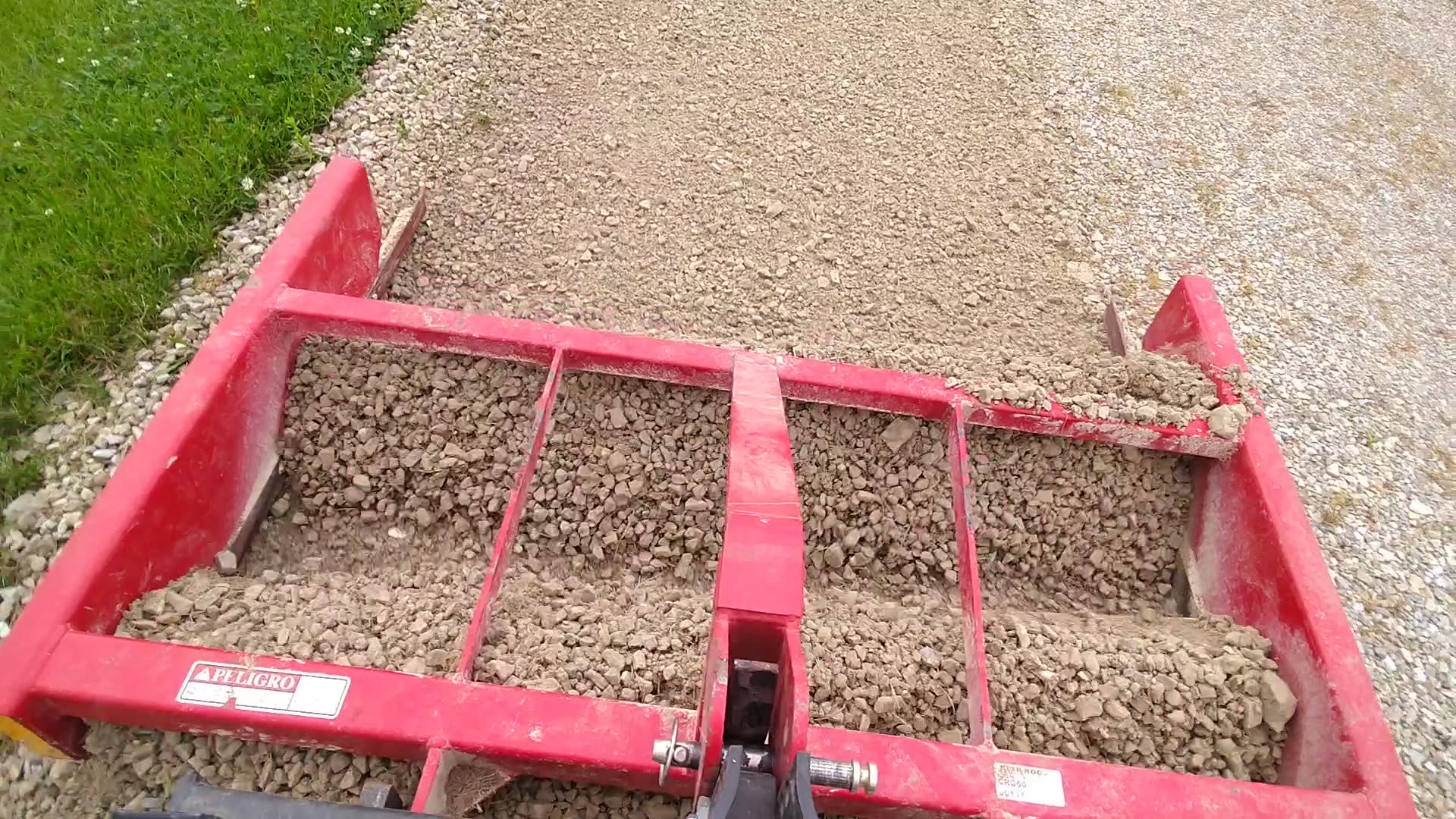

I thought further back (for the gauge wheel) would be better too, but the problem is when you're trying to grade a roller coaster of a road... I bet it works a charm for flat ground though.
My road is baby butt smooth (I also use a land plane for smoothing). But when the ground is soft, you have to use the 3pt hitch to adjust the height of the blade every time you crest a hill or hit a g-out. But if you can get the blade/implement to glide over the top of the gravel in float mode, you can just set and forget for the most part.
I sometimes do this in the summer with the rear blade turned around when the road is firm. It works great to smooth out the gravel a bit. The blade just tracks perfectly and I don't have to constantly adjust the 3pt hitch.
I tried this last winter and it didn't work for my conditions. The shoes sunk into the road and caused the blade to dig in. Admittedly this was the part of my road that is just packed dirt. Which just turns into packed mud under the snow when it's above freezing.
