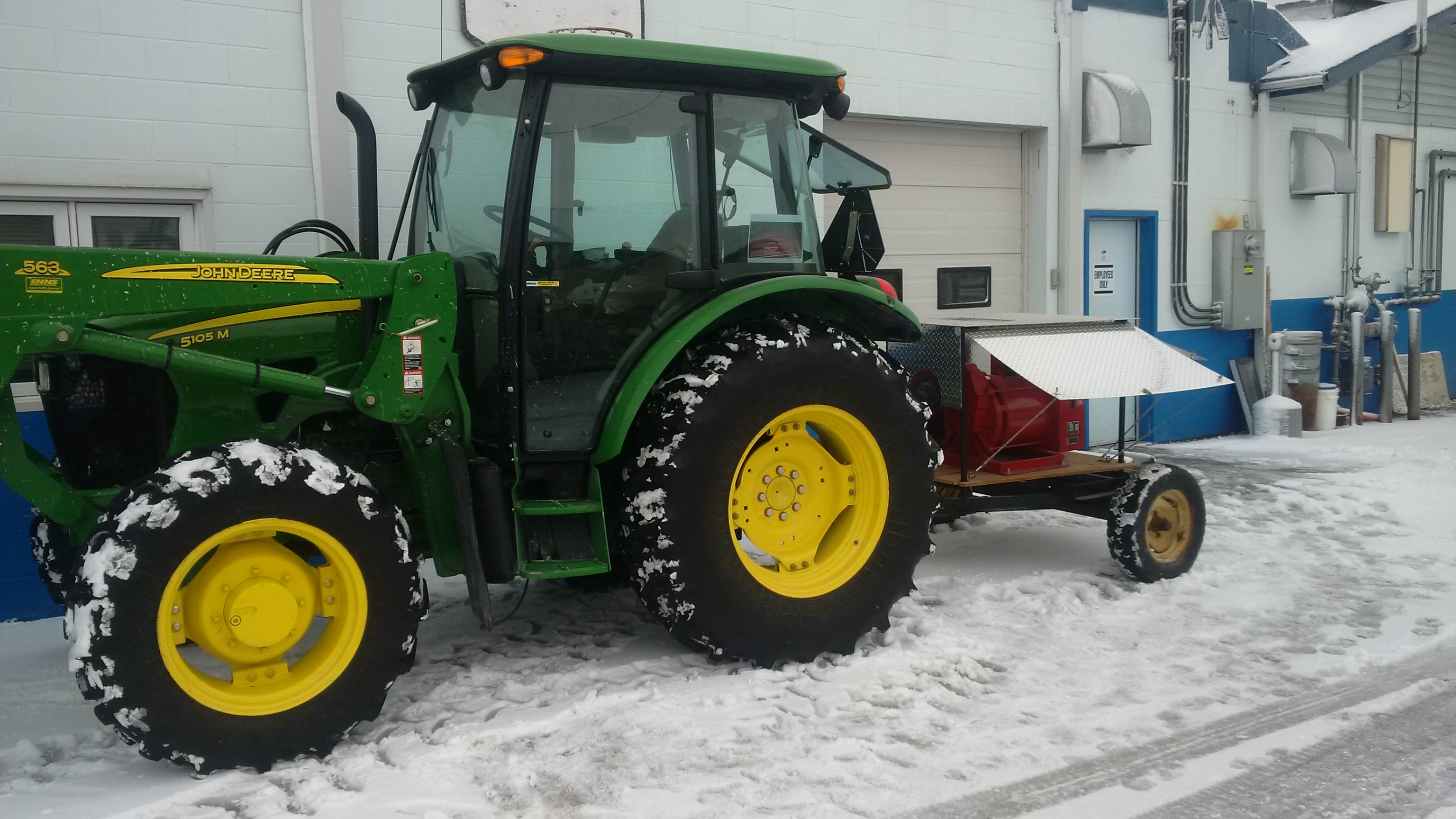

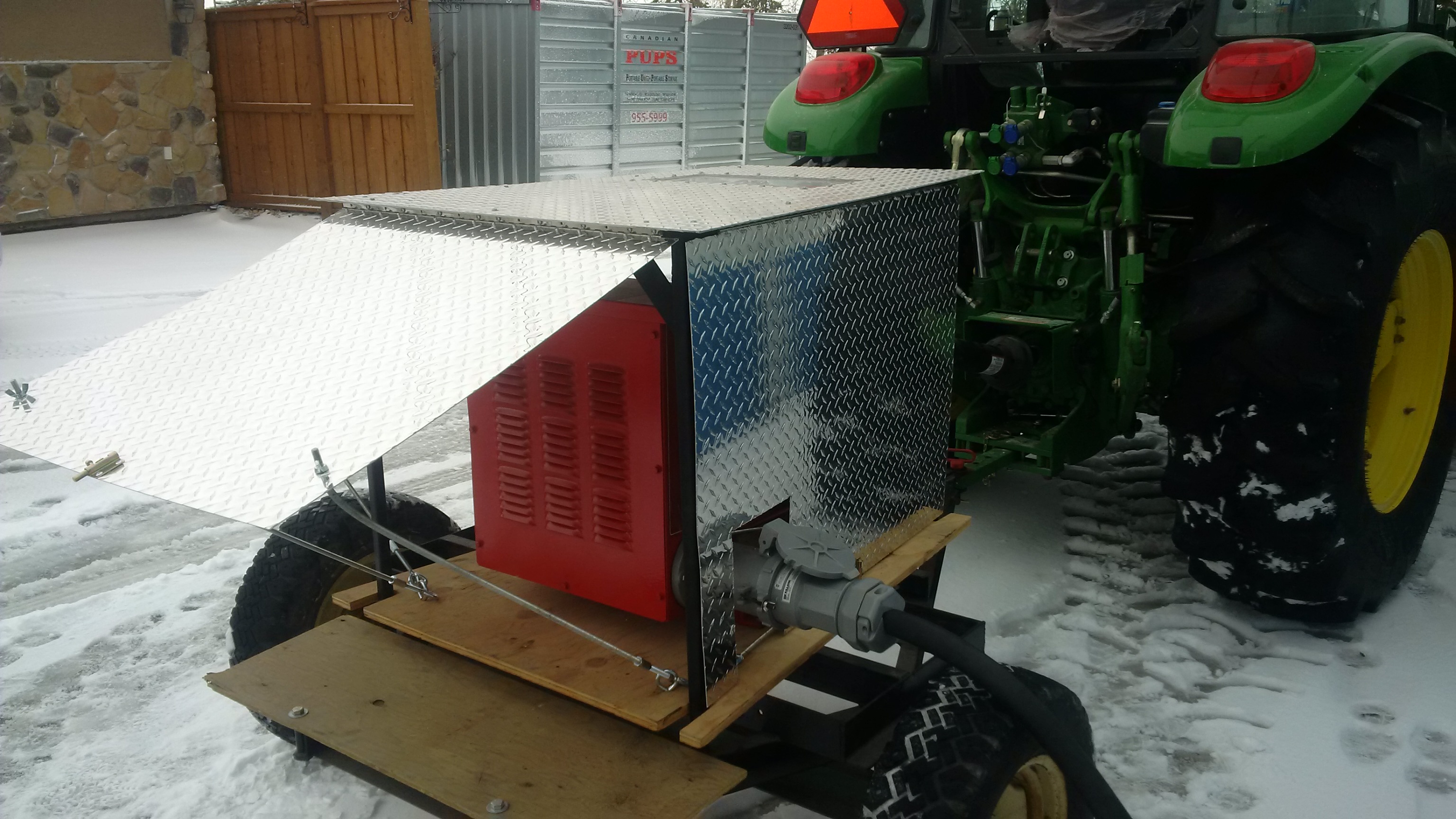

Woke up this morning to the power flickering at about 06:00. It struggled for about 10mins and then quit. It was wet heavy snow with a strong wind, turns out many transformer fires and probably some down lines. By 8:00 it was apparent it wasn't going to come back on. Our family business (boarding pets) needs power to run the furnace and sprayers to keep the critters safe and happy. Fired up the PTO generator (Dayton 40kw/80surge). First time we've used it other than a couple tests. Ran like a champ, ran everything at once. After 8 hours, power came back on, everyone happy. With all the equipment,including the computers etc, I kept a very close eye on the frequency, it seemed to vary slightly about 60.2 to about 60.5. I remember reading someone saying specs/allowances etc, but can't seem to find it among all the threads. I think this variance is acceptable, but just hoping for a confirmation.
The other interesting thing I thought was less than half tank for 8+ hours at pto rpm, I thought that was reasonable.
Thanks
Brent

60.2 to 60.5 Hz is an excellent stability. I would not be able to think of anything that would notice that except an old style electric clock that would be a couple of minutes off.
later J

It's the tractor, not the generator that dictates frequency. The Generator does control voltage.

So that means the governor is handling the load changes nicely then thanks. Hmmm, I wonder how close we were to maxing it out?

Without knowing exactly what the Dayton PTO Generator has for gauges, you have other methods of capturing your output usage total. Get yourself a clamp-on meter. That way you can see what you total draw is at that moment. The meters usually also have a peak hold setting to see what the highest surge call for power was. My Tiger Power PTO generator 30kw has it built into the generator. It does help with knowing what your draw is and how many other items you can start and run.
Here is my unit drawing 18kw-15.4kw and something dropping off, maybe a a/c unit, or well pump.
[video]https://www.dropbox.com/s/d2g0zdbjdi83rd6/generator%20running.mp4?dl=0[/video]
You would get the same type of info from a clamp-on meter. That way you could see if your PTO generator would suffice. I am pretty sure it will. I know my 30kw is a 30kw prime continuous unit. In other words, I can run the thing right up to the full 30kw for 24/7.
good luck
