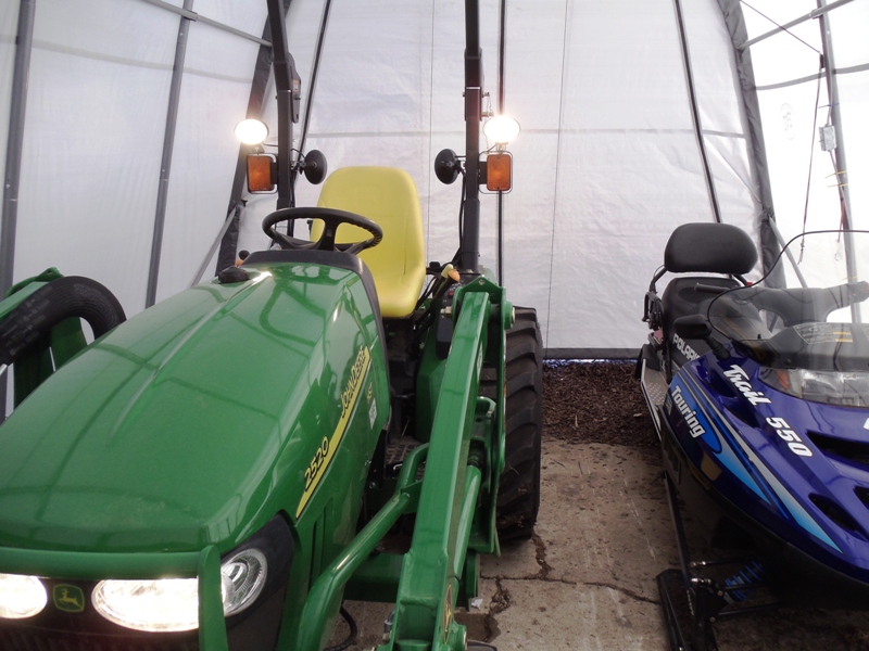

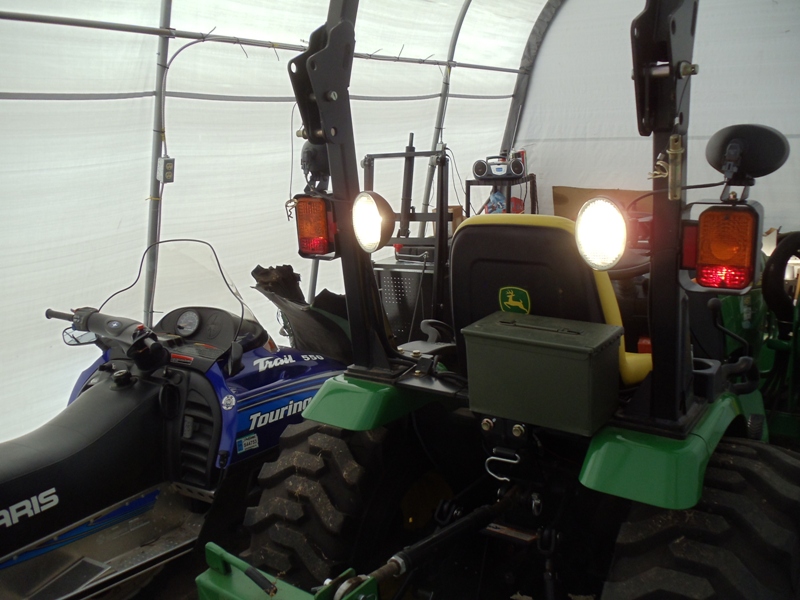

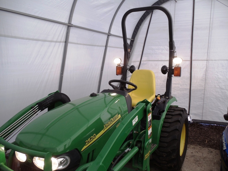

used 2 rear light kits and 1 front light kit. The rears on on their own seperate circut.

Kep looking good :thumbsup:
Sometime I need to add lights to my 2520. I could immediately see what people meant about the standard factory lighting being blocked by the bucket while out moving snow at night.
I also like the idea that you ran another circuit back to the rear apparently so you could turn them on only when needed.
I've been thinking about how I would mount lights on my 2520 with a 46 backhoe.
   / put some lights on the 2520
the other reason for a seperate circut was each pair of lights draw about 9 amps and the lighting circut is only fused at 25 amps. I already had a new circut running to the rear for the 3 point sprayer so it was just a matter of adding a plug and a switch to use that for the rear lights in the winter.
