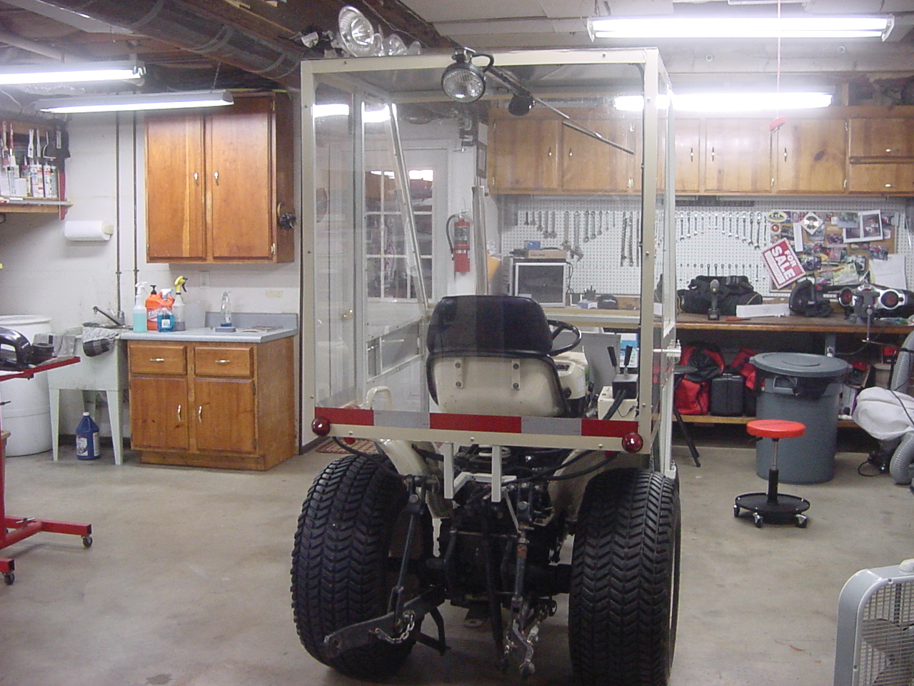

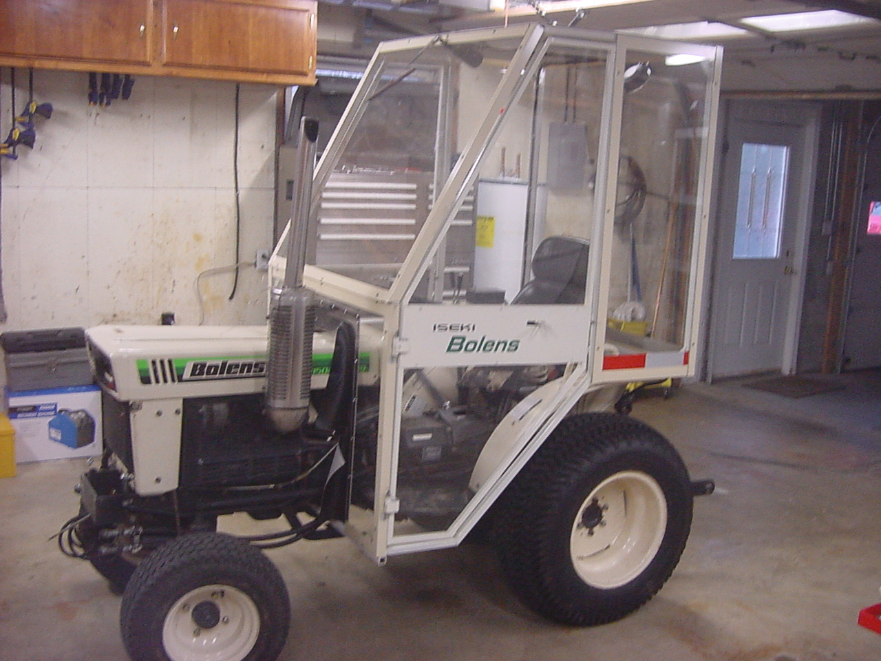

About 3-4 years ago I bought my Bolens for snow removal upon purchasing our new house. Not long after I decided to build this cab. I put in on today for the upcoming winter, just thought I'd post some photos of it for anyone thats new and into fabricating stuff for their tractor. The cab makes a tremendous difference when using it to remove snow in a storm. I remember when building it there were a few questionable features to add, I've learned since then that: A windshield wiper is a must have, a defroster however is optional (this was a BIG question when I was finishing it, I got alot of different opinions on adding it). A reverse light is a must have, I added a dome light also to see what the RPMs are as well but its not imperative I guess.
I built this after searching for a factory Bolens cab which was hard to comeby. Since then I have seen a few though for sale, figures LOL.

Nice set up and you will be a very happy camper when plowing. :thumbsup:
