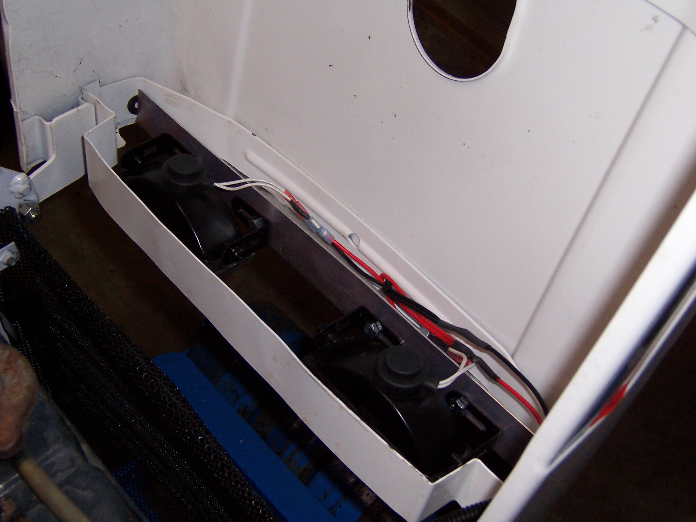

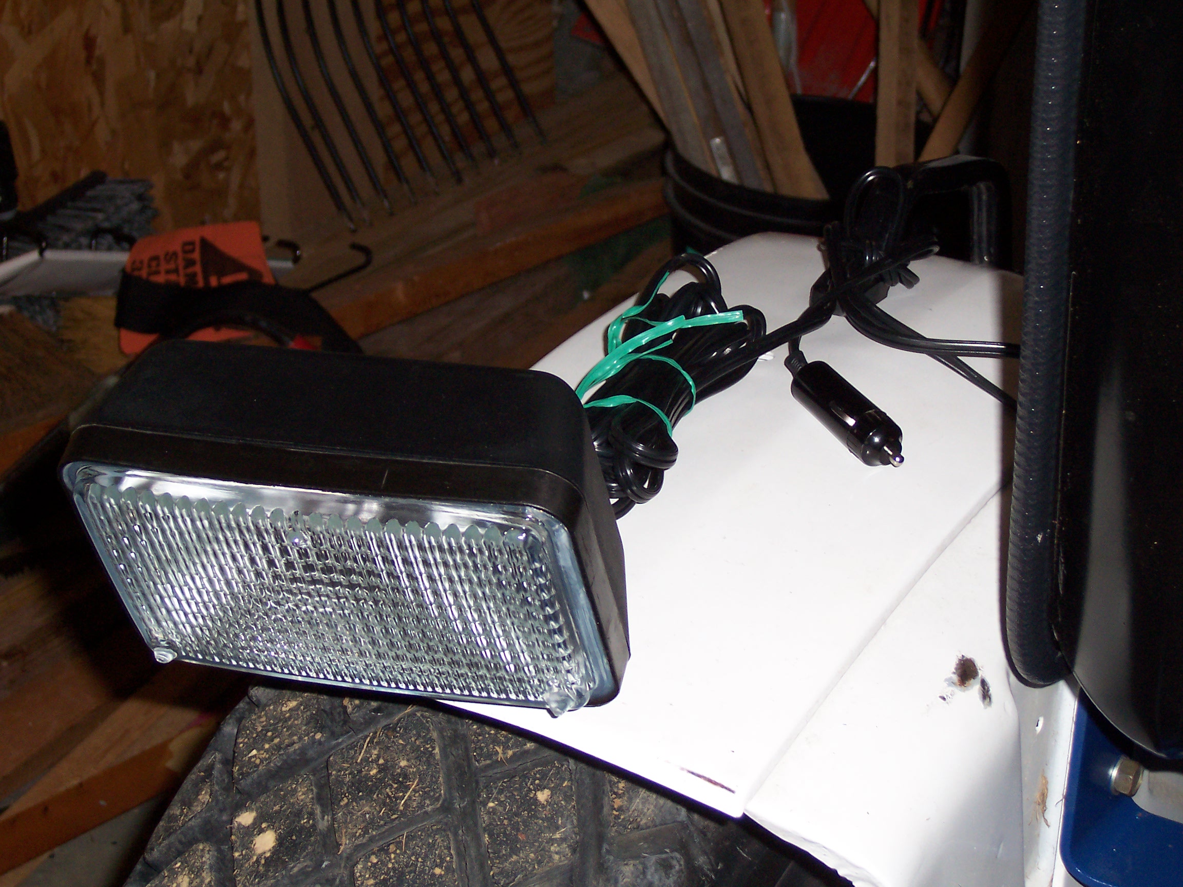

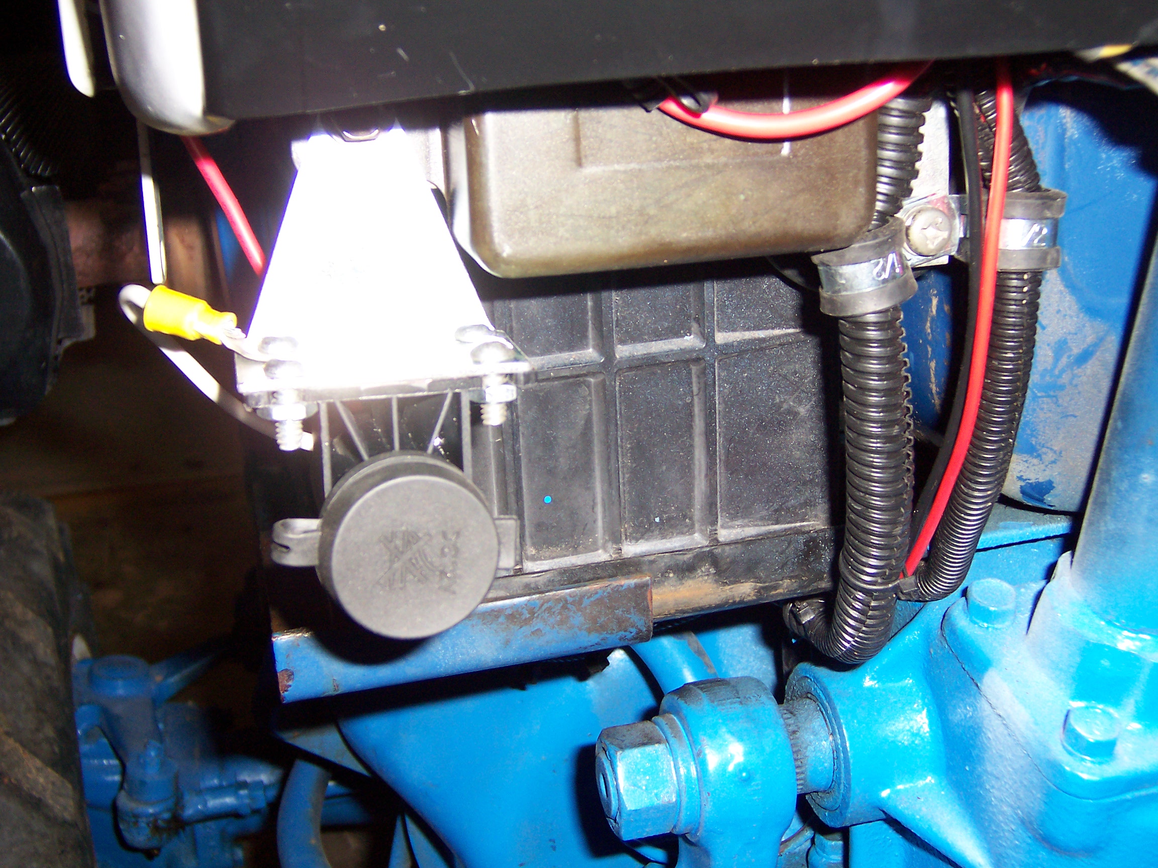

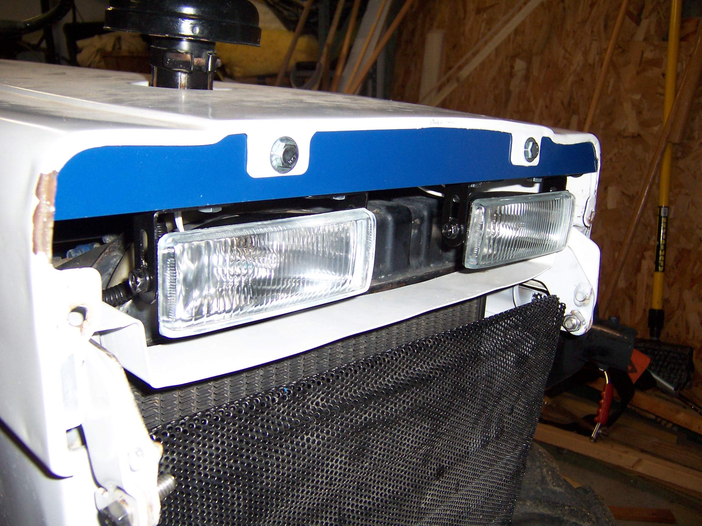

Bought this tractor without the plastic headlight mount/trim piece. Wiring was still there, but burnt. Worked on a lot of under-dash wiring stuff this summer, and got an alternator/regulator kit from Valley a while back. Time for lights. Bought a pair of small 55w halogen flood lights (#18816) for $14 and a Peterson V504HFM magnetic mount 55w light for the rear. Used a 1 1/2 x 1 1/2 piece of angle aluminum to mount the front lights. Installed a relay and new switch. Installed a cigar lighter/power outlet under the dash for the rear light and maybe some other future use. Tried it out tonight, plenty of light fore and aft.
