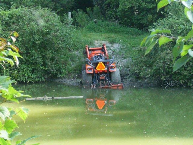

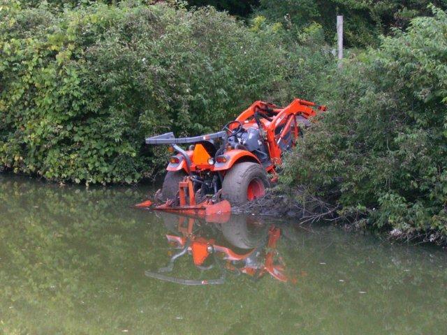

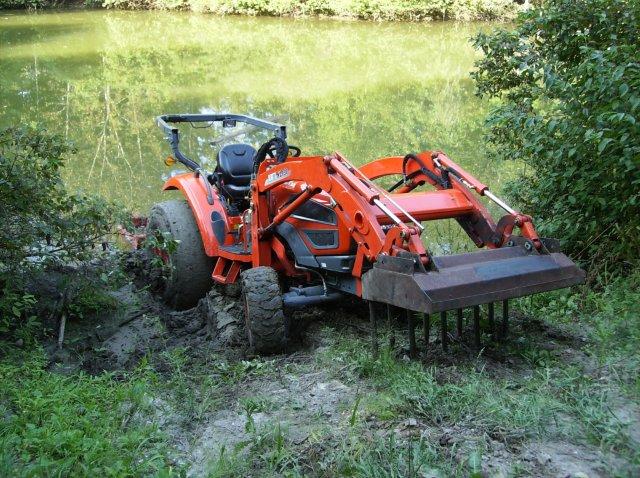

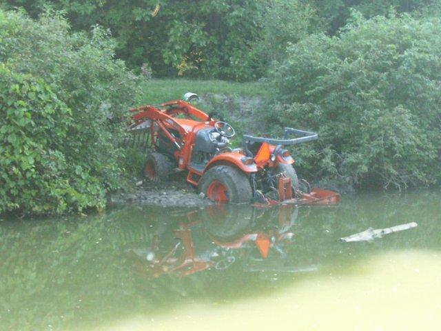

A while back I put the back end of my tractor (CK30 hst) into the water. It was in up to the rear axle for about 2 days (took a while to get it out). I went to the dealer to ask if there were breathers or any other areas water could get into the differential or ?? and he said I was not deep enough to worry. He also said I could check my oil and see if it was cloudy. I did take an oil sample and it was beautiful, fresh and nice, looked perfect.
However the other thread about a tractor with problems makes me all worried.
http://www.tractorbynet.com/forums/parts-repairs/192962-ok-whats-wrong-pic.html
Are there any tips you have about what else I could check or do?
Here are pics of how deep I was. I really don't think I was in that deep but now I'm all worried.

Just my opinion, but looking at the pics it sure doesn't look like you were anywhere close to deep enough to cause that kind of trouble.
Mark
   / Put her in pond - not bad but what now? #4
I agree with your dealer.
It doesn't look like you were in deep enough to worry about.
If the oil is not milky/cloudy you will be fine.

The axle shaft was still above water, so water wouldn't enter at axle seal. the breather should be on top under the seat area. I would just check the dipstick for cloudy oil every ten hours of use, until you get tired of doing it. There will be something new that comes along to worry about, and this will become just another funny memory.
