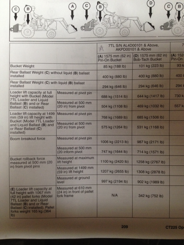

Here is the specs right out of my manual for my loader.
   / Pushing th limits
With the attachment this time

The last block on the bottom indicates a 752 LB capacity on the 42" forks, assuming the folks weigh 364 lbs. The 7TL capacity drops quickly as the load moves out. My guess is the center of mass for the 752 would be 21" out on the folks, which is about 27" from the pin location on the quick attach. You did very well using a strap at the pin, and it appears your tractor is pretty strong.
Caution though, you put one heck of a load on the front axle and lift arms, so I would not make a practice of it.
I am in the process of getting a hay bale grabber and running up against the same problem with lift capacity. Most manufactures say a loader with X lifting capacity will work. However......all is not true Fortunately Bobcat gave this detailed information. I have been using the fork lift table, subtracting out the weight of the forks, adding in the grabber weight, determining the center of mass and calculating the number of bales I can safely handle. Its a steep drop in capacity the further out you go. You can draw a simple straight line curve using the weights given in all the other blocks, but you need to determine the center of mass. An example is for the bucket, measure from the pin to the center of the bucket as if it were curled when loaded. Hope this helps
