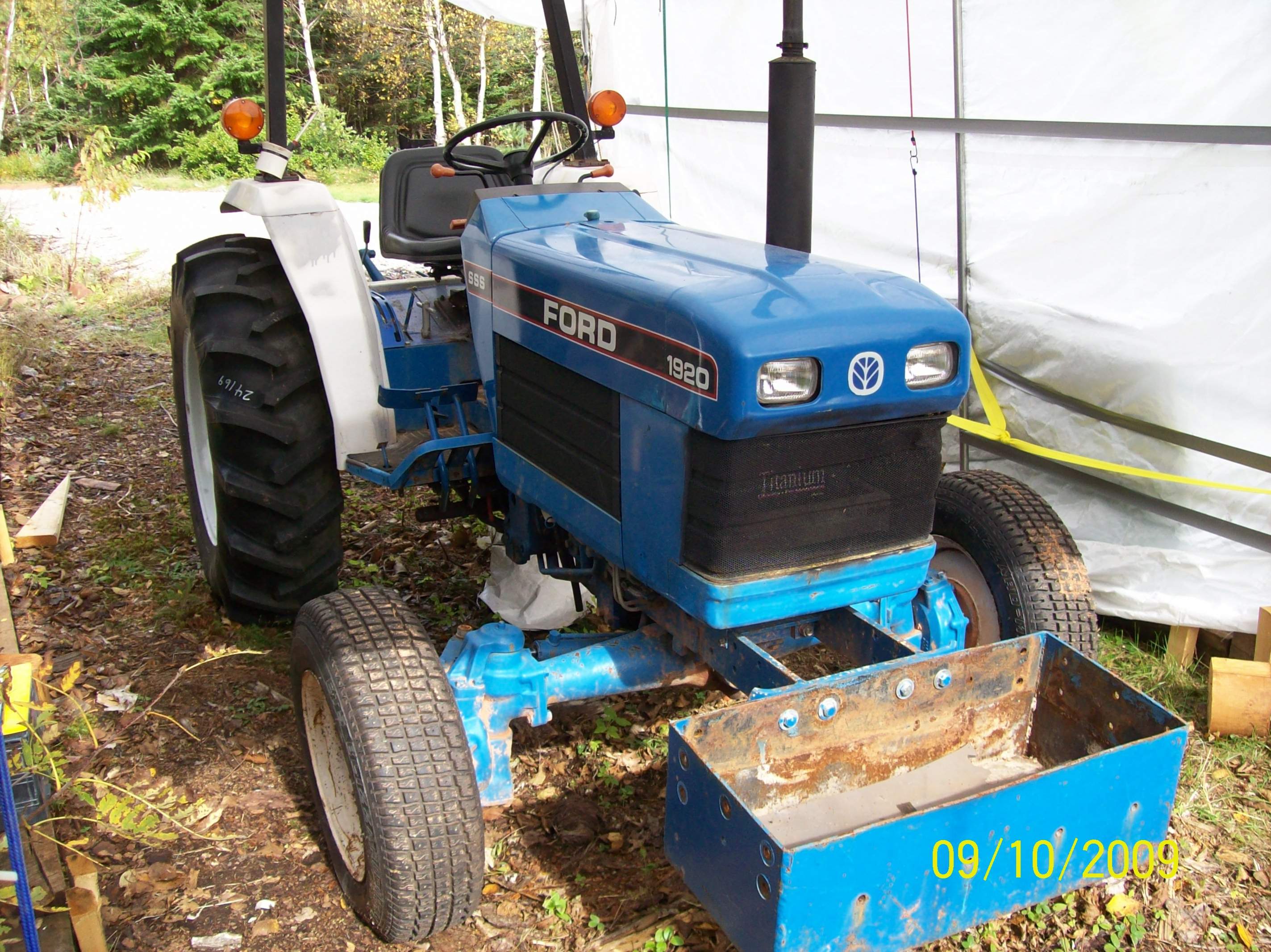

Ok, I'm a relative newbie so here goes:
I have a 1995 NH model 1920. I have put relatively new 13.6x24 Ag tires on the back. New auto winter tires on the front, very aggressive thread, but nonetheless, limited to 2WD. I could not find AG for front in time for winter.
I am also having trouble locating a used blower, and money right now is tight. With no FEL, is it possible for me to somehow put a blade on the front the the tractor so I could at least push the snow?. I may be able to get a used blade relatively cheap; I have about 2300 feet to push. We get lots of snow up here in Prince Edward Island, but the road is a private road with no one up here in the winter, so there is lots of places to push the snow. So back to my main question, can I mount a blade without a FEL on the front of the tractor?

Have you considered a 6' rear blade to plow the snow over to the side? You could clear the road quick in 2 passes, 1 up to the end and 1 back to start. I can't answer the FEL question. You might need calcium or (wheel weights) in/on the rear tires with a 2WD. Would be a whole lot easier than moving snow with a front loader set-up.
   / Pushing snow with a 1920 #3
Couple pictures front..mid..rear might help seeing if there's something for frame/push frame..also good set tire chains may help on traction pushing snow.
   / Pushing snow with a 1920 #4
The first question is, is it four wheel drive. If it is, are the front tires you put on the right circumference. If not and you are using 4x4 you will hurt parts! Yes they do make a plow for the front but you need hydraulics to raise and lower it. I would use a rear blade mounted to the TPH. If the tractor is 2wd I would load the tires and get chains. If it is 4x4 and you get the right front tires you will be OK the way it is. My 1900 fwd has no problems pushing snow.

Rear chains would be a must on the 2WD tractor. It will help a lot. And as others have said a back blade is a inexpensive alternative to get the job done. You will spend quite a bit to get a decent mount made up to put a snowplow truck style to hang on the front of the tractor.
Just to fill in the gaps guys:
1) The tractor is 4WD, but due to the front tires, I am forced to use 2WD.
2) We get about 100 inches of snow a year up here
3) Lots of places to push snow, since it is a private road and mostly vacant during winter
I like the idea of a three point hitch blade for the back.
Attached pic of tractor. As you can see, the tractor came with the front mounted box, it was full of concrete when I got it, took a jack hammer to get the concrete out. But that box is useful now for counterweight I assume.
Did a web search also for chains and found tirechain.com.
I assume that any standard blade will do, as long as a welder or someone can weld the appropriate mounts on the blade to mate with the hitch?

I am assuming your 3 pt hitch is in tact and operable?
This is a link to a heavy, pro model, back blade.
Professional Rear Blade, 6 ft. - 2137057 | Tractor Supply Company
They also have a standard model for $100 less.
These back blades are available at TSC, Farm/Fleet, and Tractor dealers anywhere, used, Craigs, etc. I have 3 or 4 neighbors up here in northern Michigan that have 8N Fords or similar and back blade the 100" of snow we get every year, quite successfully. Your tractor, even without the 4WD is very much a comparable tractor. Chains would make a big difference on any kind of hill or with an ice condition.

With a bit of welding you could adapt an old truck snowlplow to the TPH and push in reverse. I did that for years, though your neck won't thank you. My rig then was a 135 Massey, SLOW hydraulics. You can't lift it very high, though it'll go higher than truck-mounted. The arms aren't made for pushing, so you'll have to take it easy if the road is rough. Make sure the tripping mechanism works easily. May even want to reinforce the lower arms. It's a cheap way out, and aside from having to choose between a too-low and too-high reverse gear, works adequately for low dollars.
