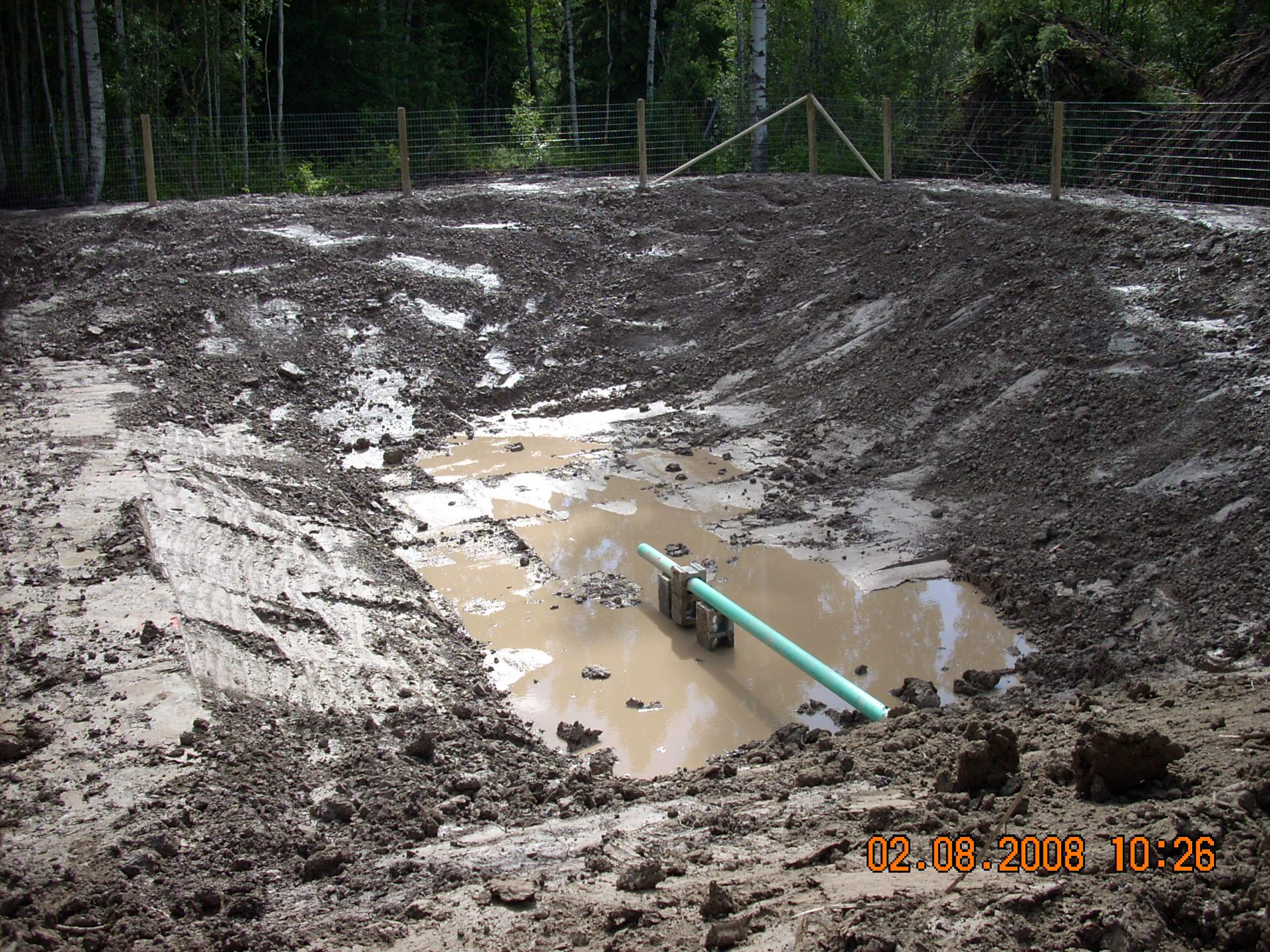

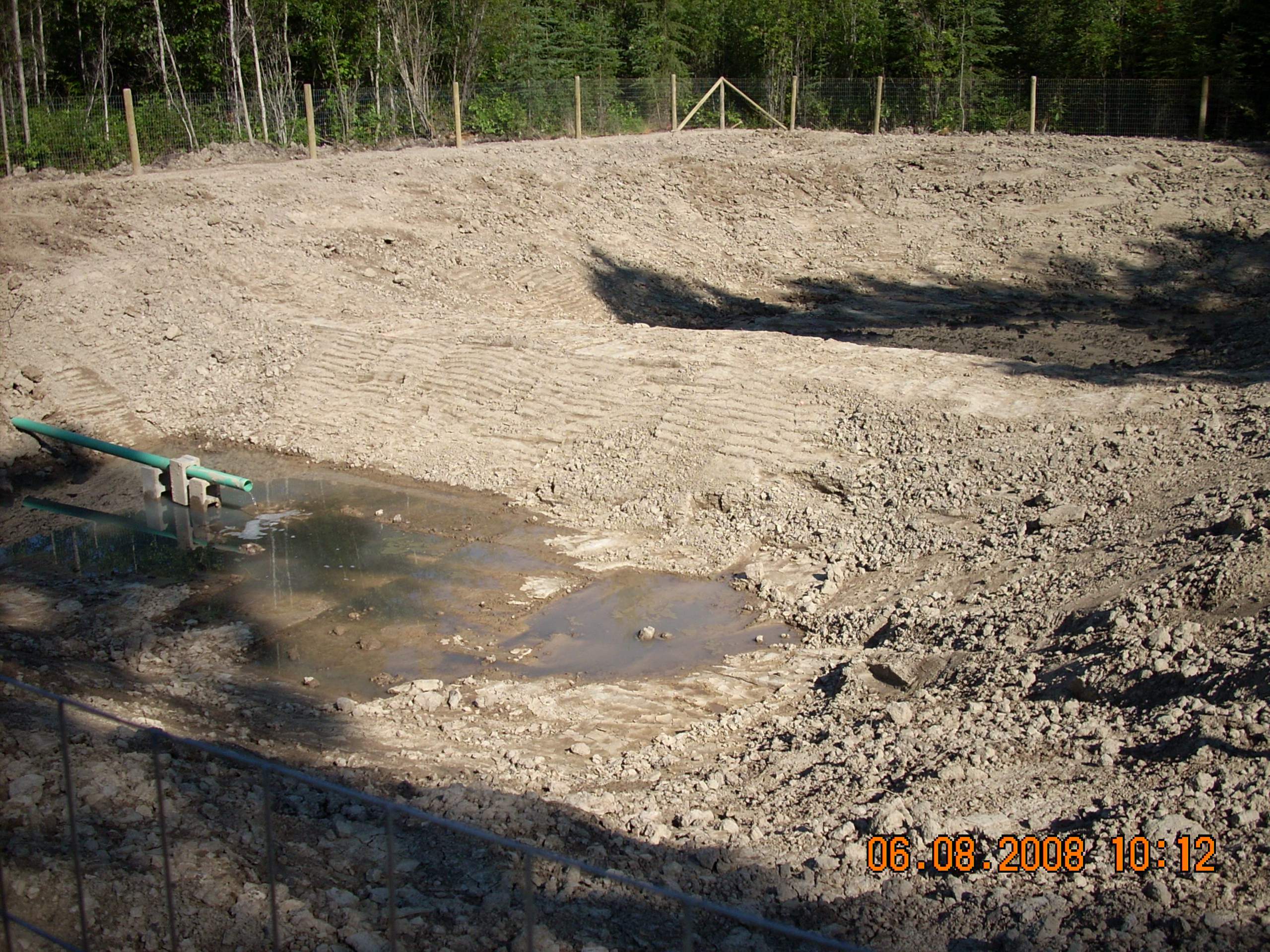

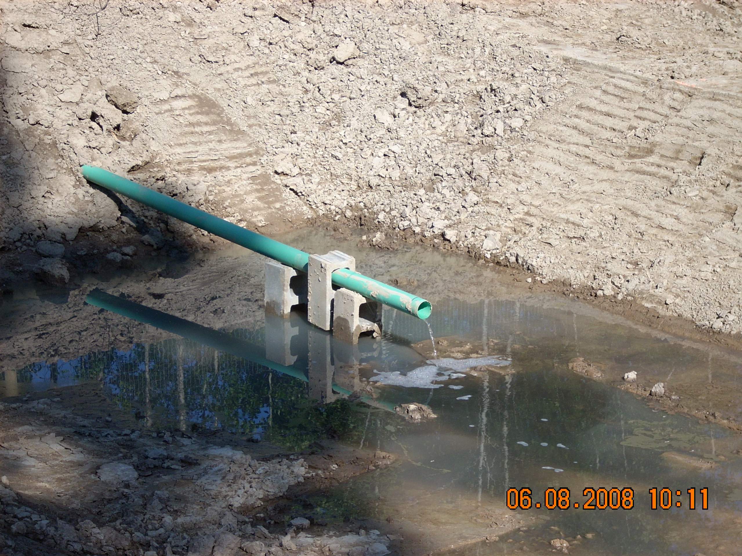

Jeff,
I have a new septic lagoon and it is fenced off (required by law in BC). The discharge for my septic comes into the lagoon at the bottom of the hole. There is a fence all around as required by law here.
I have attached three photographs that should give you some idea of what is involved.
Yes, you will find frogs and other aquatic animals in your septic - especially if you do not use too much bleach, liquid plumber etc.
HTH

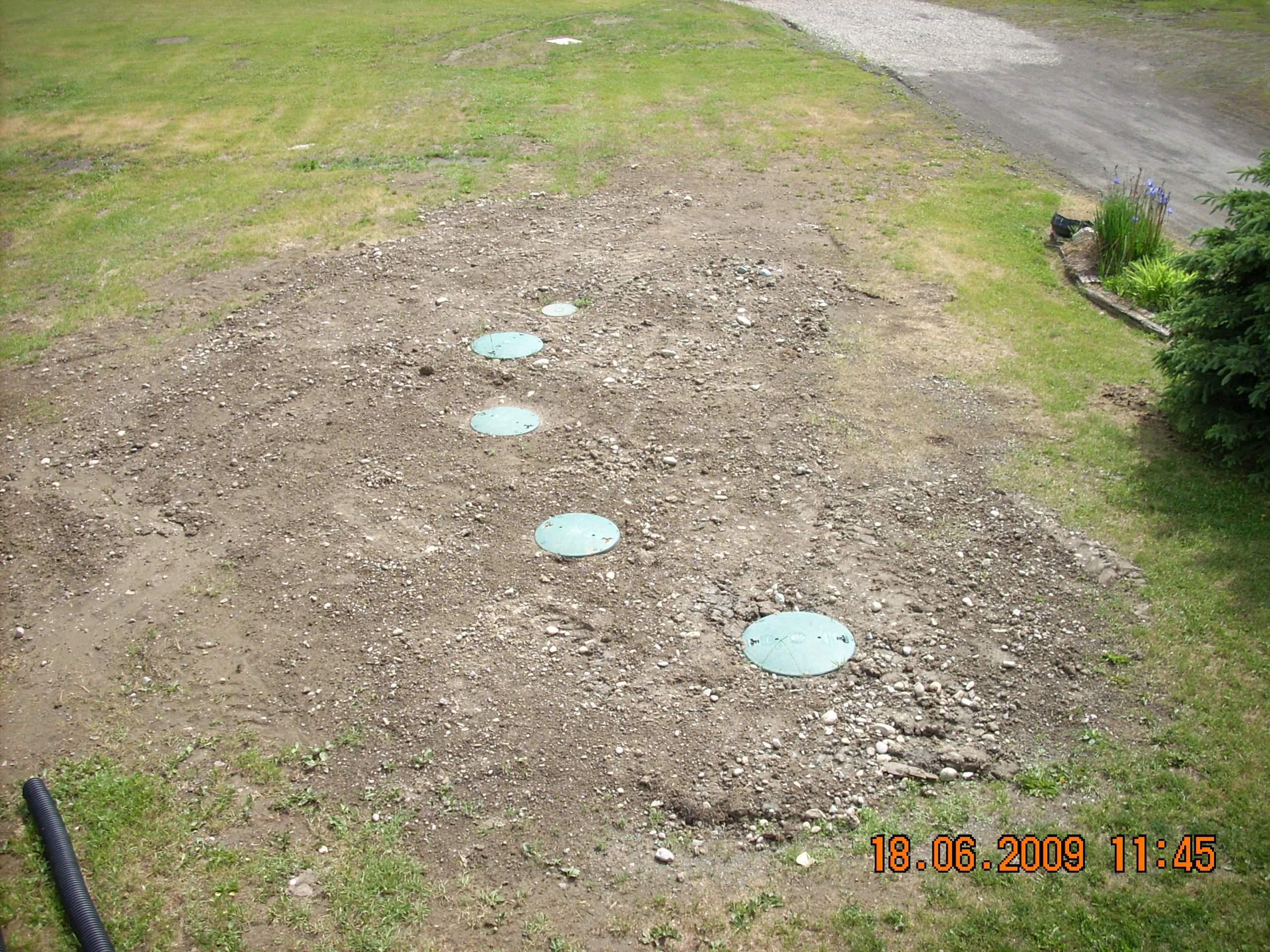

Jeff,
My system has two 500 gallon tanks connected in series, before the 300ft run to the septic lagoon. These are to hold the solids and sludge and prevent build up in the lagoon and to prevent pipe line plugging. I should mention that there is adequate slope to ensure proper daring of the main pipe. Some septic systems do discharge solids into the lagoon but they tend to be much older designs. The newer designs try to hold solids for collection (vacuum truck) and proper disposal.
Each tank has two openings and a riser is fitted to each opening - hence four riser lids.
