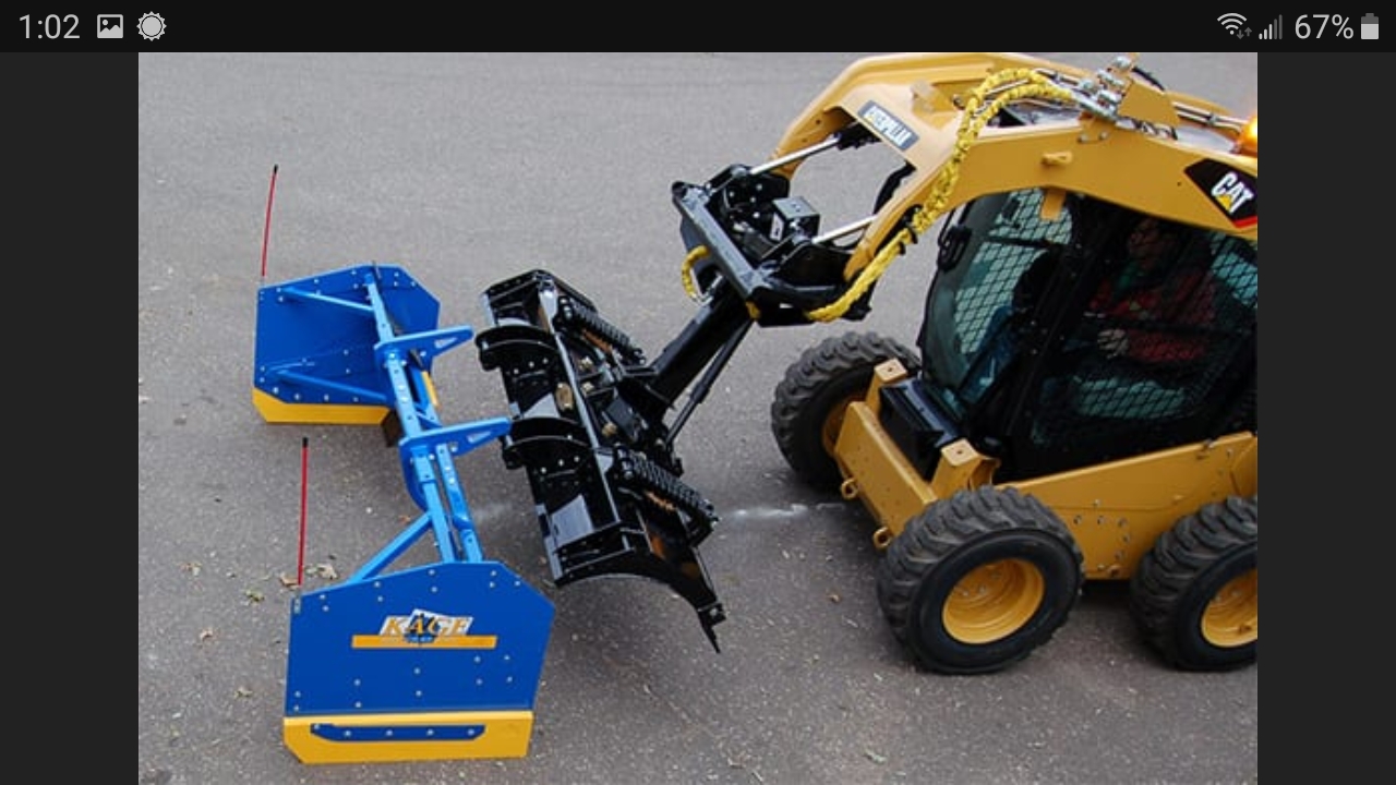

Rstod - There are several plows available (although at a very dear price] that are normal power angle plows that have the "sideplates" that will stand up connected to each other and you drive up and lower the plow into them and off you go.
YouTube the 2 I can think of.
Snow wolf or Kage. Pushers are amazing where you can use one. Then there's places where you just need to angle or winrow. A friend bought a Kage, 9-10' and iirc he spent around $8k. Definitely hard for a personal plower to spend.

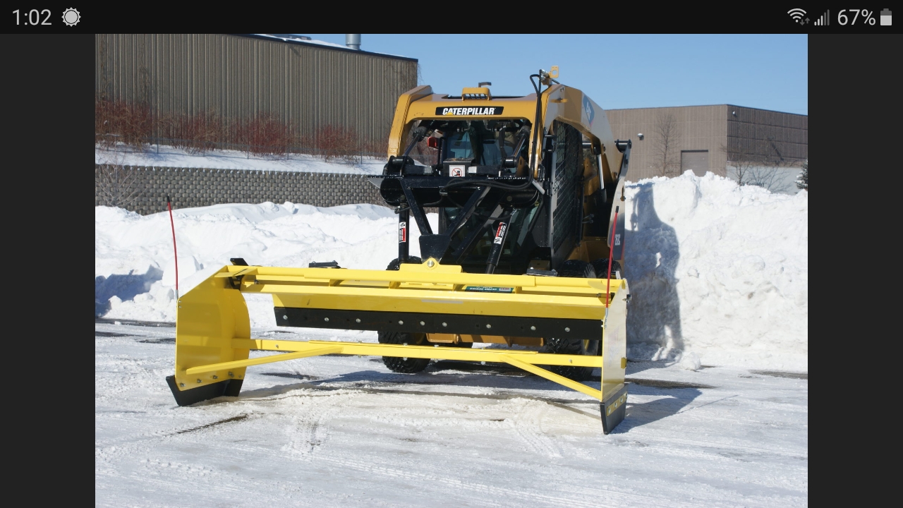

Screenshot_20210225-130215_DuckDuckGo.jpg Screenshot_20210225-130259_DuckDuckGo.jpg

That's the beauty of a hydraulic snow pusher. Hydraulically control the angle and the side plates or "wings." So you can simply push and pile up snow OR open a side and angle it like a plow. Very universal and handy. But also very expensive.
Something like this is what comes to mind: Kubota SSV75 with HLA snow pusher - YouTube
