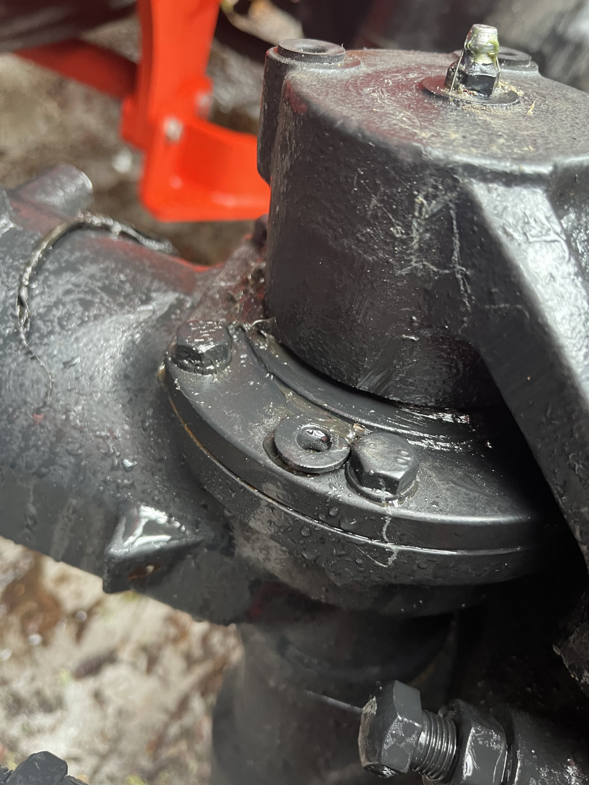

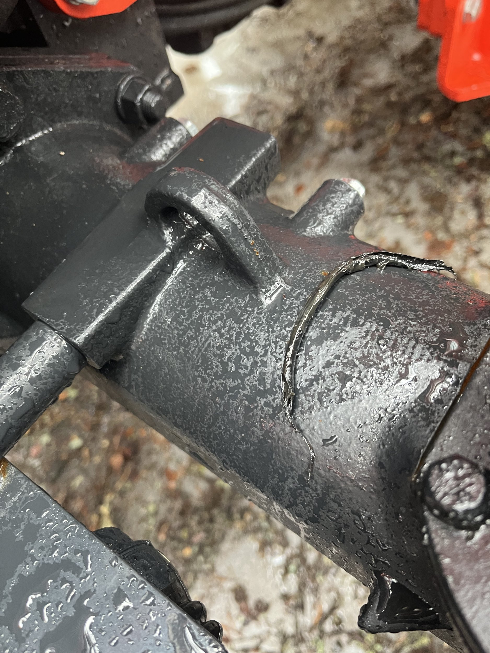

I was greasing my tractor today and noticed what looks like part of the axle seal laying on the axle. I dont really see what else it could be, I guess I must have pushed the seal out last time I greased it.
Have any of you ever replaced that seal? Is it a big job to do? Do you guys think I can still use the tractor without hurting anything?
FYI the tractor is still brand new and has about 30 hours on it.

Looks like grease to me, I didn’t see any seal material. You’ve probably just gave it too much. How many pumps did you give it? 2 or 3 pumps once/twice between oil changes is lots…unless it went under water.

Maybe I should have taken a better picture. Sorry for that, i know it may not look like it but believe me there is definitely a piece of rubber gasket that came out of it.

That almost looks like the O-ring was cut during assembly, then the grease just pushed the damaged part out.
It's possible to push the O-ring out by over pressurizing that grease zerk, but that usually just pushes the O-ring out.
On that part and the trunnions where the front axle pivots, it's important to not apply too much pressure when greasing or it will blow the O-rings out. Some tractors, usually bigger one, have a built in relief valve to prevent exactly that.
The purpose of the o-rings there is to keep water and dirt from getting in.
Personally, I see no point on really file a warranty claim for a couple cents worth of O-ring, specially in this situation that's easily fixable. The trunnions on the front axle pivot are a lot more work to fix.
All it should take is take that part off, put a new o-ring and assemble back together.
