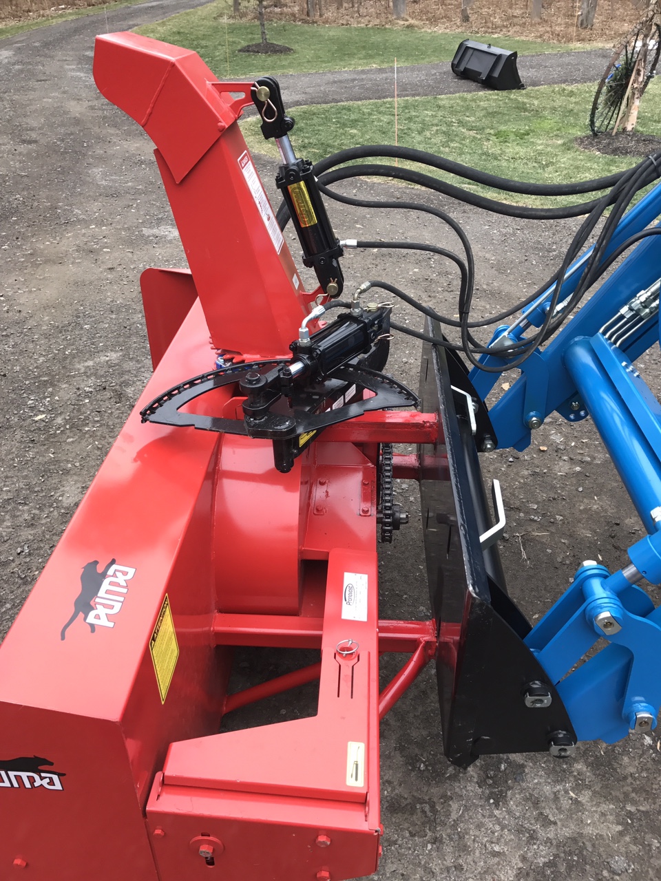

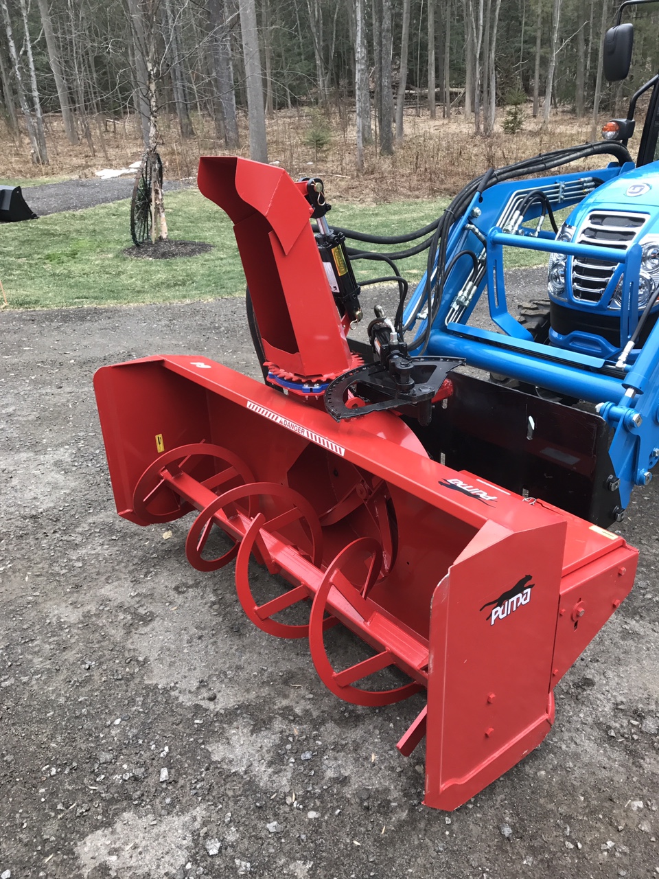

Dealer converted this Pronovost Puma rear mount to a loader mount. Works great.
PTO driven hydraulic pump and aux tank on 3pt.
