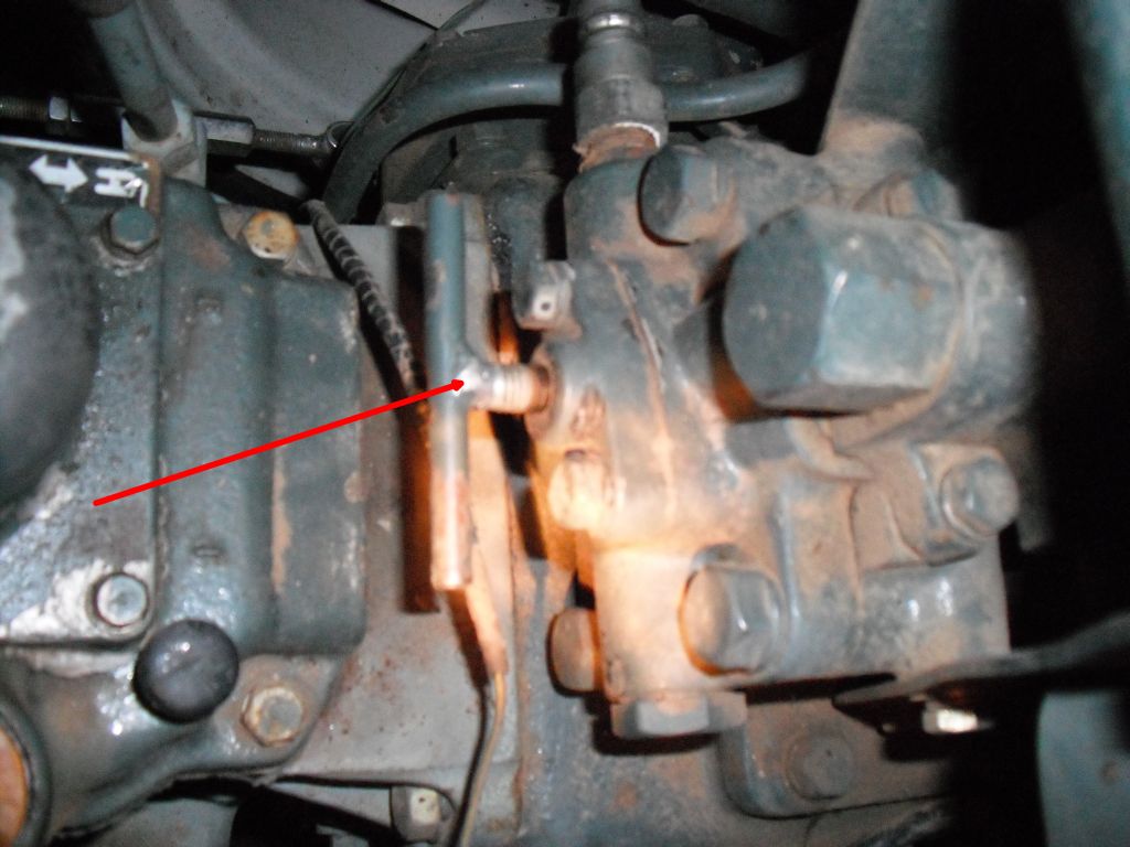

Thanks for the info. I thought the lever under the PTO might possibly be 4wd, but wasn't sure which position engaged the front. Hopefully somebody will give me an idea what to look at to fix the PTO. I will try to take some more pictures tomorrow.
I guess this is the 4wd lever?
Is this the valve that should be open for the three point hitch?
Thanks!

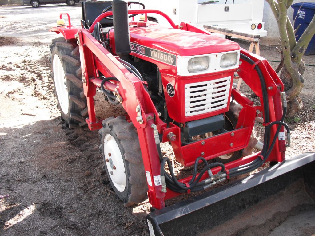

I guess I'll have to figure out how to add the pictures inline.

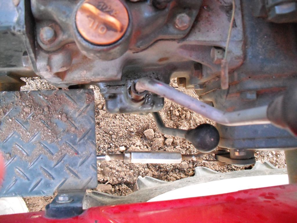

Also, regarding the PTO, The first picture shows the forwardmost position of the lever. In that positon, it will go up and down about 3/16", but will not turn forward more in either up or down position. The second shows the position to which the lever will turn freely. It can then be rotated to straight back, but feels like there is a slight drag like a detent or something to position it to the rearmost positon. Does this sound like there is an issue with the PTO shift forks, or is there a simpler problem that I am missing?

My mistake, front to rear, not up and down. If the lever moves front to rear but no gear change probably a broken pin inside, Shafts 41 & 43 should shift to change gears. The creeper notice looks to be a Vietnamese translation.

The 4wd lever moves rearward to engage the front axle. This is apparently backwards from some others. This is the second time I have seen someone get it wrong on the web.
First gear in the PTO is straight back. With the tach at about 2000 RPM the PTO speed is about 540 rpm, right for standard attachments. Second is forward and third is down and forward. Third is 1097 at 2200 rpm, apparently good for tillers.
I don't think the PTO moving while in neutral is a problem unless it rotates with a load.
