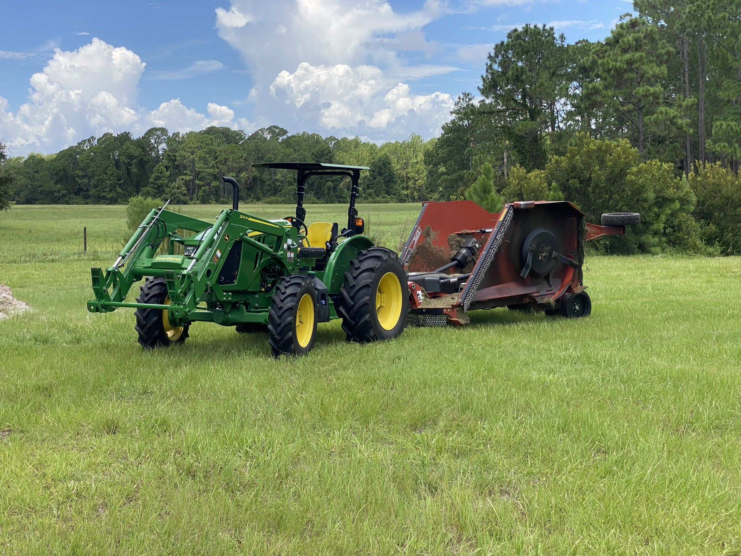

When I got home I immediately hooked up the Rhino 4150 15' batwing. This tractor has 85 pto hp compared to 64 on the 7060. I was a little worried it wouldn't be enough of a difference but it is a noticeable upgrade. I used to run 4-5 mph with the 70HP Kubota and would have to raise the height and/or take less than a full swath. I now run at 7.5mph and take a full swatch all the time which equates to mowing 11.3 ac/hr compared to 6.5-7 ac/hr. The tractor test data showed about 5 gph consumption and I would tend to agree based on my initial usage. I'm able to cover so much more ground I think total fuel usage will be about the same. I used to crank the Kubota up to 1800-2000 RPMs to turn on the PTO to keep the tractor from stalling. The Deere only needs to be at 1500 or so. I could probably use a lower RPM if the PTO control wasn't electronic. The old cable PTO lever allowed me to slowly feather the PTO on which helped with the shock to the drive line.

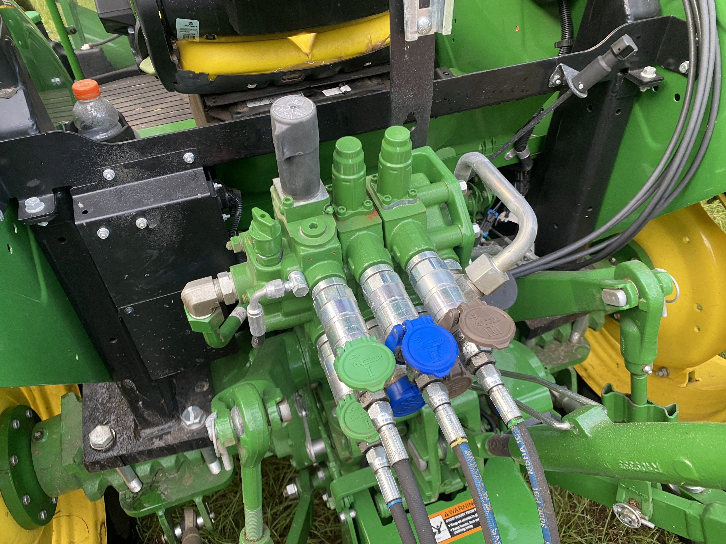

The three hydraulic remotes all allow float. The first remote has flow control as well which is nice. The remotes and handles are color coded which is very handy. The levers are a little stiff but the tractor is still new. It seems like these hydraulics work the batwing much easier (can raise and lower at the same speed regardless of tractor RPM). I have not used the loader much yet but it seems to be underrated. We have a skid steer that handles the heavy lifting and most loader work anyways.

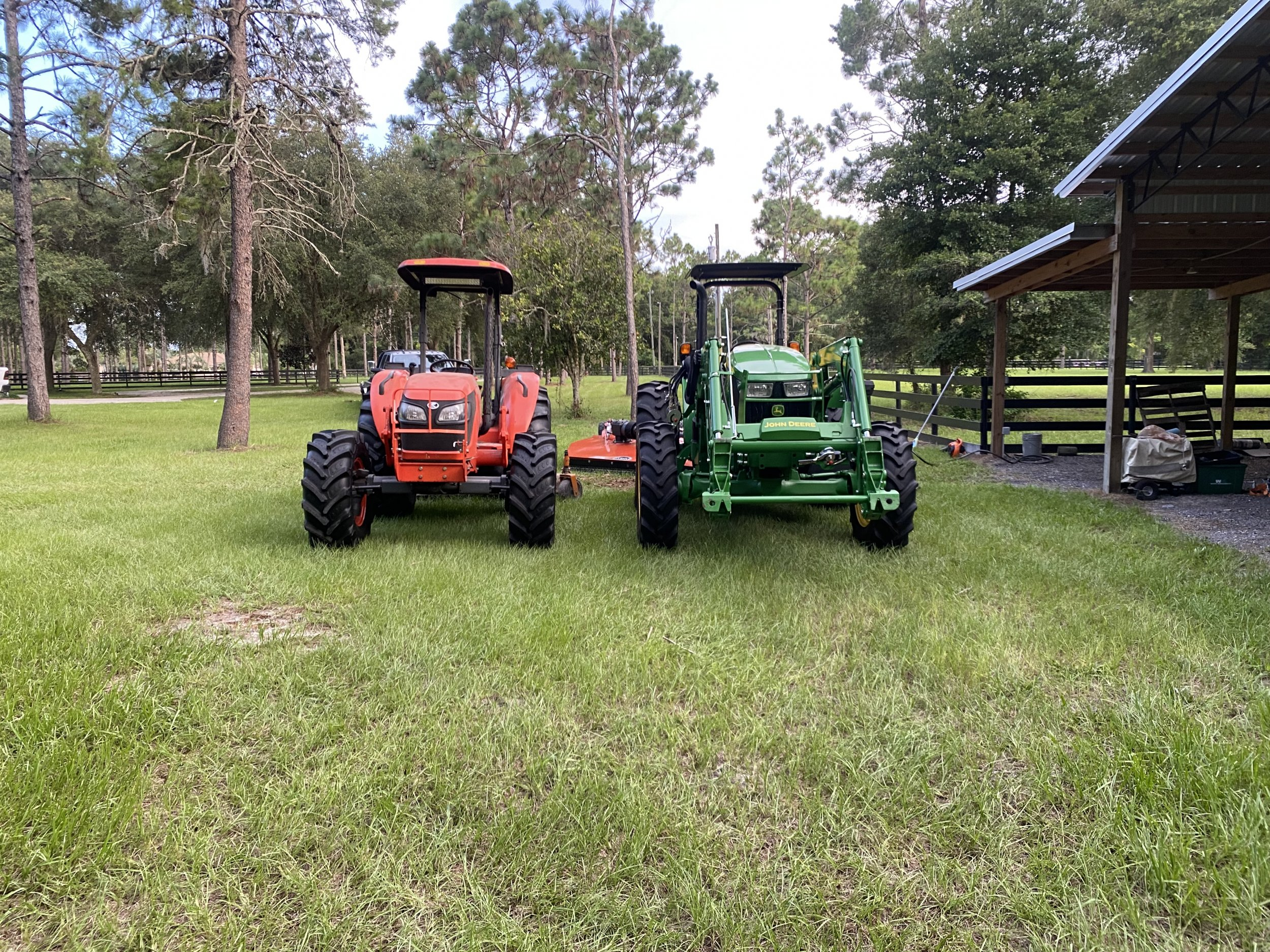

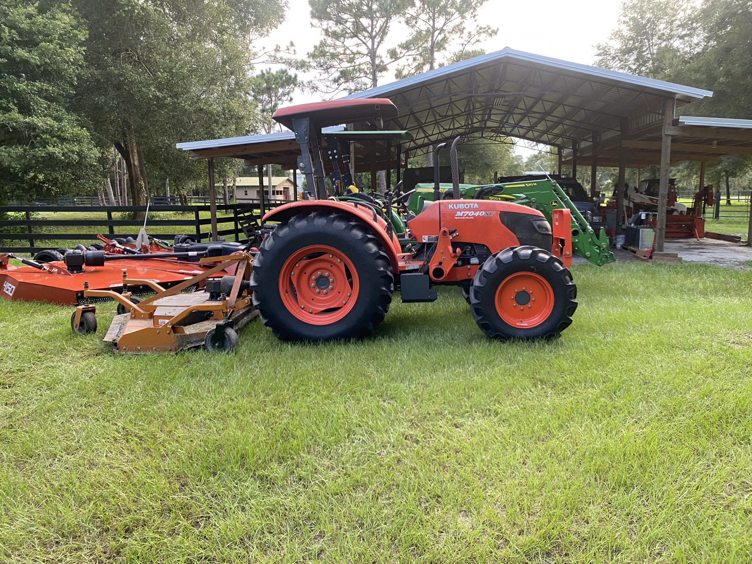

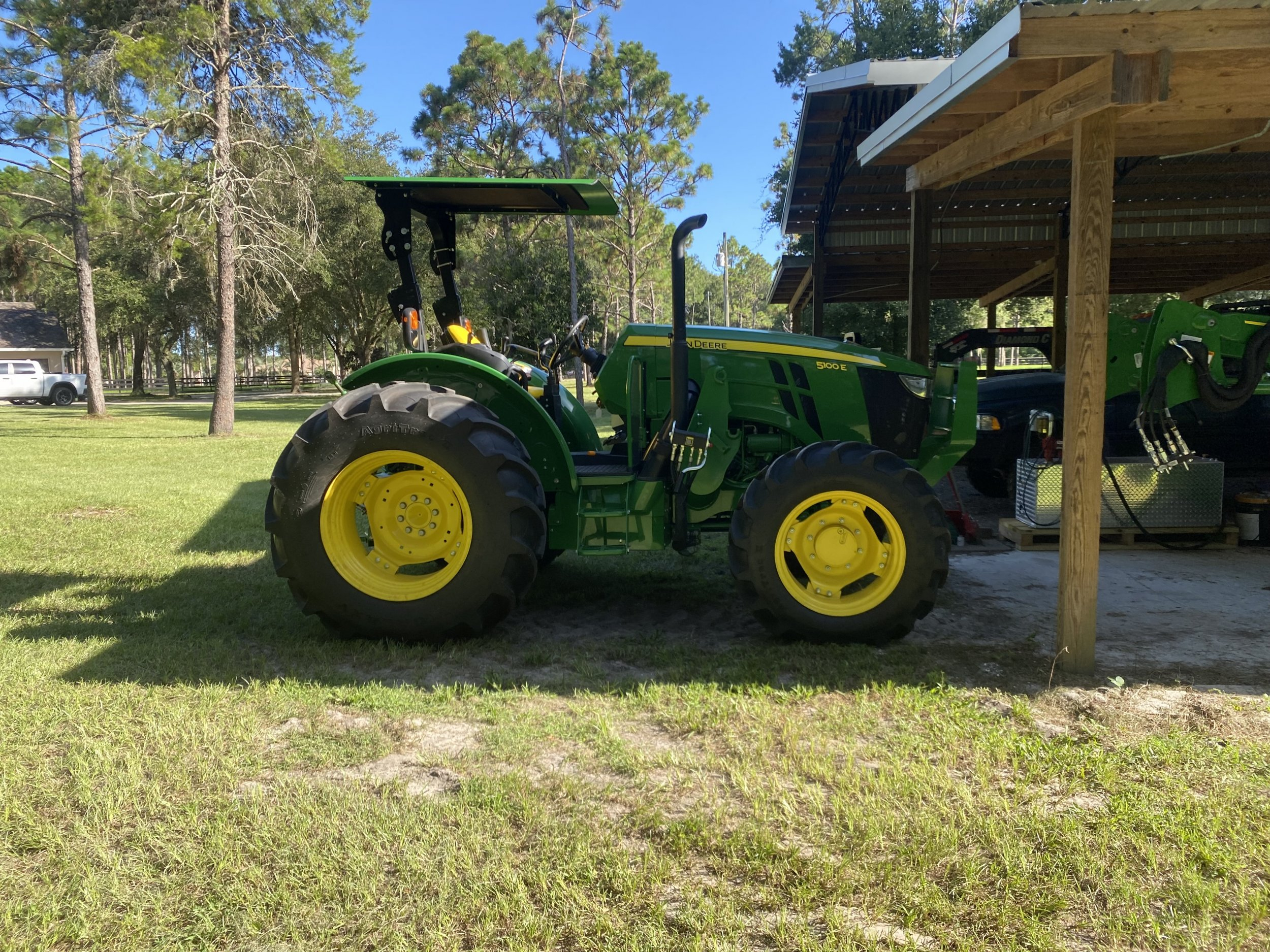

Here's some comparison shots of a Kubota 7040 and the 5100E. The Deere has its tires set all the way out. I wouldn't do this myself but it doesn't hurt besides having a little less room to manuever on the flatbed which is 8'6". The canopy on the Kubota is smaller and set much higher above the seat. As a result, I got caught out in the rain on the Deere and noticed I was able to stay dry much easier than in the Kubota (which means better shade too!).

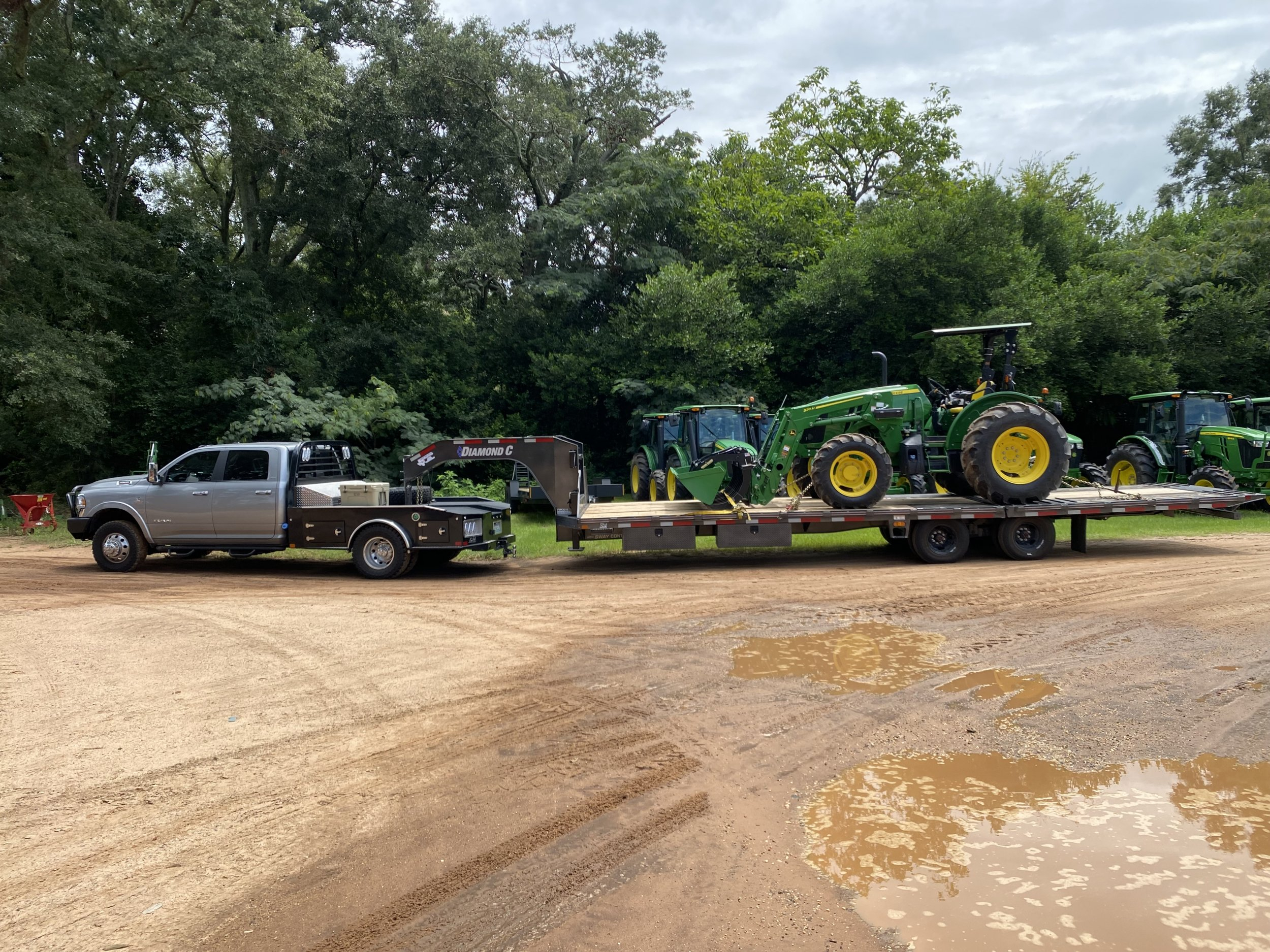

Hauling the tractor home I was surpised by the weight - 31,620 lbs! My truck weighed 9,500 brand new. I've added a toolbox, tools, supplies, cooler, spare tire and there were two men and two children in the truck. I figure ~11,000lbs. The trailer has an empty weight rating of 7,410lbs but I have not verified it. That puts me at ~18,500 lbs which leaves 13,120 lbs for the tractor. Deere rates the tractor as 7,275 for open station. Add a loader for ~1,000 lbs, grapple 800 lbs, rear tires filled 1,500 lbs - Total of 10,575. I have a couple hundred pounds of chains, straps and binders in the trailer. I'm guessing the trailer is quite a bit heavier than the sticker implies. Diamond C has started weighing every trailer to get an exact number for the sticker but I don't know if this happened with my trailer.

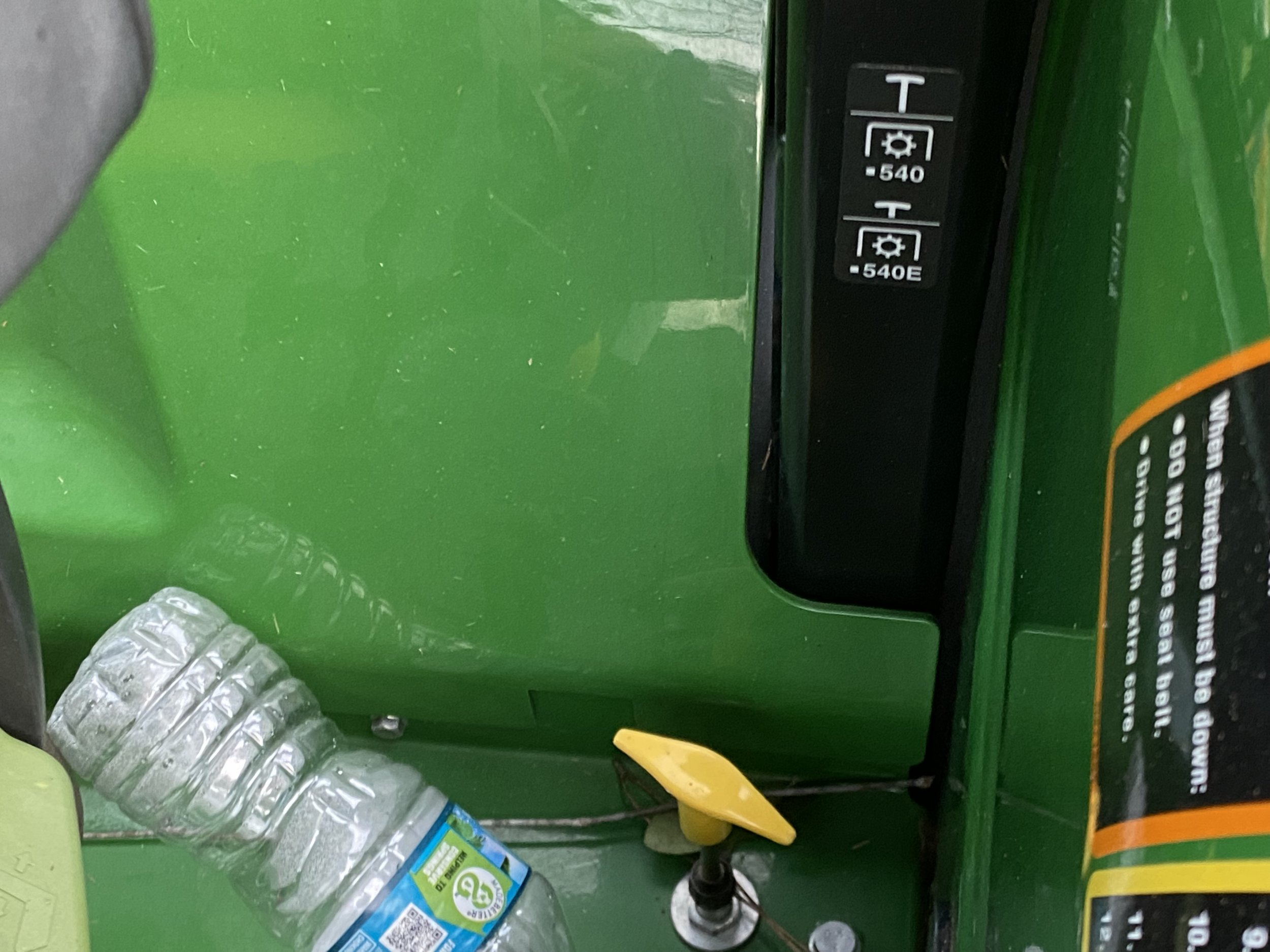

I have that same tractor in a cab model. What you describe is economy PTO. Mine runs 540 RPM at around 1700 RPM engine speed. The PTO is selctable. I run mine in EPTO all the time and pull a 20' Frontier finish mower. In B range, 3rd gear mine uses 2 GPH. You can get the bluetooth adapter for it that pulls data up in an app on your phone. It costs 100 bucks and is worth every penny. It gives you the engine load and more importantly the soot load level. They regen at 100% soot load level n o matter the hours. These tractors are a beast and I'm sure you will enjoy running it.

Thanks! I referred to the economy PTO an overdrive of the PTO. I don't believe its recommended for heavier implements like our batwing. I would use it running my finish mower or a post auger etc.

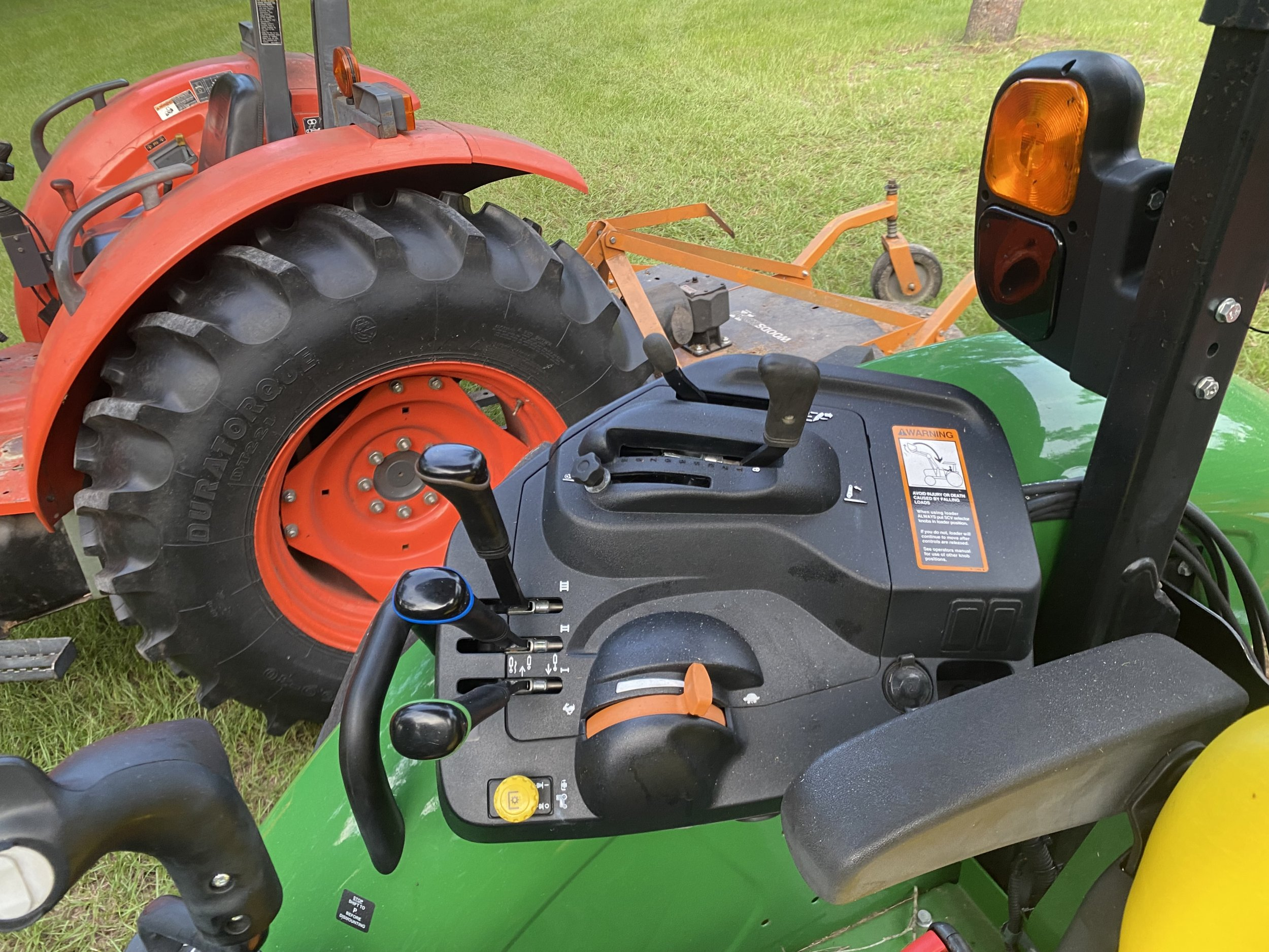

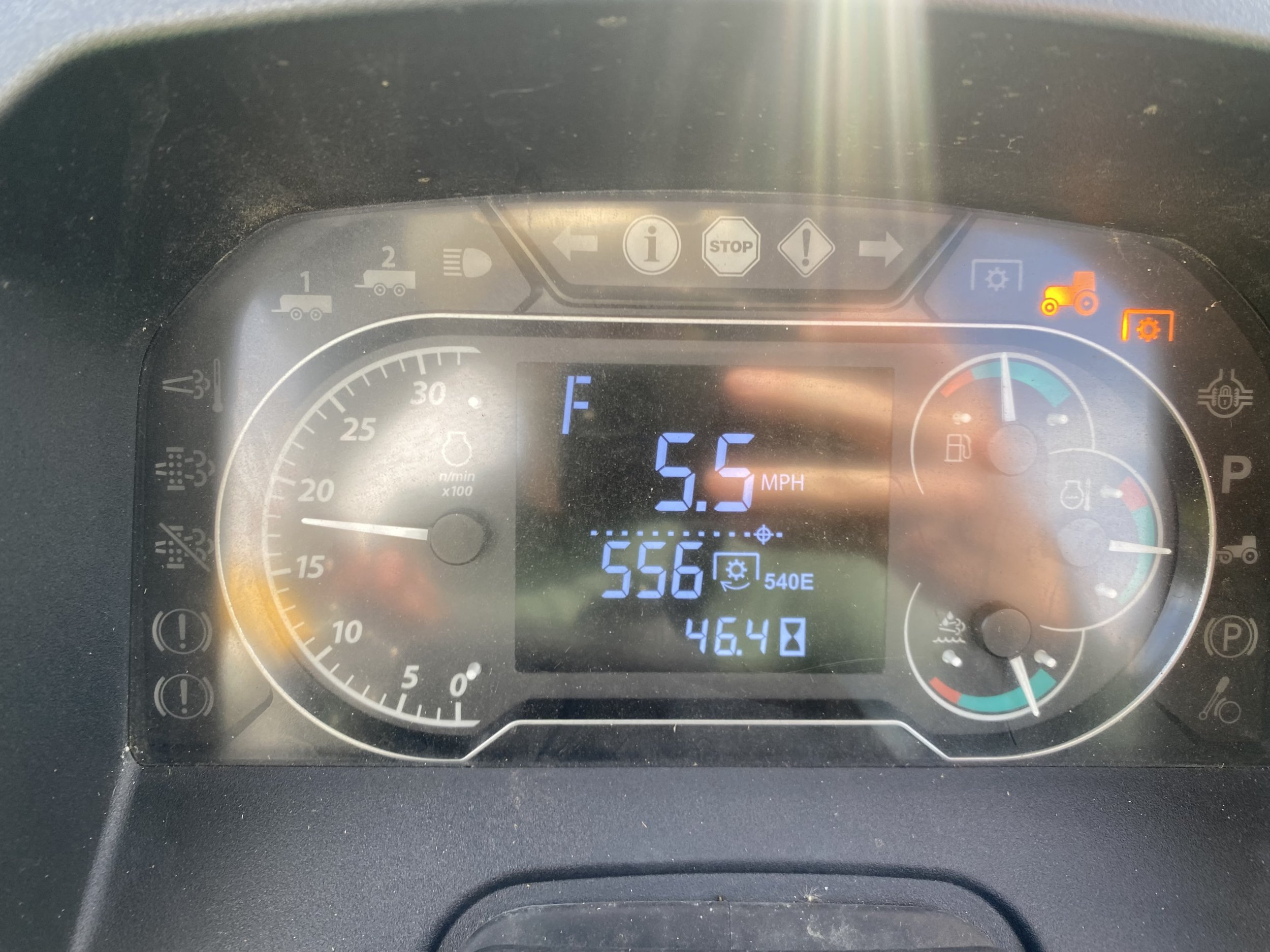

The transmission is a 12F/12R PowrReverser. It has three ranges and 4 speeds. Range A is a crawl and Range C is pretty much road speed only. Running 540 RPM PTO speed is 4.0 mph in B2, 5.5 mph in B3, and 7.5 in B4. If I use the PTO overdrive (PTO E), B5 drops to about 5 mph since its only ~1700 rpms. The dash is very clear and informative. The electric hand throttle makes it easy to fine tune your PTO speed.
View attachment 755736View attachment 755742

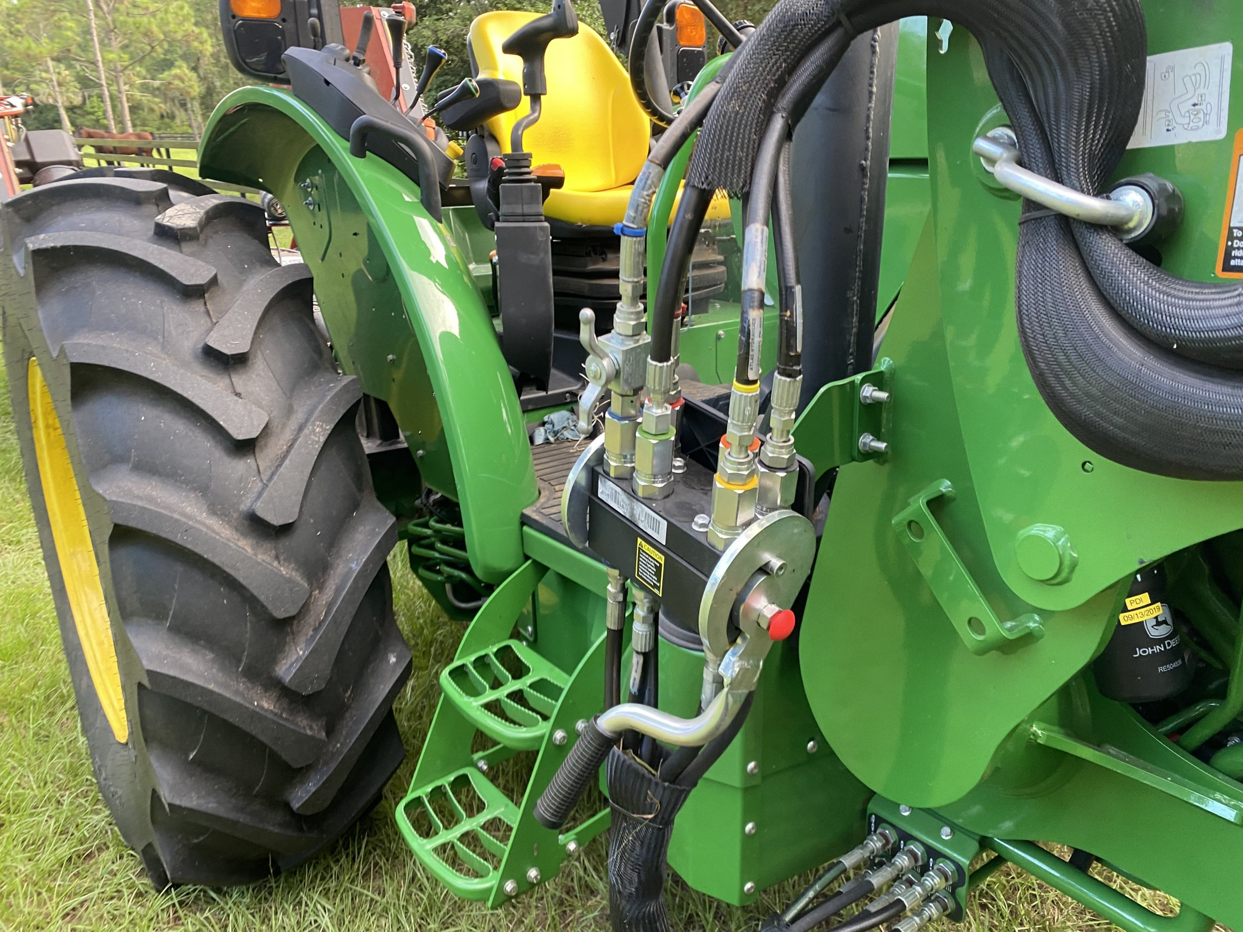

The three hydraulic remotes all allow float. The first remote has flow control as well which is nice. The remotes and handles are color coded which is nice. The levers are a little stiff but the tractor is still new. It seems like these hydraulics work the batwing much easier (can raise and lower at the same speed regardless of tractor RPM). I have not used the load much yet but it seems to be underrated. We have a skid steer that handles the heavy lifting and most loader work anyways.

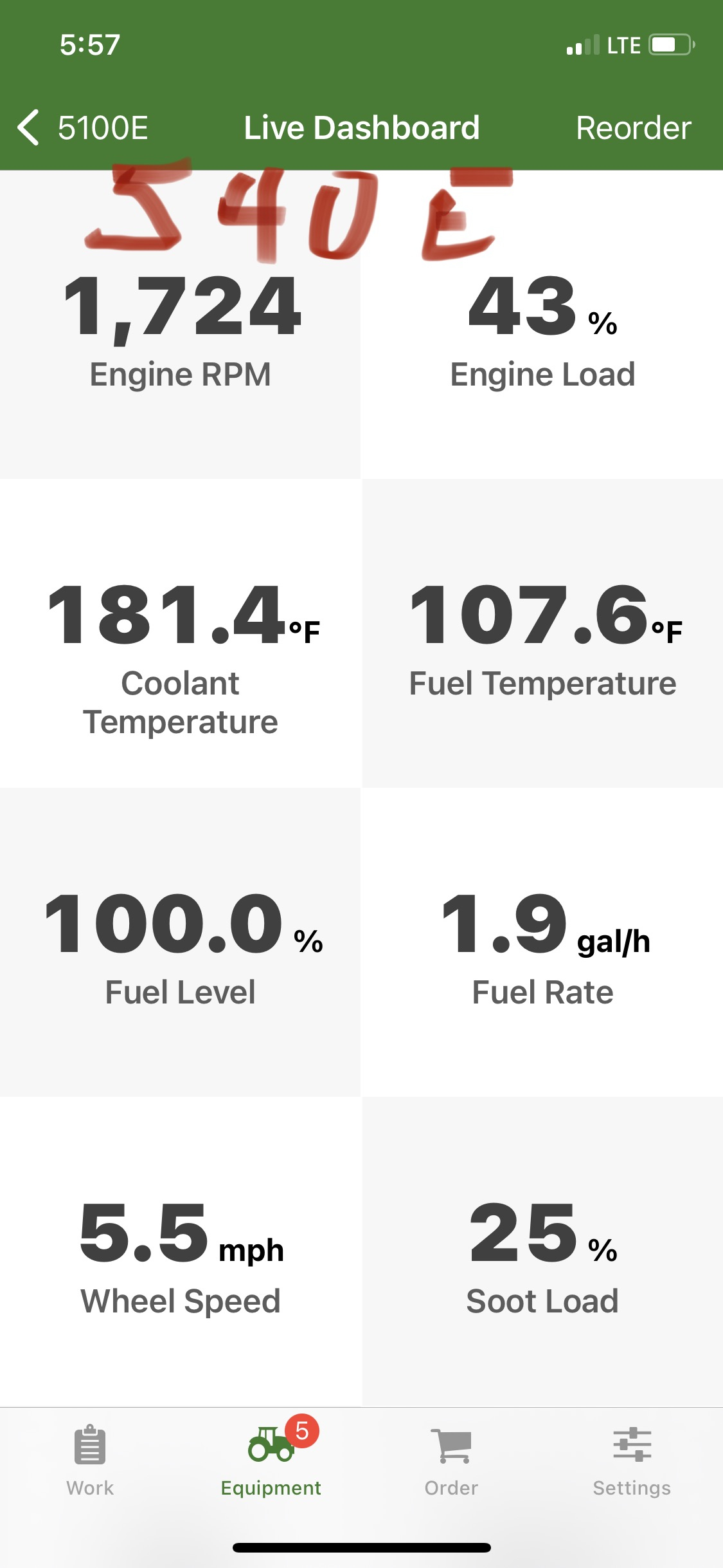

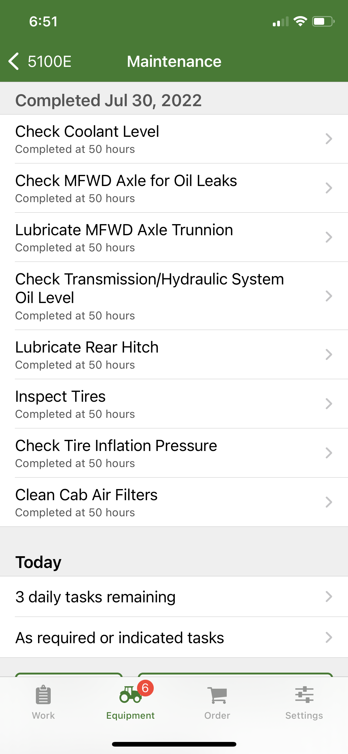

I got that bluetooth from John deere installed this weekend. That thing is awesome! The live dashboard is pretty cool with all of the live data about the tractor. I also really like how the owners manual and maintenance schedule are all on there as well. It is handy to be able to see all active and inactive codes.

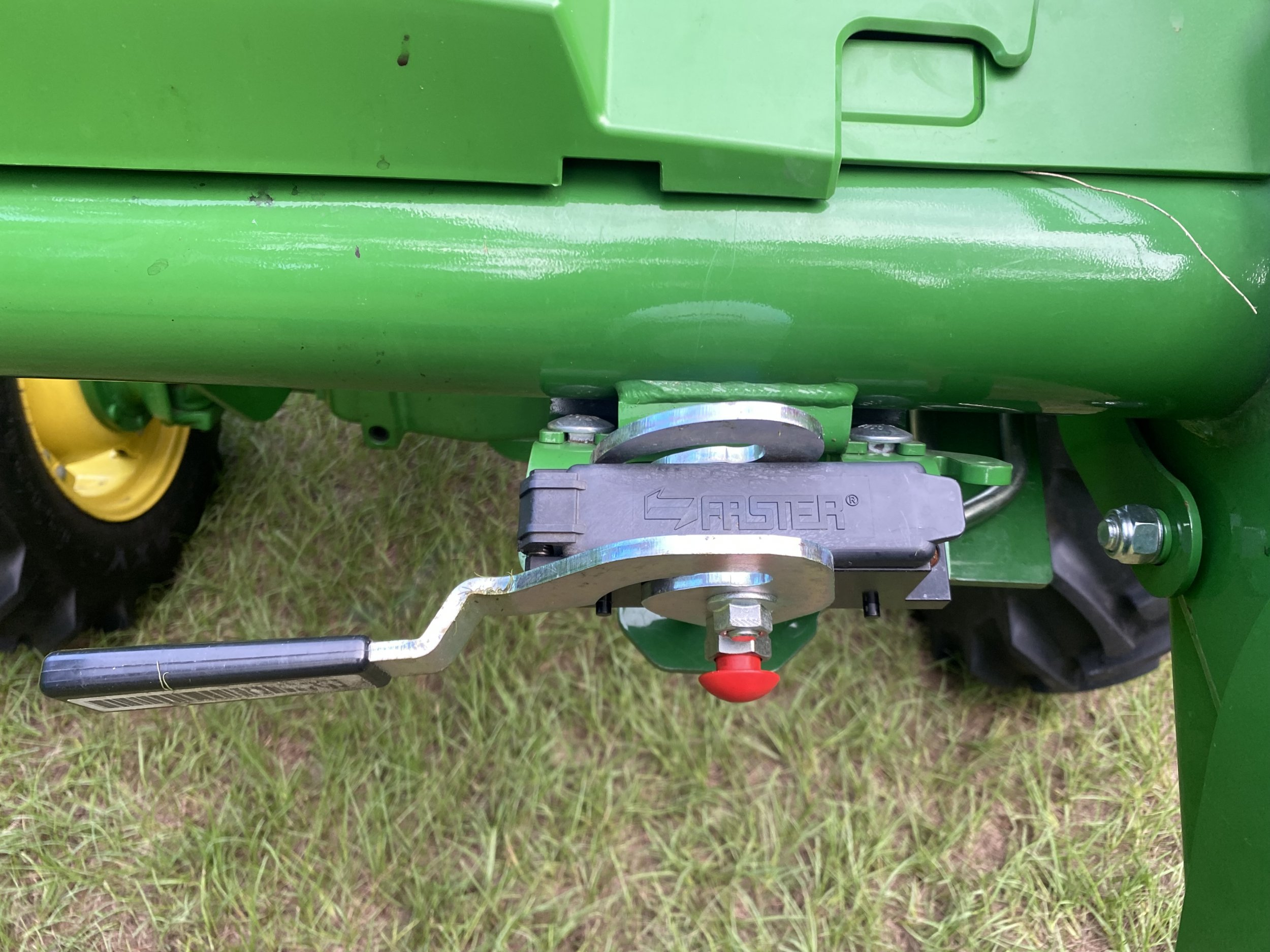

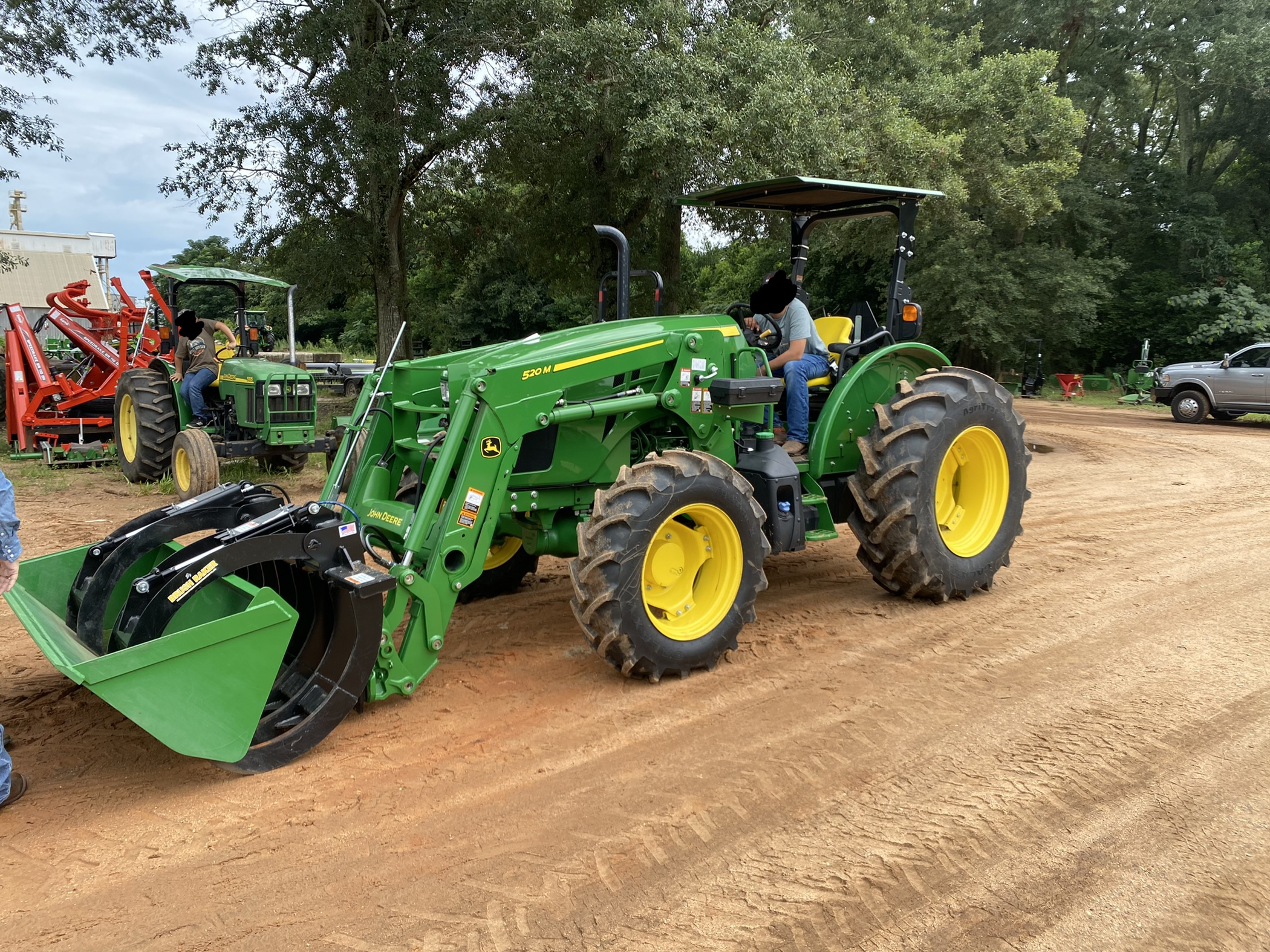

I also took the loader off to do some mowing with the finish mower. The 520M comes off pretty easily. I really like the stands for the loader - much more stout and stable than the Kubota stands. That multi coupler makes this a real breeze. I like to take the loader off when mowing to increase maneuverability and decrease my ground pressure a bit. I was surprised that even with the loader on the tractor I can turn as tight as possible and it does not make ruts. These tires are bias ply but are 12" wide so they're not as bad as the 9.5 pizza cutters that came on my Kubota 7040. Adding the 14" radial tire package from Miller tire was one of the best things I have ever done to my 7040.
