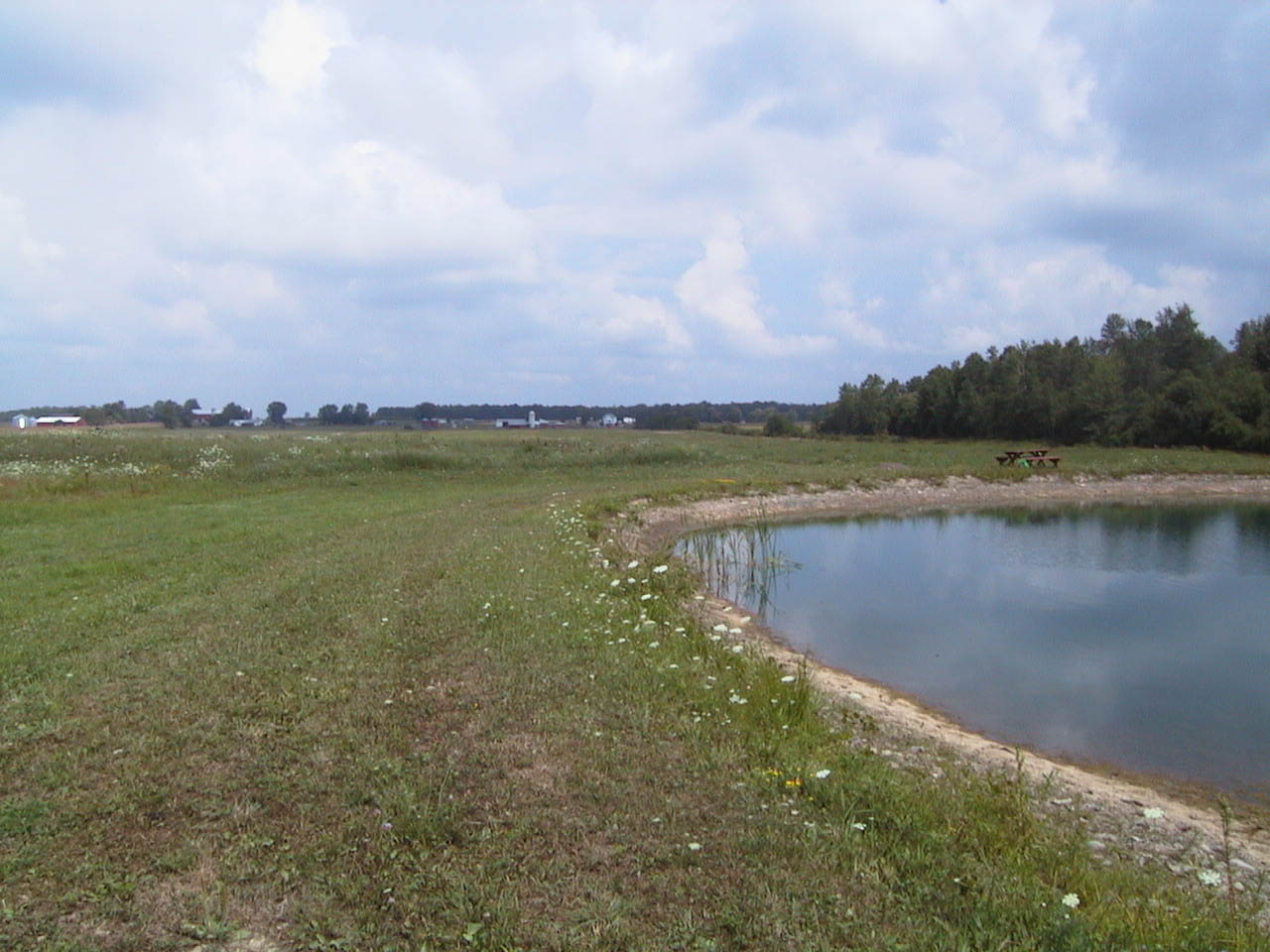

All,
I'll try to keep this as short as possible, and THANKS in advance for any help...usual disclaimers apply (been lurking for a few months, reading posts, ready to buy tractor at this point, suburbanite moving to the country w/minimal tractor experience, etc..etc..).
The specifics: Moving to hobby farm, 90 acres in Rochester, NY area November 1. 60 acres of flat Fields currently rented to local farmers plus 15 acres woods plus 15 acres pasture with 2 ponds. My wife and I most interested in tree farming, with the intent of converting the fields back to forest over time and eventually running a nursery there (We're both 8-to-5'ers right now). We'll need the tractor for the following: Snow plowing, tilling, moving dirt, spading trees, chipping/splitting wood, skidding logs, mowing lawn, digging/grading and possibly for sowing/spraying as well (down the road a bit). We'd like the tractor to be able to handle these chores easily, and also would like an enclosed Cab (it gets both very cold and very hot here, plus wife allergic to bees). Initial implements would most likely be an FEL and box scraper with a rear-PTO-driven mower in the spring.
This leads me to the Grand L Ten series L3710, L4310 and L4610 as well as the M4900, M5700. And this is where I need some help, because my ignorance begins to show. Here's what I know are the MAJOR differences between the L- and M-series:
L-series is compact tractor equipped with Cat I 3-point hitch.
M-Series is utility/ag tractor equipped with Cat I/II 3-point hitch.
What implements will work only on Cat II hitches? Is it matter of size only, or are there entire classes of implements that won't work on a Cat I hitch that I may eventually need? In particular I'm worried about a discing implement and a tree spade, along with the big "batwing" mowers. Hopefully someone with experience will know something...

Well, I'm sure going to be watching this post in next few days! Sounds like you and I are at same point in decision making with same models in consideration. Of course, I wouldn't know what to do with all that flat land you show there. Must be nice.
