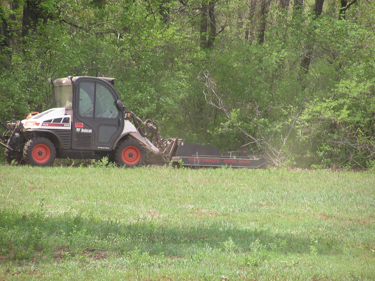

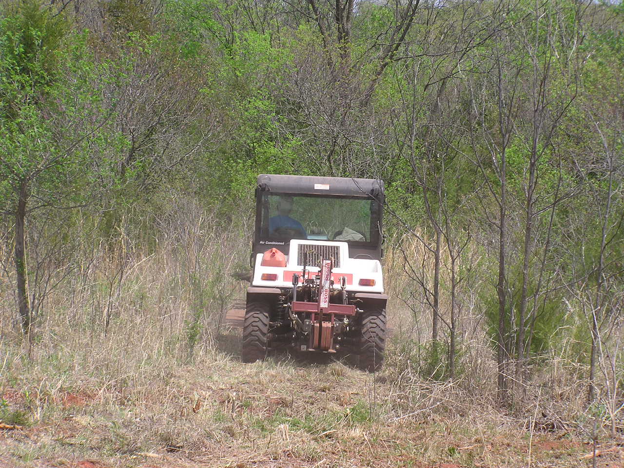

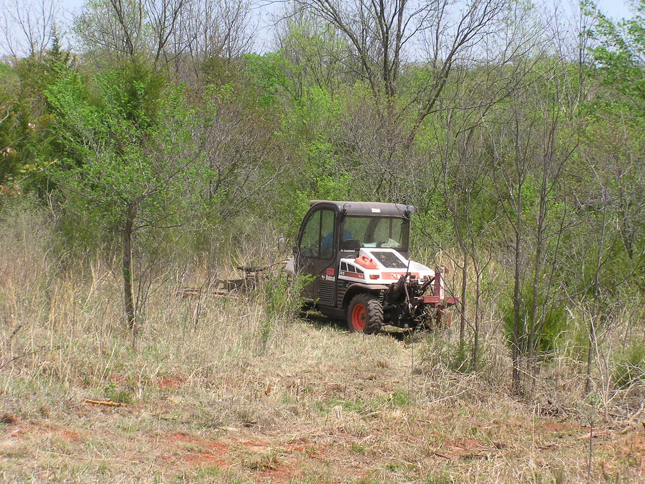

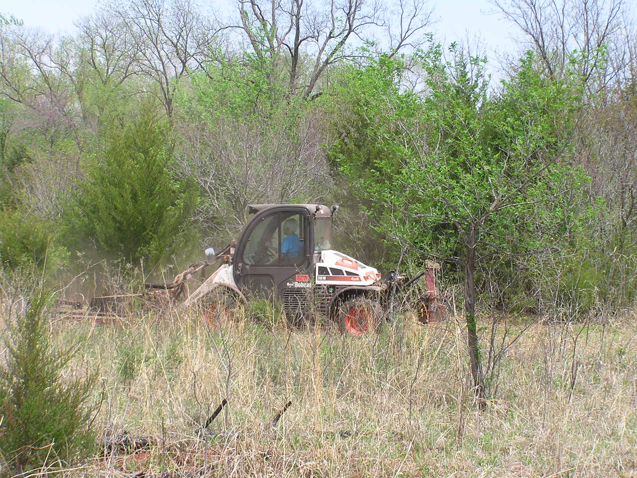

No punctures in the R4's on the Toolcat and my wife runs over everything she cuts with the 7' brush hog! :laughing:
