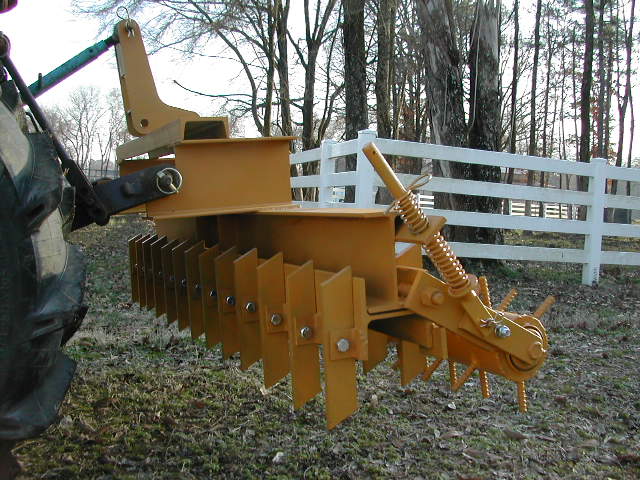

I'm about half way done building a pulverizer (more time than money) and I need 2 compression springs. Anyone here know a source for these? All I can seem to find are the little ones that are in hardware stores. The tractor dealers want to sell me a replacement part-- way too much money. Thanks for any replies. Billy

old motorcycle shocks with the springs on the outside??

Haven't thought of that! Those should work- I'll check out the local bike shop today. Thanks.
   / pulverizer springs #4
When I built my pulverizer I bought my springs at TSC (Tractor Supply).

Looks like a pretty strong one. Any idea how much it weighs?Any thing that you would do different that I should know about? Thanks, Billy

I have know idea how much it weighs to be honest. Things I would do different? Given what materials I had to worth with, I really can't think of anything. When I build something like this I usually do it with the least expense I can. I want to build a piece that is well built but I don't want to spend a ton of money on it either. There is one weak link that could have been built better had I the parts on hand. The bearings on the roller are from the gauge wheels of a grey market tiller. They aren't as durable as pillow blocks would have been, but that is what I had on hand. I did drill a hole and mount grease fittings in the bearing housing. To help prevent damage I make wide sweeping turns or raise it up to make a sharp turn. Other than the expense part when I build something from what I have on hand it is kind of like my very own "Junkyard Wars". One thing that is different about mine is that the spikes on the roller are about twice as long as those on a store bought one.

If you will click Pulverizer Discussion you will see part of the building process and at the end you will see pictures of where I ran it through some hard clay.
