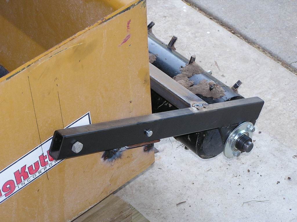

Completed a long overdue project yesterday.

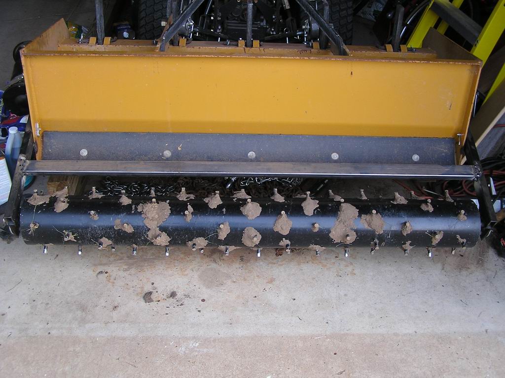

A while back, I purchased a surplus five foot pulverizer roller. Rather than waiting til I could build the "proper" pulverizer, I added the roller to the rear of my box blade.
Since I usually have the BB attached as ballast for FEL dirt work, having the roller there seemed to me to make sense.

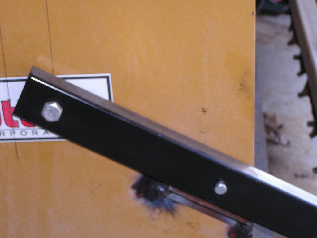

Yesterday, I moved 15 tons of dirt around a pool for a customer. The roller worked GREAT in several respects-- It helped pack down the loose topsoil and smooth it. An added benefit is it became an instant gage wheel--I have it set so the blade remains about 4" off the ground when the roller is down, so on high spots, the blade engages and helps to level the soil. (By drilling more holes, I could adjust the blade height).
Since this roller is HEAVY, I need to add a winch or actuator or something so I can lift it. I am able to pivot the roller up so it is out of the way when I don't need it.

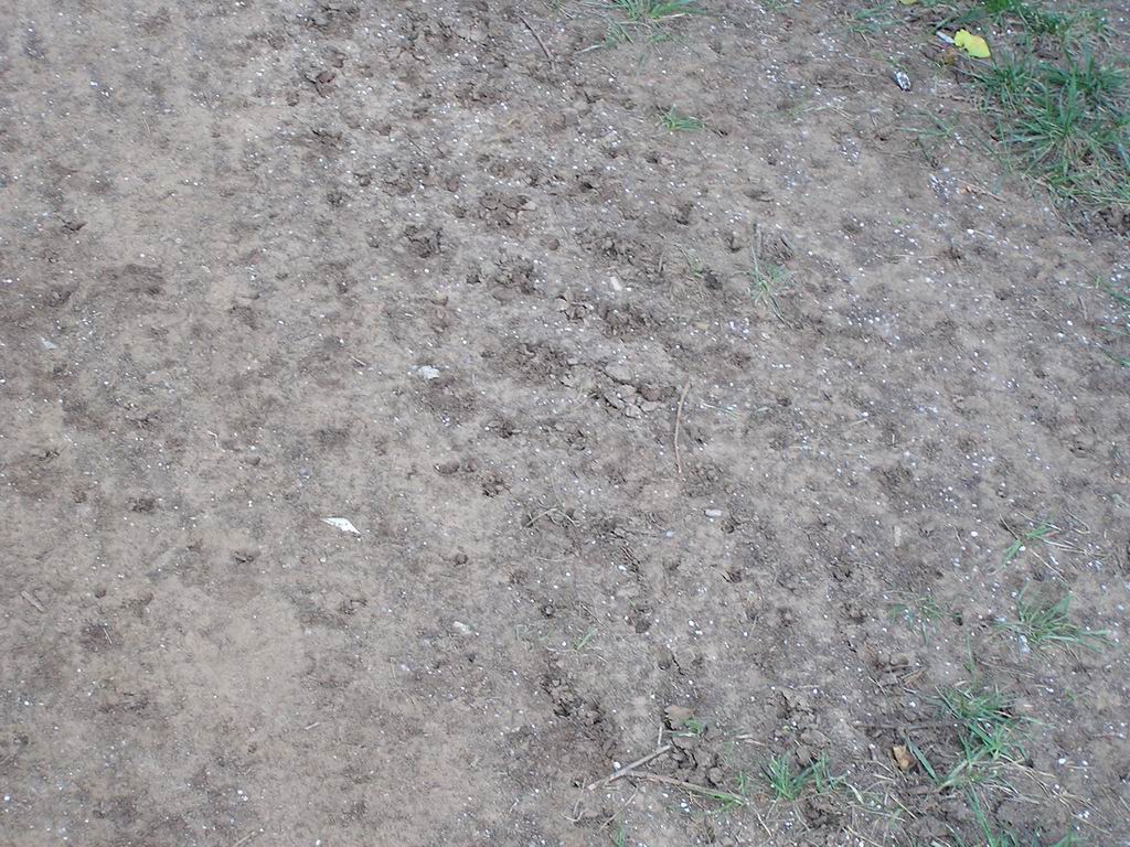

Our soil is hard packed clay, but you can see from the ground pic that it easily penetrates it. It made very nice work of the fresh topsoil at the jobsite. The pic was after two passes in my clay.
For those that want to know:

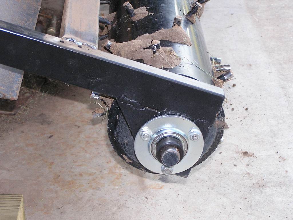

The arms are 1x2" box, the plate where the bearings mount are 1/4". I don't have a plasma torch, and frankly, worried most about cutting the bearing big hole. I bought a metal cutting 2.25" hole saw, and using lots of oil, was able to cut it fairly easily in my drill press.
I added the 1x2" cross piece for strength and a place to mount a lifting point. I started to make this piece removeable, but alas, grew tired, and just welded it in.

So is the intent that it "float" behind the BB... or that its pinned to the BB unable to move up and down so as to add the addtional weight of the BB to its down force?
   / Pulverizer Roller added to Box Blade
Pinned, to add weight, but more importantly to keep the BB from digging in.

A quick way to raise it would be to raise the BB, and put a piece of 4x4 or 6x6 under the roller, and drop the BB back down. If you add some upper stops like you have on the bottom, the holes to pin it up would always line up.

A suggestion for raising it: at each site on the pivot point, weld a bar (at 90 degrees) 2-3 times the length of the bar. Somewhere above the BB, connect the two levers together.
Here's a crude diagram showing what I'm trying to say.

The pins are 1/2" diameter. They are maybe 3/8's with a hardened case over each pin. The pins are 1" long. If you look at the Woods/Gill or Landpride pulverizer, that should give you a description of the roller. For our clay, I think 3/4" pins would have more trouble penetrating.
The roller is about 7" in diameter and is at least 3/8" wall, maybe 1/2". It is HEAVY. I think it is hollow. When we've moved it, my son and I used about 75% of our strength, and we're both big guys! We wouldn't want to carry it very far either!
I suspect I will mount a winch with steel cable to raise it. If I have it straight up or flopped over center against the 3PH frame, it is out of the way. I just want to have a SAFE way to lower it. I have a small electric actuator that I might mount, but it won't take it to the top center; it would allow easy adjustments once lowered though.
Thks for the idea on the arms, but if I did that, I couldn't fold it all the way up against the 3PH frame.
Ron
