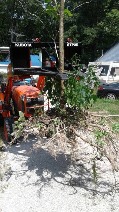

I like the Danuser Intimidator. Thought it would be too much for Kubota B2650, went with Kubota STP25. Brush under 3/4", usually snaps it off. 1-2" FEL usually pulls it. 3" brush/trees, often have to be in 4wd and drive forward while pulling. Sometimes have to release tree and try from different angle. Rocking is a bad idea tree puller clamps tight enogh for rear axle to come off the ground. 4+" usually requires chainsaw or digging equipment.

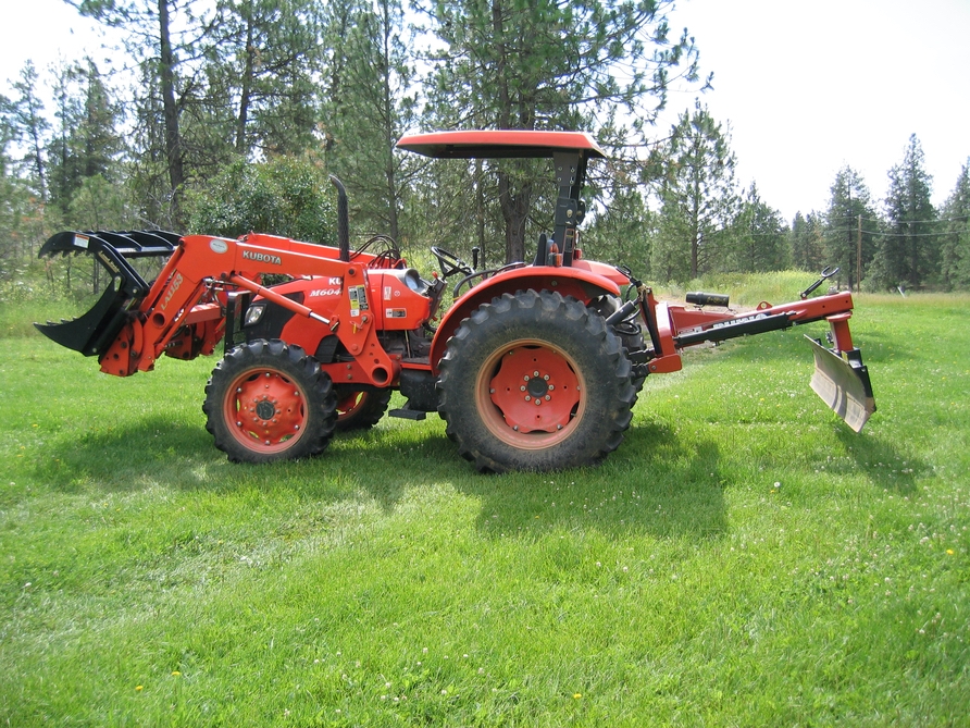

I have a Kubota M6040. RimGurard in the rear tires - 900 pound rear blade - 820 pound grapple on the FEL. All tolled - the tractor weighs 10,000 pounds. One of my projects - removal of a lot of the patches of Buck brush.
Drive into the Buck brush - grapple down low - reach forward and grab as much brush as possible. Clamp - lift slightly - back up. Many times I pull so hard - all four wheels end up digging.
YES - I PULL with my FEL. Buck brush is low - 3 feet, max height - about as big around as your yellow pencil - thick as hair on a hound dog. I remove the brush this way because I don't have a PTO driven bush hog.
