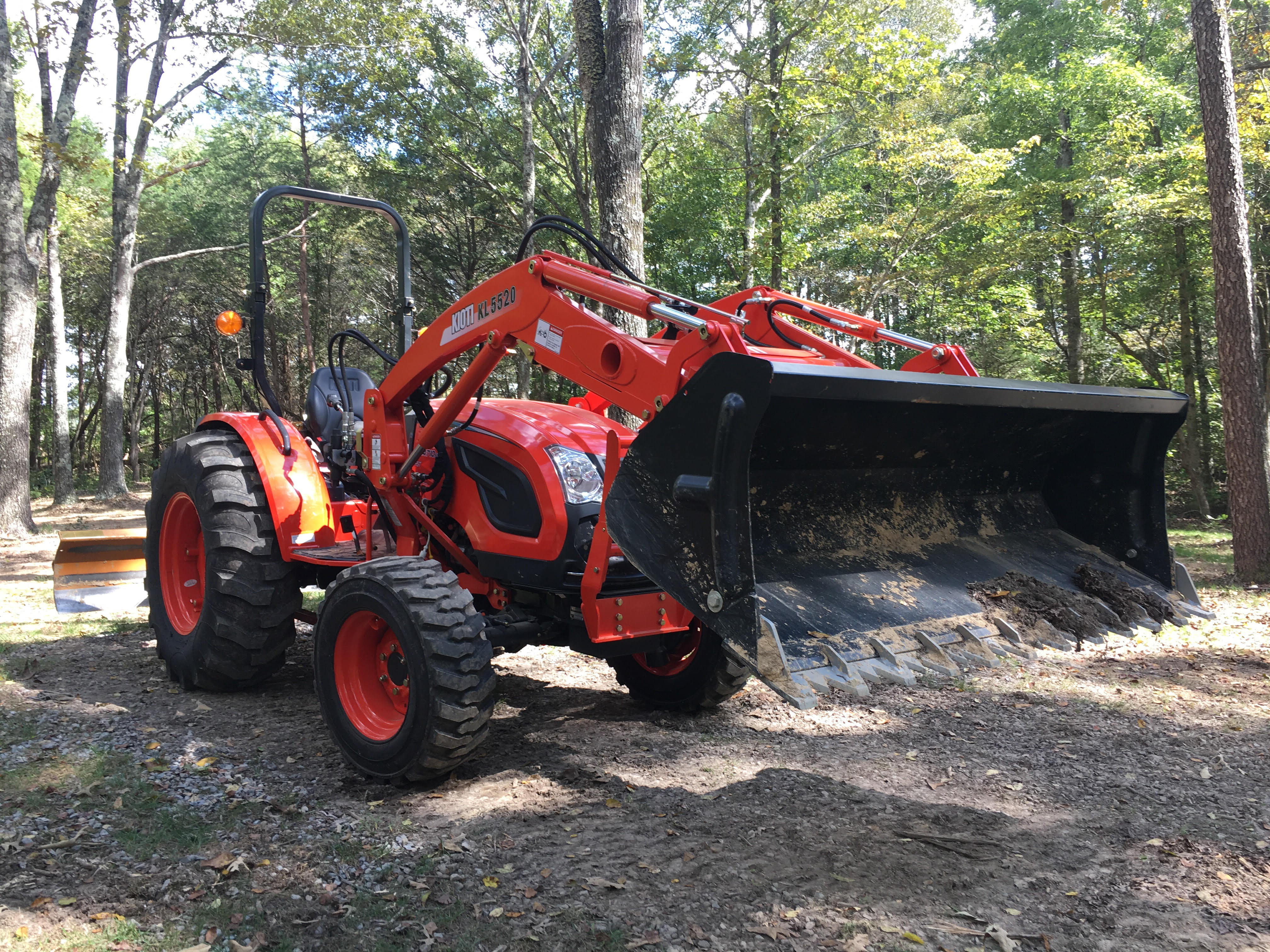

Hey guys, I am pulling the trigger this week after considering this purchase for well over a year. Technically the two tractors are the same brand(which I will not put in the OP cause I dont wanna break the rules:laughing:), but I am posting in this forum because my primary question is in regard to the differences in the two tractors as they will affect the type of work I intend to do.
This is a link to a previous thread which describes in depth the work and the property.
30 Acres and 20 years
Description of the two tractors A vs B:
Engine: 45 HP vs 50 HP
PTO: 34 HP vs 42 HP
Hyd. Flow: Both 16.5
Width: 63" vs 66"
Turn Radius: 8.6 ft vs 10 ft
Length: 125" vs 140"
Weight: 3500lb vs 4000lb
Lift Cap: 2700lb vs 3200lb
Tires are the same
Options on Tractor B that are not inluded on A
Fender mounted joystick
Fully Adjustable 3pt(although the dealer offered to throw in a quick attach on Tractor A no charge)
*corrected*
Draft Control
Torque Compensation
Anti-Stall
Price Difference: 24k vs 29k
I only drove Tractor A and to be honest the loader control position didn't bother me nearly as much as I anticipated but who knows after 8 hrs of seat time. Both tractors had ample room for my 6.6 frame. My question to the forum is THIS. Given the type of work I am looking to do, which of the above differences am I REALLY going to notice. 5k price difference is not insignificant to me and will pay for a couple implements that I will not immediately be able to afford with Tractor B. As for implements I will be running a medium grade box, rear blade, and rotary. EA grapple.
Thanks guys. Ive only posted a few threads here but you guys have been on point helping me for years now and I know you'll deliver on this big one. :drink:
ETA: One thing I didnt mention was that telescopic arms are also an option on the cheaper tractor, but not the crank style and pin based adjustments for the arms

I'm surprised Tractor A doesn't have differential lock. If I'm spending your money, I'd go with tractor B. If I'm spending my money, it might be a coin toss.
   / Pulling the TRIGGER: Narrowed Down To Two Tractors
Honestly i was surprised as well but I could not find diff lock on the website, but to double check i just opened the brochure and it does include it. Ill update the OP
Also yes this is a tough decision. I want the weight and the loader control would be nice but A is a bit more compact, nimble and 5k cheaper.

As a relative tractor newbie (but who did get a Ph.D in tractor-ology here on TBN) the main two things I notice from your specs are: Tractor A has the same hydraulic flow as B, but in a lower-HP tractor. More importantly, Tractor A is only around twice as long as it is wide (which is about the best ratio you can get on a SCUT or CUT) giving it a wider stance which is good for side-hill stability. Tractor B is more of a long, narrow tractor.
As for fender-mount vs FEL-mount control, folks tend to like what they have and are used to. Before I bought a tractor I assumed fender-mount would be better but now I like that the FEL control is *in line* with the FEL; seems to be more intuitive, like the control and the FEL are pointing the same direction if you get what I mean. Still, you get used to anything with time.

Would not place too much faith in the FEL lift capacity if that is a critical work statistic. A tractor weighing 4000 lbs, (bare weight?) Lifting over 3K lbs, even at the pins, is a stretch. Without regard for extreme ballast.
The hydraulic flow is combined remotes/FEL plus steering? These specs and prices are for the kioti brand? Seem reasonable but I know little about that brand and their costs. What is the transmission type on these machines??
Folks would like to know your final decision. Telescoping lower 3 point links and pin style stabilizers are features that once experienced, you would NOT be willing to eliminate.

Two reasons. The first is because the two tractors are the same brand and the forum sticky says no brand specific posts and I dont want a mod-whoopin :D. The second is because I thought it would be interesting to see responses looking at raw stats instead of brand consideration. I will reveal the two models if people are interested.
As to the size, one of the things that struck me is, while the two units seem similarish on paper, the difference was noticeable in person. Tractor B was slightly larger/taller but something about Tractor A looked very solid and low to the ground(even though clearance is more). Like a short but very powerful/stocky running back.
I have little expectation that I will be testing the limits of the FEL lift cap very often if at all. Even the lower of the two is more than enough. The weights listed are raw. Hyd. Flow is listed as max flow rate and Im pretty sure its everything combined and they are both HST. Cost-wise you made me realize that I put the price with 3 implements, 3rd function, filled tires, and piranha toothbar. Price difference on raw tractor is 24k vs 29k. Updating the OP.
