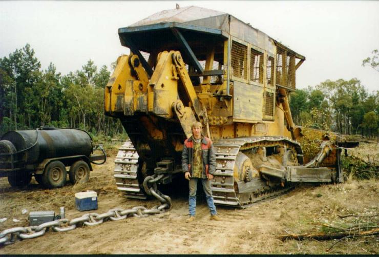

If you need some heavy chain for pulling stumps, this stuff should hold together./w3tcompact/icons/shocked.gif I wonder what the ships captain thought when he noticed that his anchor chain was missing?/w3tcompact/icons/laugh.gif

Hi ya
where was that pic taken?? the last time i saw chain like that was in Oz where they tied 2 dozers to it and chained bush ground
catch ya
JD Kid
/ Pulling stumps #55
As a matter of fact that picture was taken in Australia. As you said they took a long length of that chain and hooked each end to a rather substantial bulldozer then headed off through the brush some distance apart. Everything in between was pretty much wiped out. I got that picture form the VanNatta Brothers forestry page. If you have alot of time to kill there is some fascinating reading on that site. Here is a link: http://www.vannattabros.com/index.html
