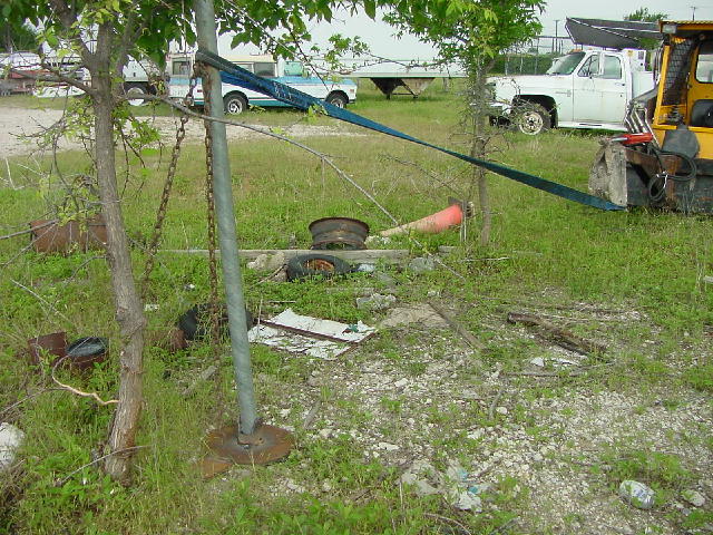

All I got was a before picture. I love my Sony FD97 because it's a great digital and I have the option of using either a memory stick or floppys. Floppys work best for me. I can use anyone's puter to view them and it's simple to file them away for quick retrieval. But of the floppys I had with the camera there was only one blank shot left. So we got it. I can get another later tomorrow after the storms blow through that are coming in right now.
I don't have any stumps on the place. So I walked back there was this tree.....I said was.
This thing worked far better than I ever thought it would. I know it isn't the cat's meow for killer big ones or even of real interest if you've got a good sized tractor with a hoe.
This thing is a fifteen minute compilation of scrap stuff around the shop hot glued together when necessary and quick cut with the plasma or chop saw.
The base is three eighths plate with a little scrap welded to help the pipe stand up on it's own on the front side. The base pipe is three inch (3 1/2 o.d.) and cut that way to allow the vertical pipe a path of movement. I didn't want it to have it going sideways at the wrong time.
The two inch (2 3/8 o.d.) vertical pipe is about five feet long and schedule forty. The quarter inch chain hook is down about eight or nine inches from the top. The pipe I freehanded cut the bottom. What I did was cut it about a thirty degree angle on each side so it would be able to rock back and forth in the big pipe a little more.
For safety please consider the very important consideration of the chain being between the vertical pipe and the tree. Then the fiberglass sling strap slipping over the top of the pipe for a simple and free release. This way the chain will automatically fold down with the pipe. The pulling pressure will be with the sling and it will be free just as the pressure on the chain goes from vertical to horizontal.
I had the thing tight when I took the picture. What I think is important is the way it is made no one has to be close to hold anything in place before the sling is tightened up. The unit is self standing.
I used a clove hitch knot with the chain around the tree. The tighter you pull the tighter the knot gets.
I got back into the tractor and started it.
I kept the motor at idle.
I backed it up.
The tree came right up and out.
I know it's a little tree. But after my experience the other evening pulling the red tipped photenia stumps with the back hoe attachment I do believe this system was more efficient and cleaner.
For someone with small to medium stumps and no FEL or backhoe this system would work fine.
Now if someone hooked it up to their four wheel drive and them left slack so they could get a running start backwards it might toss the deadly pieces to parts unknown. But using a little discretion I do believe you will be happy with it.

Thanks Harv
The picture is truely worth a thousand words! I don't have a tractor (yet) but I do have some stumps to pull and a Warn 9000i winch on my p/u. You just saved me a ton of sweat!
I've got 150' of cable and a snatch block for angled pulls to keep me and my truck out of the way. Safety first!
Just one question. Would you do anything differently if you built another one? The stumps I am pulling are about two to three times the size of the tree in your picture. I'm thinking a heavier bottom plate and heavier chain. Any thoughts? TIA
Mike
   / Pulling stumps
I think I'd try what I've done here first. Then if you have a problem with the plate sinking place another plate under this one. If the chain breaks then go to a heavier chain.
I like the idea of the winch. That allows you to apply and stop the tension with great control. It was one of my fears of posting that someone would hook up their four wheel drive and do a jerk.
The way I've designed it. I can take close ups tomorrow if there's interest. I've got it where it's a one man job. The plate probably doesn't weigh more than ten fifteen pounds. The post is about the same. The fitting at the bottom is about right so that it can be assembled a piece at a time and be self locating and standing.
BTW I've done the four wheel drive and jerk thing in my youth. I've also broken some pretty healthy snatchem straps doing that.
But think about it. Pulling from the side say like with a truck or tractor you've got everything in shear. That's the direction it's all strongest. But lifting it up, even a little, and pulling it puts it in twist which is a weaker point from the stumps perspective.
