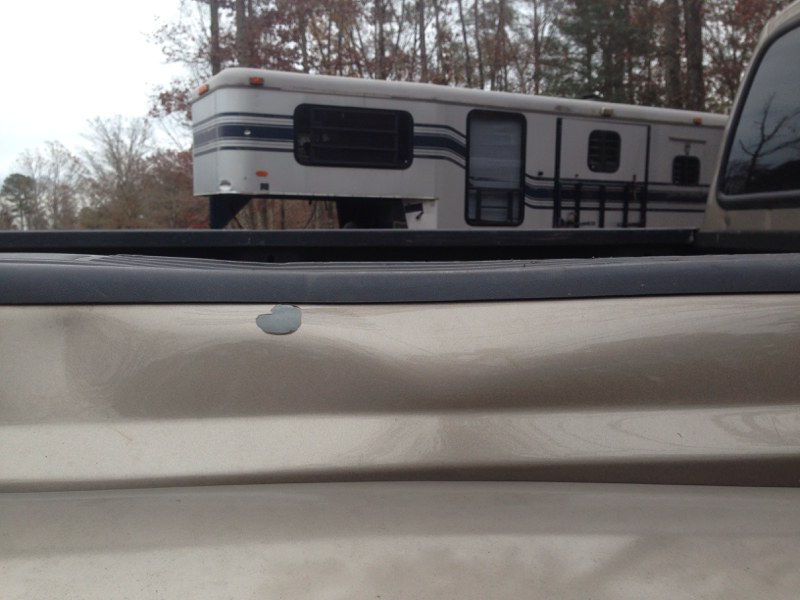

Are you asking if you can have tool. Boxes on your truck? The one right behind the cab plus the 2 side boxes. If so I say no. When you turn or if your right trailer wheels drop off the road it will hit the boxes. I can send you a pic of what it does to the bed.

Here's what my truck looks like. That's the trailer in the background.

Walkin- How much clearance did you have between the trailer and the bed rails? I have been in some creative situations with horse trailers and even more precocious situations with a flatbed hauling hay and I have never touched the bed rails. Once, I have however failed to get my tailgate properly latched and it dropped in a turn and got wedged between the jack on the trailer and the bed corner! :eek: With an equipment trailer, I have alot more confidence since there isn't as much trailer hanging out overtop of the truck. With a flatbed that long enough now, I don't even think twice about the trailer being behind me.
