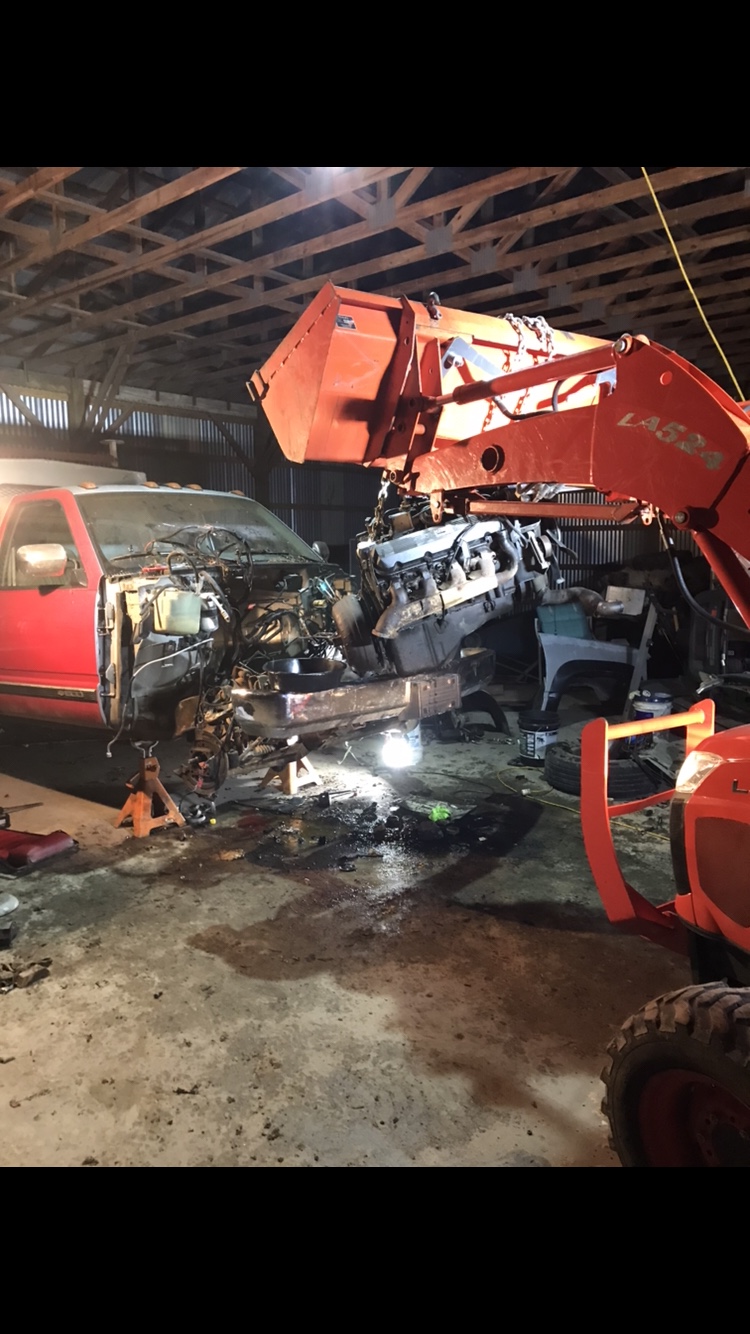

I doubt it’d going to do it. My L3800 just barley pulled a 454. IMG_0976.JPG
