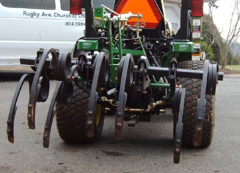

My JD 4010 pulls this old soil ripper beast that used to be made for an 18 hp JD M. See attached.
Don't think it'll pull it through unplowed ground.

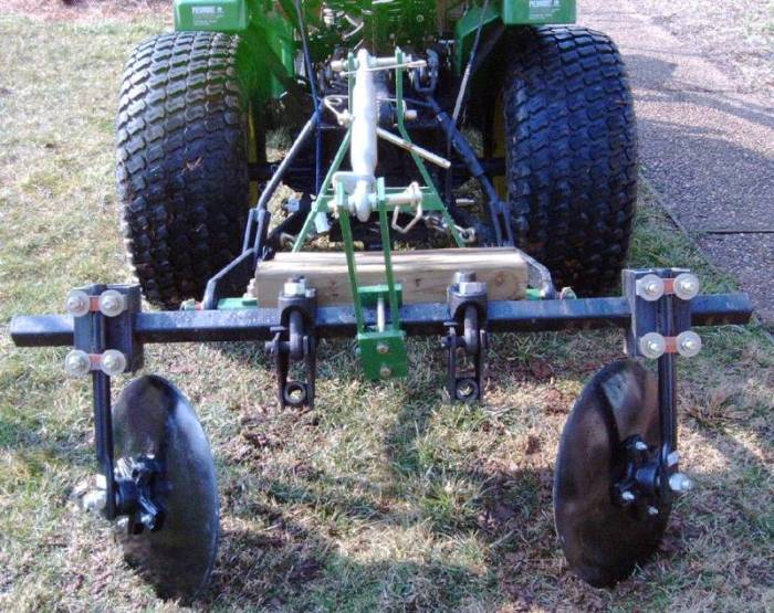

The JD 4010 also pulls this fine, to make raised rows.
Have wondered if I turn the discs to parallel whether they would cut through and "do" unplowed earth as well. Haven't tried yet. The discs are mounted on the same diamond bar that the 7 chisel plows were for soil ripping. I've now 4 chisel plows in the middle with 2 smaller discs that I call my "row maintainance rig": for maintaining my raised rows in place rather than plowing, which kicks up some fresh weed seeds each time.
