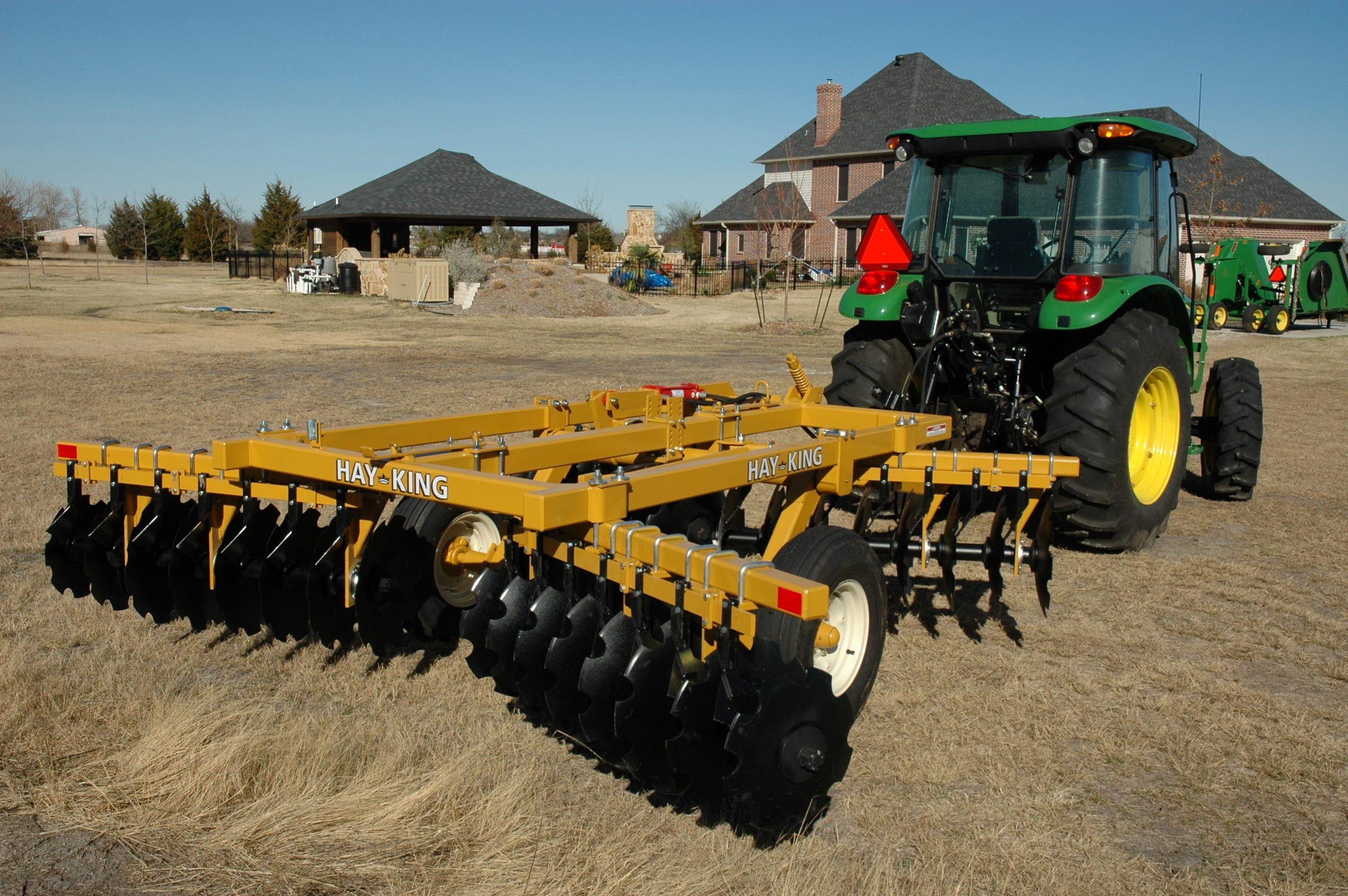

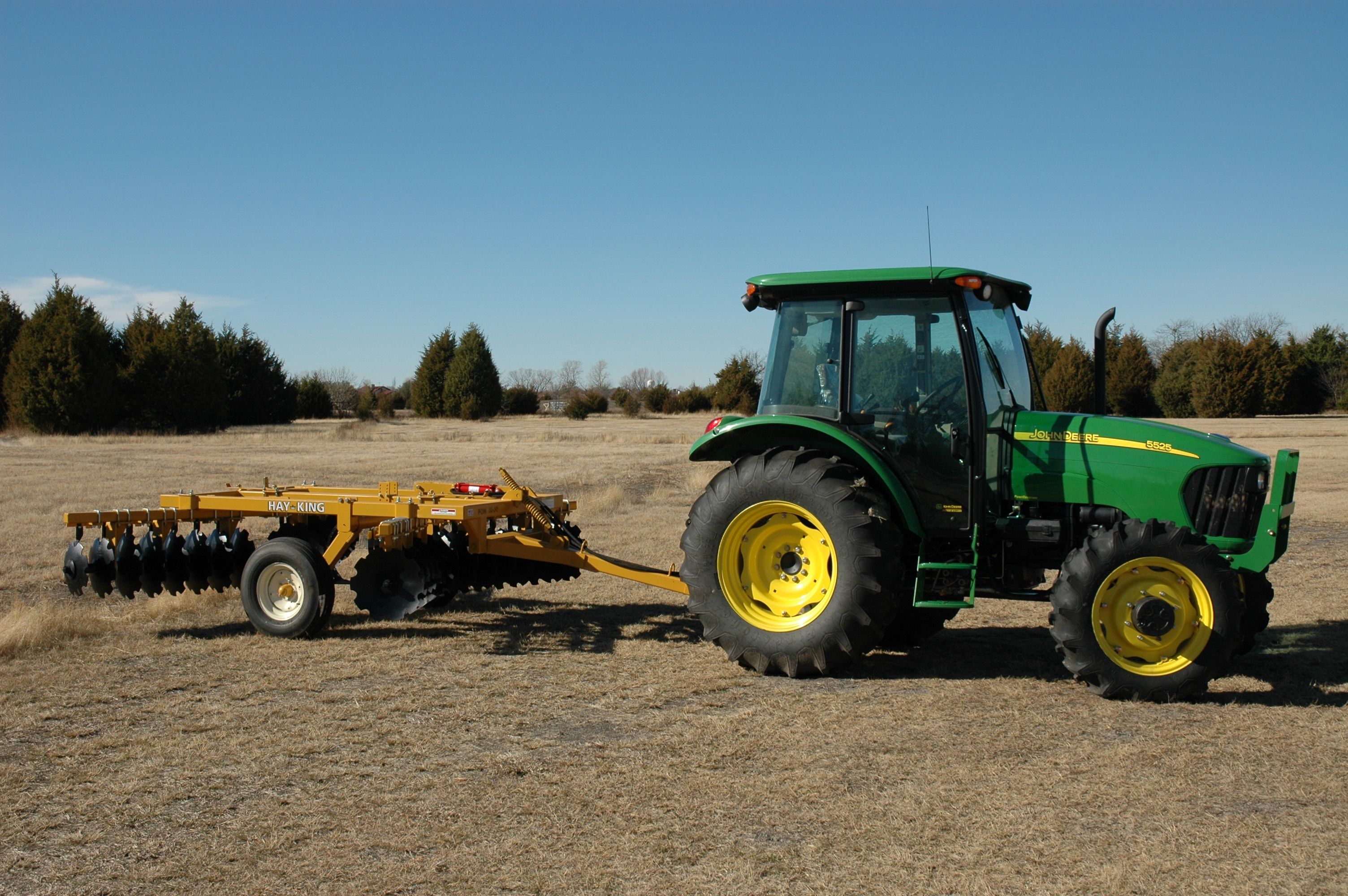

Will not be a problem. I pulled a 10 footer with a lot of weight on top with my 45 hp tractor and had smooth sailing.:) (Sorry about the orange color on the tractor!!)

Will be the odd one here who says you will not be able to pull it. At least not at any speed you need to. Both my brother and I both have 9 to 10 foot disk and we pull them with 68 and a 75 hp tractors and a full load on them. We have sandy loam soil also. But on first disking our blades will penetrate much more than the picture shown by Oleozz with NO added weight. Both of our disk are 20 inch blades with two different brands of tractors and disks. On second or third pass we are disking full depth which is about 8 inchs. Again all we want to pull at a speed that a disk needs to run at. We are running with loaded rear wheels, two wheel drives. One orange and one red tractor. Harder ground is easier to pull disk over than softer dirt.
