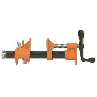

For that amount of posts, I would make or have made a steel plate with a hole slightly larger than the post. It would work like the locking plates of a pipe clamp. Make a post+ size hole and a chain hole. Drop it over the post and lift.
