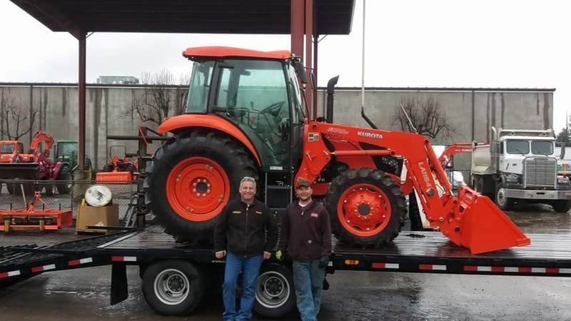

So I have about 20hrs on the tractor. So far, I am thrilled with it. A few issues -
I already have to replace the left side door. Not 9hrs on the tractor, and gone. Dog was being stupid, went to open the dog to yell at him and my wedding ring hit the glass hard enough for the ENTIRE door to explode. I was shocked to say the least. I seriously needed new underpants. I couldn't believe it. So thats something I get to deal with.
Also, I'm less than thrilled with the power of the front loader. I've had no issues with picking and carrying a full bucket of AB, but its a struggle to pull the bucket up through the pile. On the other side of it, the loader will not lift the front of the tractor off the ground. Also, I got it good and stuck 2 weeks ago. Did the usual, dig the bucket in, use the bucket curl to push the tractor backwards. No dice. Didn't have the power. Very disappointing...............
