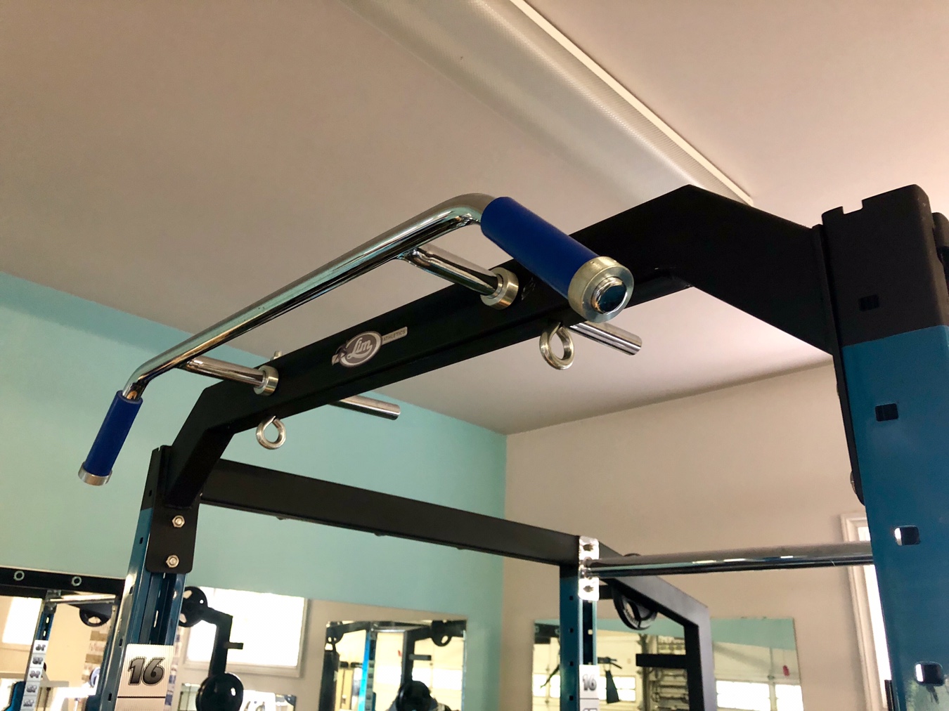

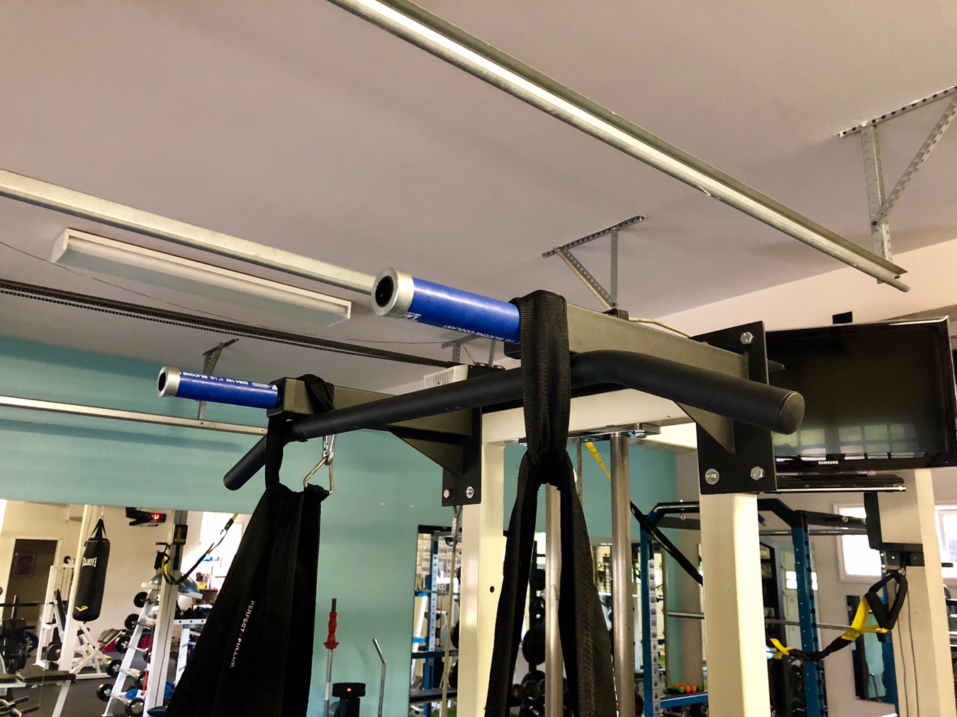

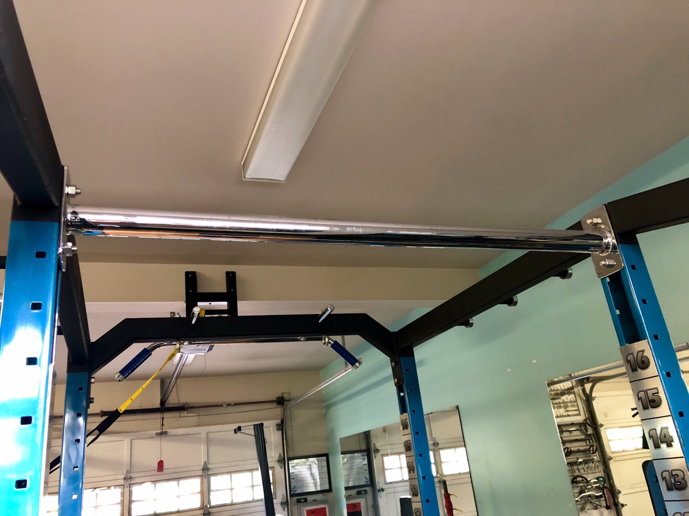

Here are some of the pull-up bars I’ve built all for indoor use.

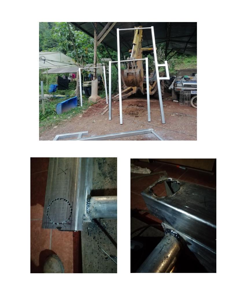

Sorry for the slow reply. Yeah, all said and done. No good metal cutting hole saws at the local HW store so I just traced the circle with 1/8 holes and poked it out with a hot stick. Took a while but worked okay. No fancy chroming here, just a can of silver spray paint. But they look okay. Thanks for the advice, attached are some pics of the process.
   / Pull up bar #8
Nice work, Sebculb! Too bad a hole saw wasn’t available. It would have been faster but the end result is the same.
