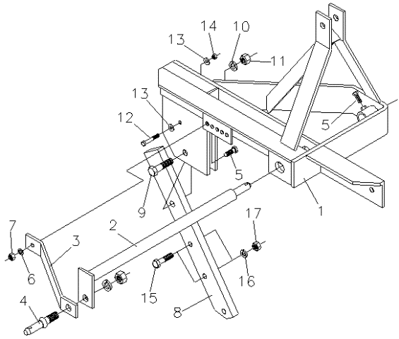

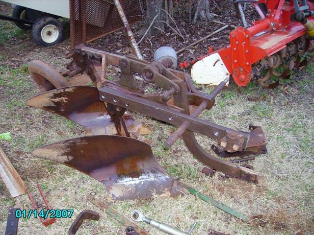

I am work on a Bottom plow , Can some one tell me how far down I need to put the Lift Pin on the left of the Pull shaft. I think it is 2 1/2 but not sure.And the 5 holds for the setting are they 1/4 apart or closer .I am taking a pull type and making a 3 pt .

Dose no one have a Worksaver Bottom Plow .That can give me a measurement.

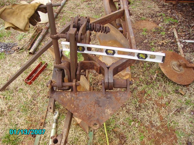

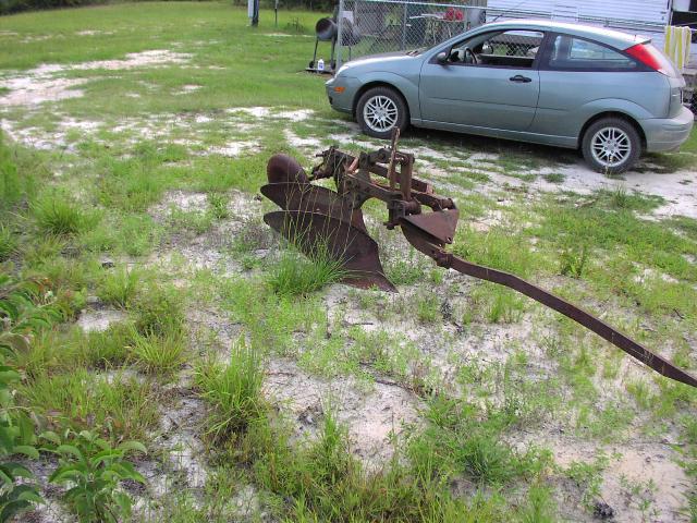

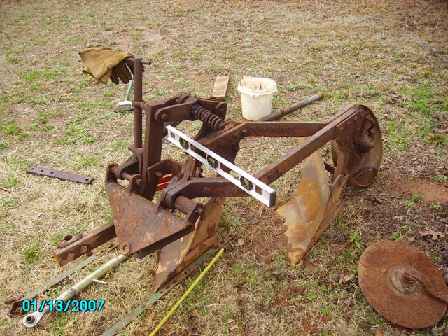

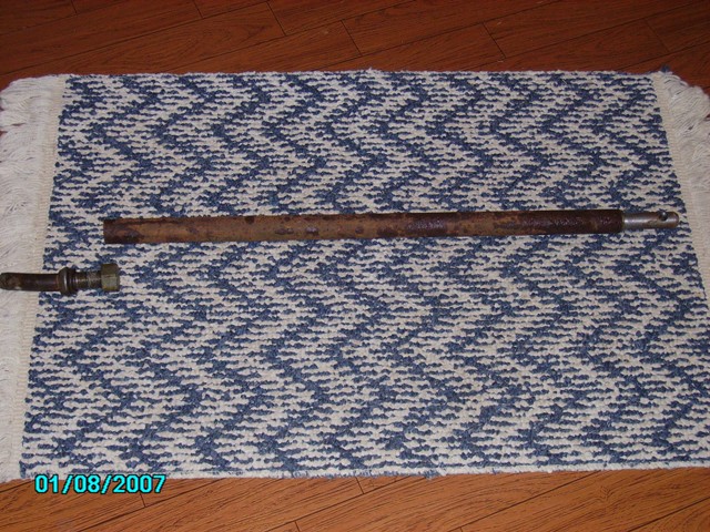

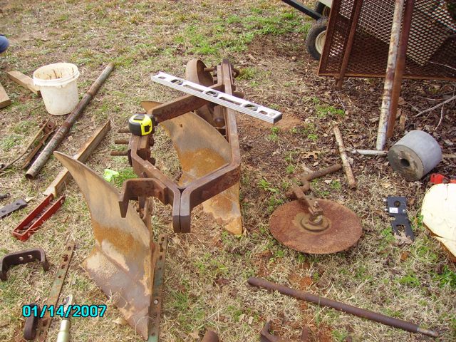

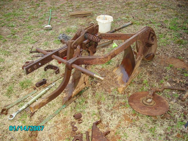

This is a 2x14 MT John Deere Bottom plow a friend on here let me have.But it is only good with the JD MT. I am trying to make a 3 PT hitch out of it . And save the spring trip if I can.The tail wheel is on wrong but have not had time to take it off yet.

My plow is different from the one pictured. The frame is a 2" square tube not a shaft, however the offset of the pins is 3". Don't know if that helps or not. You can always adjust your 3pt arm height to get the plow set right.
   / Pull Shaft Weldment
From the center of the right pin to the center of the lift pin is 3". is that right . They have them close and if I put them the way they have them . I want have to move it much.
