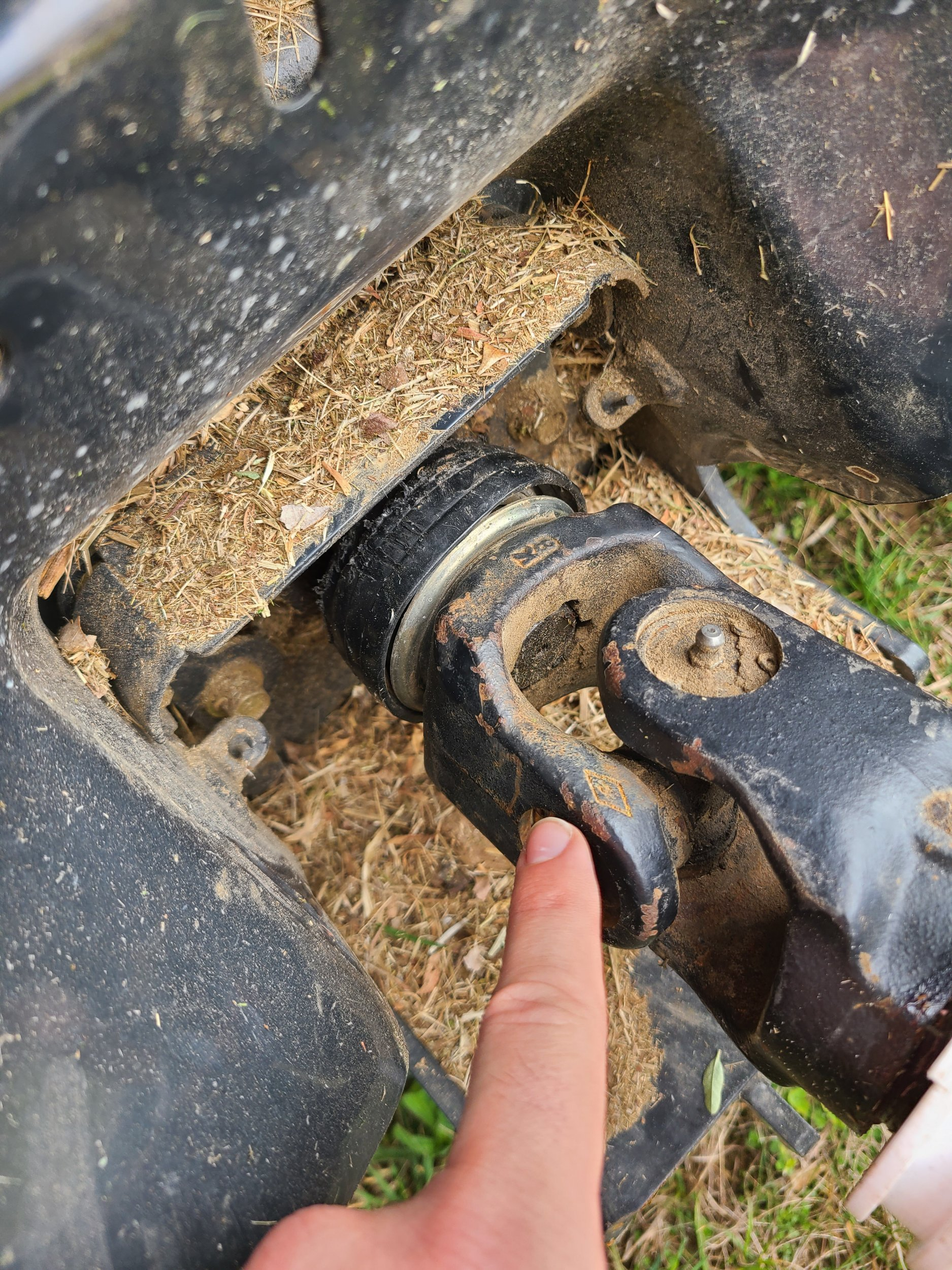

I bought a used rhino 260 rotary cutter and it needs the end that Hooks to the tractor pto output replaced as the collar that pulls back to release is bent and hard to manipulate. I want to install the kind that has a push pin instead. The Rhino part number is 00779516 but I can't find anything online that crosses over. Do I need to tear it apart and measure the u joint cross to find the right replacement? Thanks!

The easiest way will be to remove your yoke and take it along with the u-joint caps into your local dealer and have them order if they don't have it in stock.
Alternatively Bare Co has a very good selection;
Bare Co USA - Home
   / Pto Yoke quick connect replacement
Not the whole shaft, just the end yoke with the spline connection. I installed a new bareco pto shield and realized the slip ring collar was messed up. Just need that end piece and want one that uses a push pin type instead of the collar.
   / Pto Yoke quick connect replacement #4
Those sliding collars are definitely more difficult for me to use, I highly prefer the push pin type.
   / Pto Yoke quick connect replacement #5
Check into a local shop that does drivelines. They probably do agricultural PTO drivelines as well.
