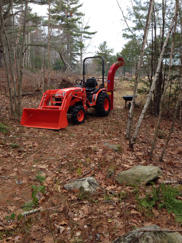

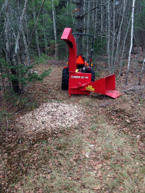

Just picked up a hardly used patu dc 40 for my kubota 2620. About 6 hours of use this morning great machine. On kubota b series if put in neutral with parking brake engaged the forward tilt on seat allows pto use while off tractor
