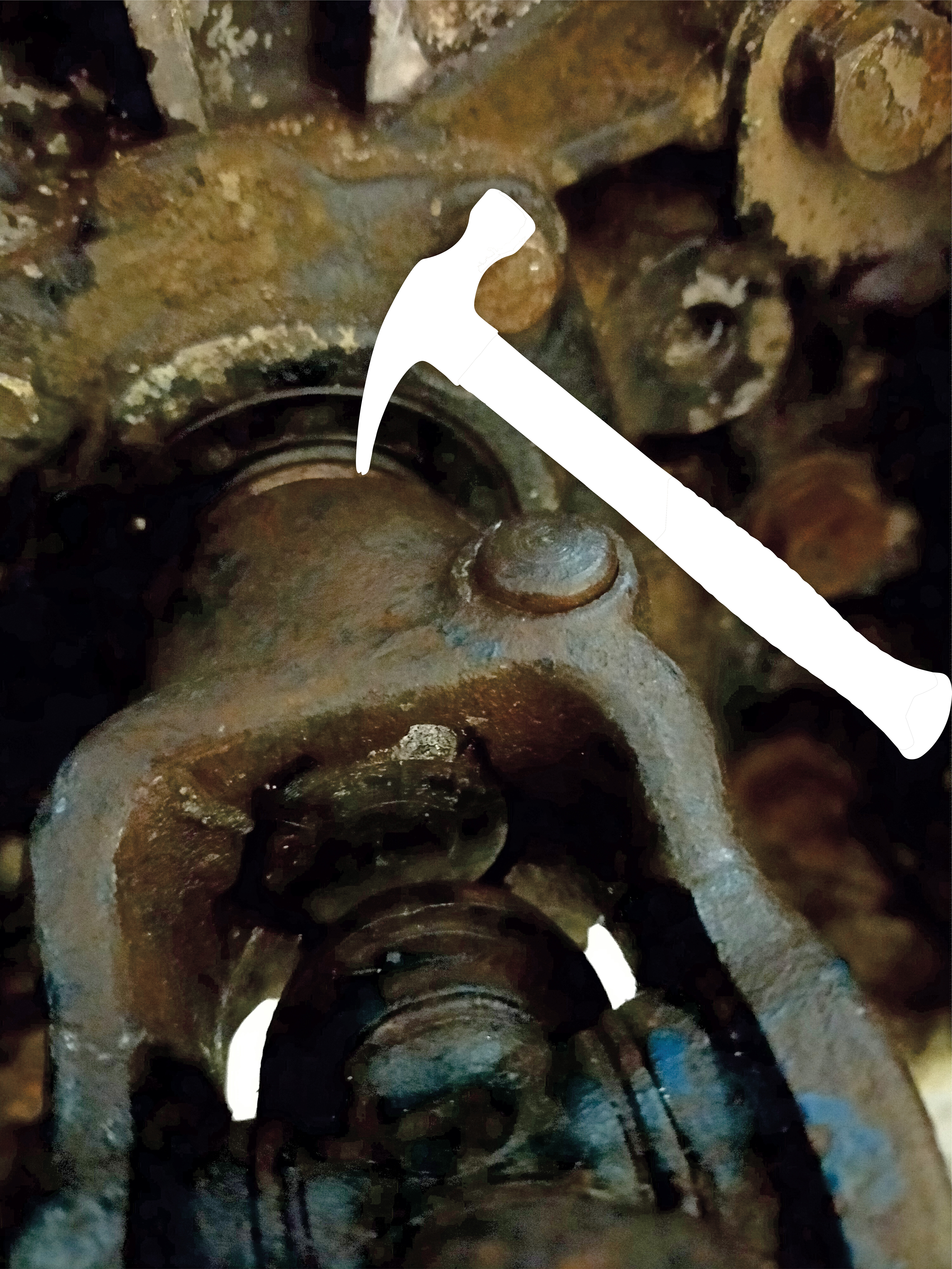

i had a similar issue years ago. what i did was place the claw part of a hammer against tractor and apply pressure on the pto shaft fitting. then i began lightly tapping the fitting with a 12oz finish hammer. it slowly began to pull apart. then i thoroughly cleaned shaft and all pto fittings. i now spray silicon into all ptos before attaching. no further issues.
key is light pressure and not smackingView attachment 649545
This also works for me, but I use a crow bar, and it's never failed to work.
I do start out spraying it with lube.
SR

Well in these dark times i come to you with good news!! it is off!! The old crowbar trick did it for me, pull pull pull spray pull pull pull rinse and repeat 1.53 million times 1 hour later POP!. I am so happy, who would of thought it would indeed bring me such joy but it did!!!
