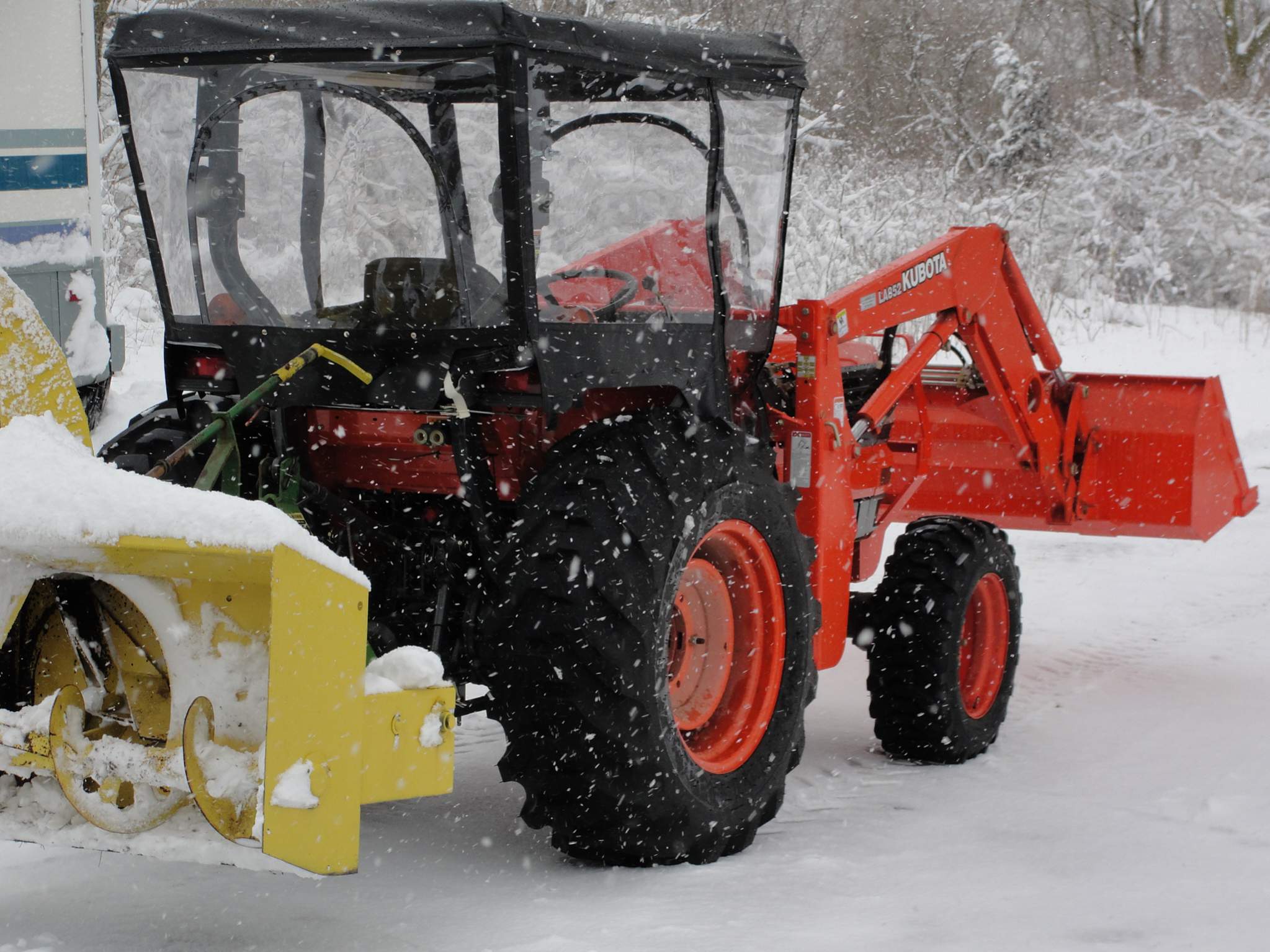

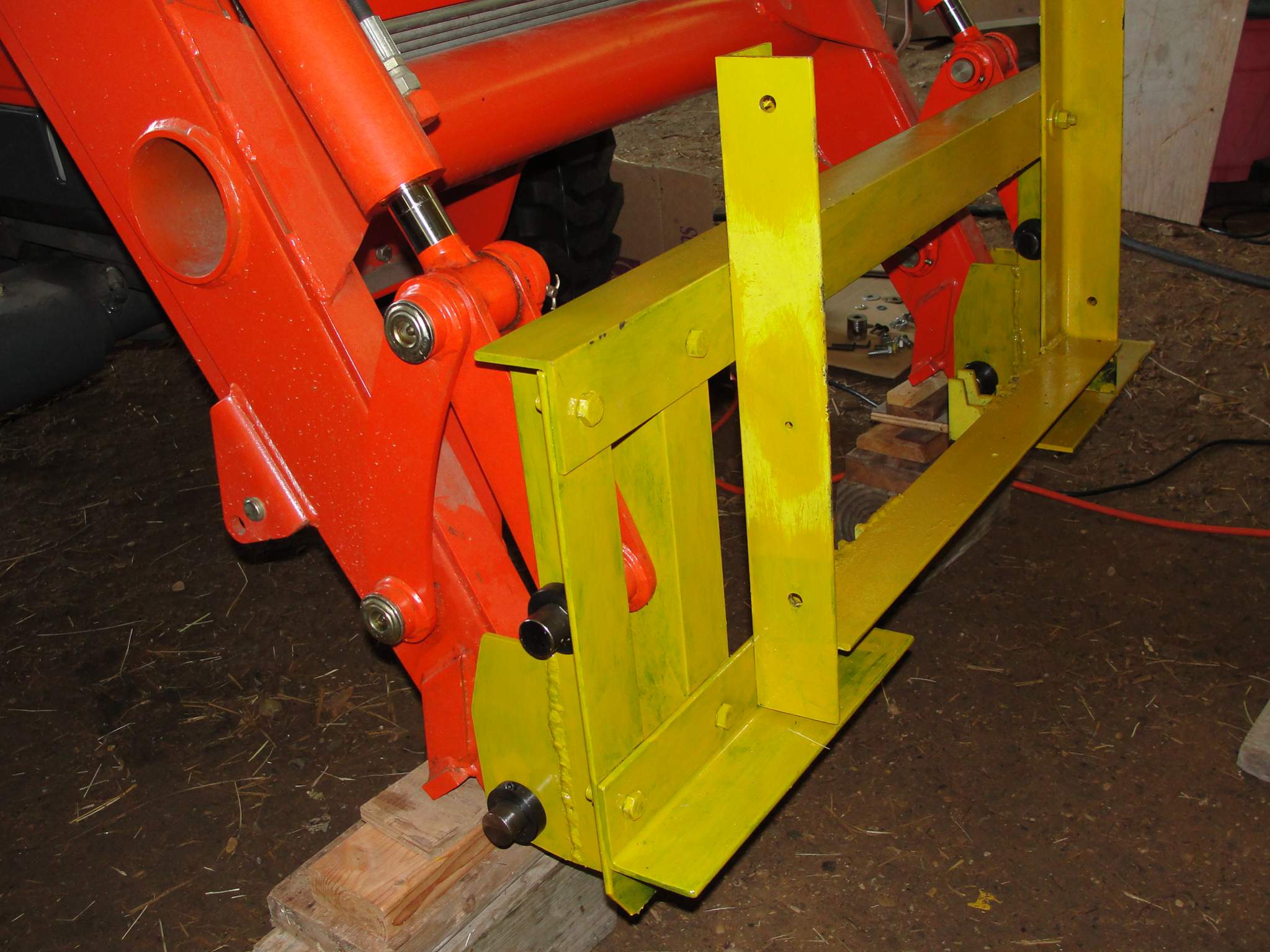

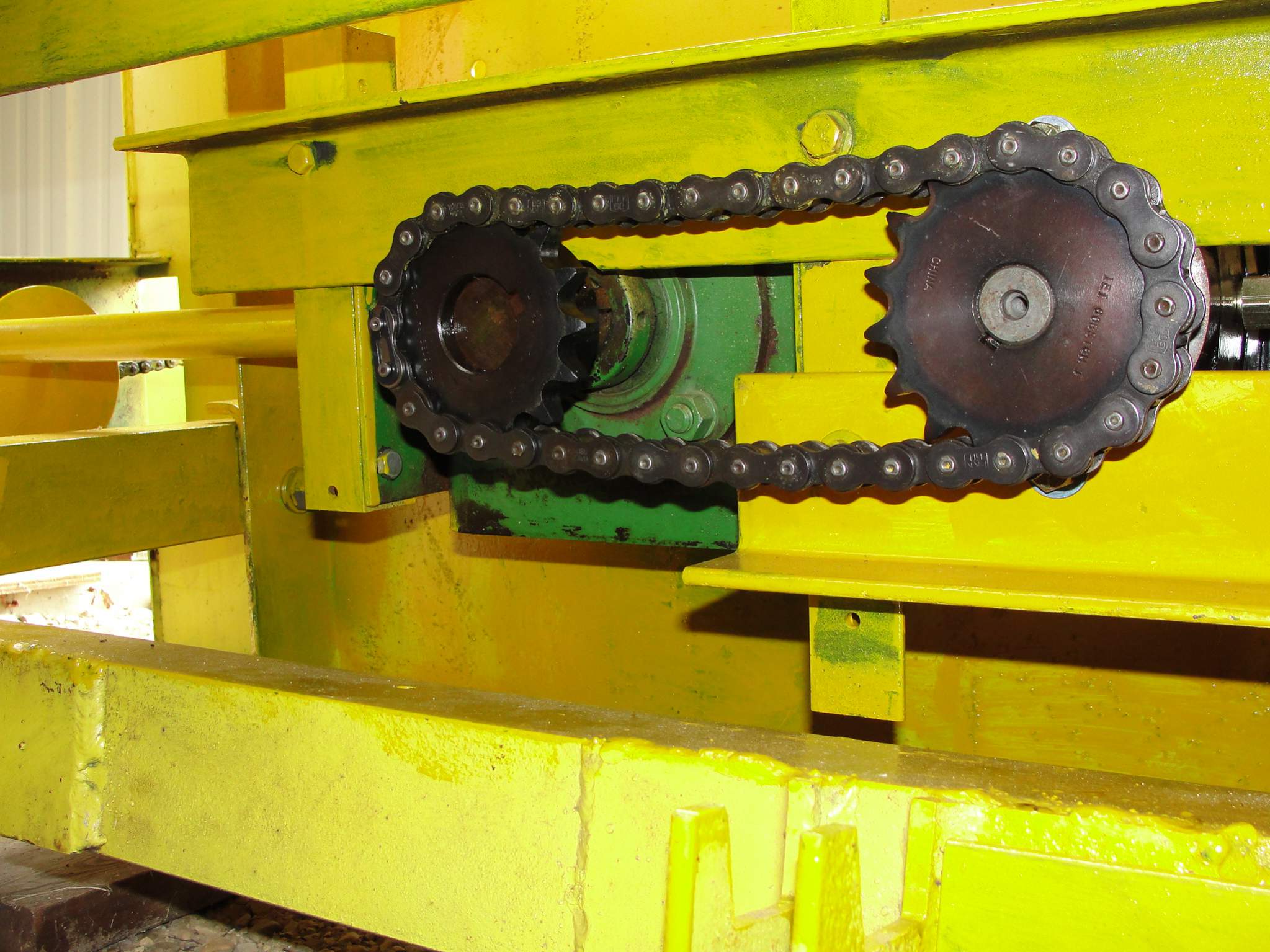

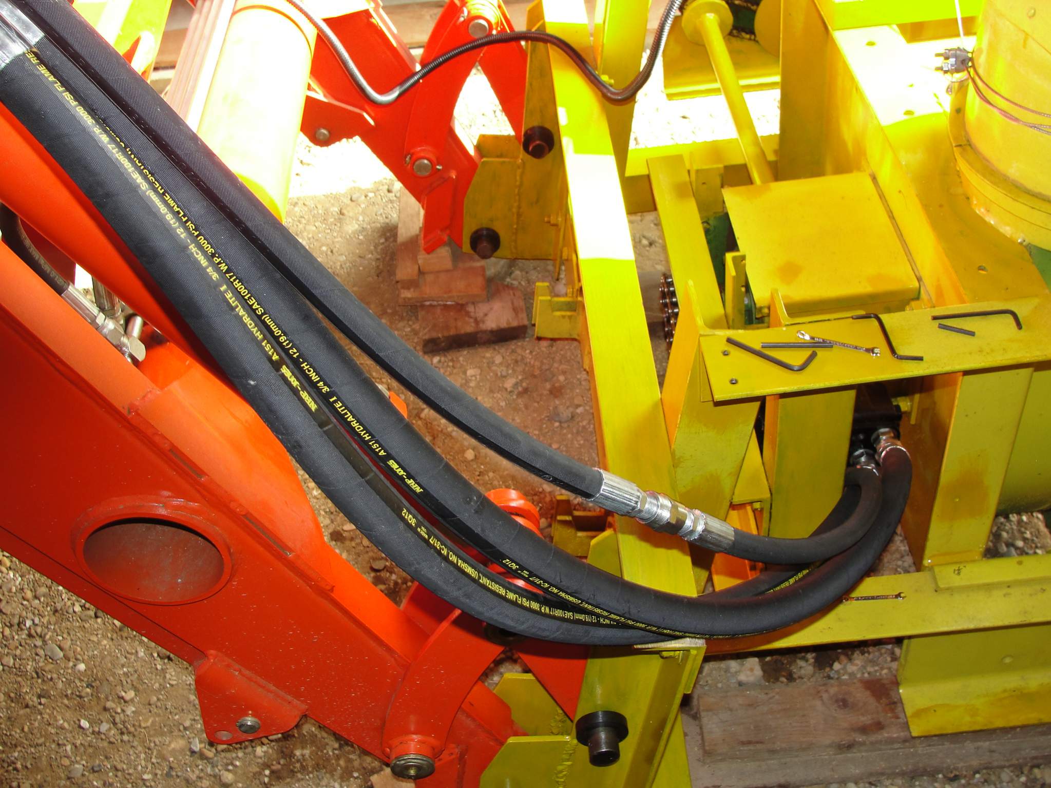

L4610 GST shows 2700 rpm for 540 on rear PTO (Operators Manual) but my Engine Tach shows 2500? My (O. M.) has it printed 2700 rpm in more than one place. Ex. p42, quote ... "there is a PTO -1 540 rpm indicated mark on the tachometer board..." Hummmm?
My tractor is a 2001 V2203-EHA
Anybody else run into this?
I'm now figuring my tach rpm for running my new front mounted hydraulic motor that powers my loader mounted "front snow blower" (ie w/o the 72" bucket).
Thanks for info.
Pic 4 the old way last winter .................... pic yet to be taken for the NEW way.
