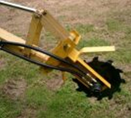

Hi
here is one made for a backhoe I don't remember who made it or where i got the pic. but I think it was on this forum. maybe someone else will remember when they see it.
Charlie.

   / PTO stump Grinder
What about pto to slipper clutch to right angle gearbox. Out of the gearbox with a splined shaft that goes in the center of the bearing mounted cutter wheel. I was under the impression that the wheels turned more than 500 rpm, does any one know for sure? This is a manufactured one. I like this design.

   / PTO stump Grinder #9
That is sort of what I was thinking on the grinder wheel so far. Carbide tipped would be necessart for weld on I would think. Also I would try to balance it as far as possible.
   / PTO stump Grinder #10
Nitroxn That would be a good way to mount it I thought in the previous post that you would want to leave the other end unsupported. I think you would need a heave right angle drive box like a heavy duty bush hog has to speed it up. I think they are a 1 to1.5 or 1 to 2 ratio to speed them up. One thing about having a bearing mounted on the end it may also help you if the shaft ever decided to let go.
I used to do som welding for a tree service that had a Vermeer stump grinder, Ill see how his shaft is mounted, I know his ran off belts I remeber having to tighen them or replace them on occasion. I think they run from 800 to 2000 rpm I think his was set to 1000
