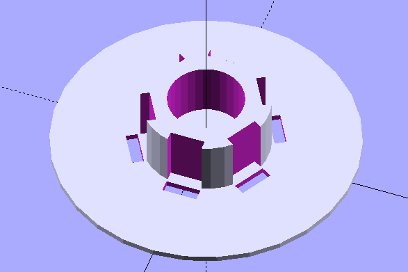

Hi,
I always have trouble attaching a PTO shaft with a tractor that has a locked PTO and some heavy equipment like a haybine or tiller where you cannot easily turn the shaft. The major problem is you cannot tell where the splines are on the female coupler. Attaching this is a 15-20 min greasy job with lots of frustration. I have designed a 3D printed plastic stencil that lets you paint marks on the end of the coupling so you can see where the splines are and see where to move the shaft as you do the attachment.
Attached is a ZIP file that has a document explaining further and source for the 3D part and an .STL file that can be sent to a 3D printer.
If you need any further info write me at jim.schimpf@gmail.com

Wouldn't making a mark on the PTO shaft with a sharpie pen (or file a mark in the metal) work about the same to line things up?
Also, if you shut the tractor down and engage the PTO, would that unlock it so you can spin the shaft to line up the PTO? Lucky, mine spins every easy so I can line it up in no time.

iUnfortunately neither of mine do. I have an Case-IH 5160 and a IH 90C both lock with engine OFF or ON and the PTO ON (with the engine OFF!!!!) or OFF. Yes you can mark the end with a sharpie or file but it's not easy and hard to be accurate. Also you are probably not going to do all 6 splines. With this, in about 1/2 hour you can mark all your equipment and it's easy to redo when it rubs off.

I understand your reluctance to open the file. Here are the files in the ZIP. They are an openSCAD file (TEXT) which is the source of the stencil (go to openscad.org for the viewing program). And an .STL file (also TEXT) which goes to a 3D printer.
NOTE I had to add a .txt extension on each so the system would attach them. Just clip that off if you want to use them in openSCAD or a 3d printer. Otherwise you can just open them in a TEXT editor.
--jim
