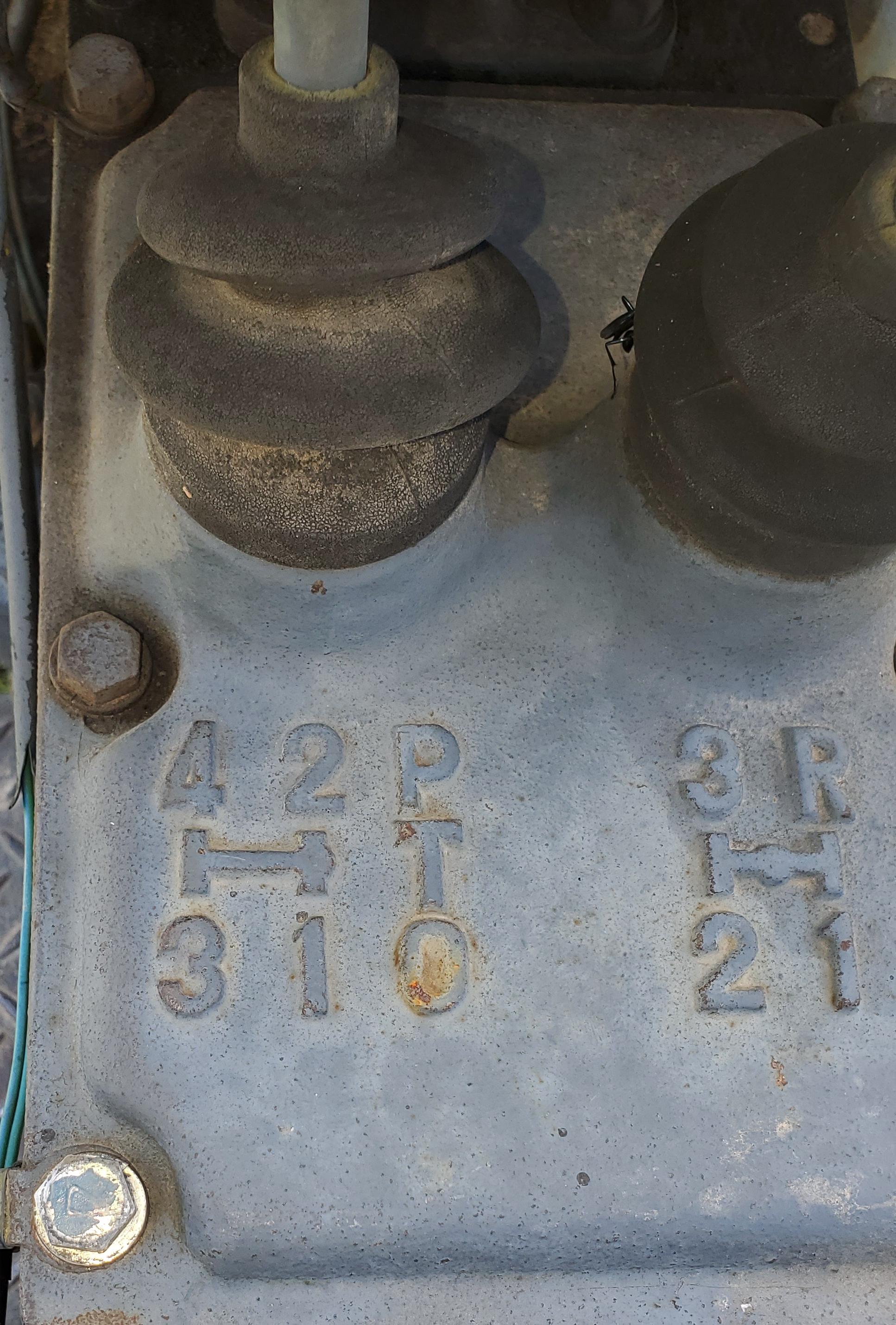

My Mitsubishi D1600 has two shift levers and a Low-Med-High gear shift. So the previous owner gave me a few pointers on what speed he uses to mow, but how in the world do I figure out the actual PTO speed? If there were any stickers, they are long gone.
The PTO shift lever has 4 speeds. The transmission has 3 speeds and a reverse. And of course the Low-Med-High selector gives me 9 forward speeds. My tachometer works, but there are no pointers as to PTO speed versus RPM. Does anyone have a manual or sticker that might clue me in to obtaining the typical 540 RPM PTO speed that implements are supposed to use?

My D1850 has the same setup, use PTO 1 for 540 rpm. I'm 600 miles from the tractor right now so I can't look to confirm. but on mine there is a larger white block on the tachometer line just past the 2200 rpm reading (I think), that is to indicate 540 PTO rpm.

Ok, well, I am such a noob that I thought that shifting the transmission gears would effect the PTO speed. So are you implying that itr won't matter which of the 9 forward speeds I shift into, that the PTO will only be effected by engine rpm and its gearshift lever?
And since my tractor seems to max out at around 2100 engine rpm, those PTO speeds are roughly the 2100 rpm speeds for my tractor? If so, here is my back-of-the-napkin calculations:

It is a combination of both.
It is a transmission; rpm is how fast it spins and the gear is the given ratio.

Engine rpm + PTO gear position (or times ratio if you wish to use real math) = (gives) pto rotational speed
As I mentioned from another thread:
D1850 1-540*
2-752 rpm
3-997 rpm
4-1282 rpm
Are the pto speeds for your tractor at 2,580 engine rpm.
540 at PTO gear 2 for your tractor would be engine rpm 1,853.
