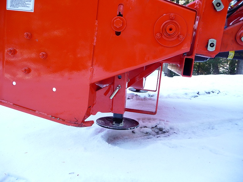

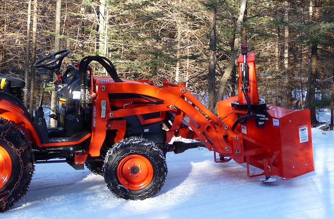

Usually it's the shear pin for the snow blower that should break off. I have a gravel driveway (half a mile), and it's always the Meteor shear pin that let goes?
For gravel road I found out those round skid plate: real improvement! 1.5 inche high,
Phil

   / PTO shaft with shear pins for snowblowers.... #9
Those are really nice pads, did they come with the blower, did you buy them or make them?
   / PTO shaft with shear pins for snowblowers.... #10
It's an option... They were available thought my dealer, for about 100$. They were made of thick steel plate. Instead of your regular directional front runner, you, we will be able to make a sharp turn without having to raise your blower or to drag a lot of gravel.
