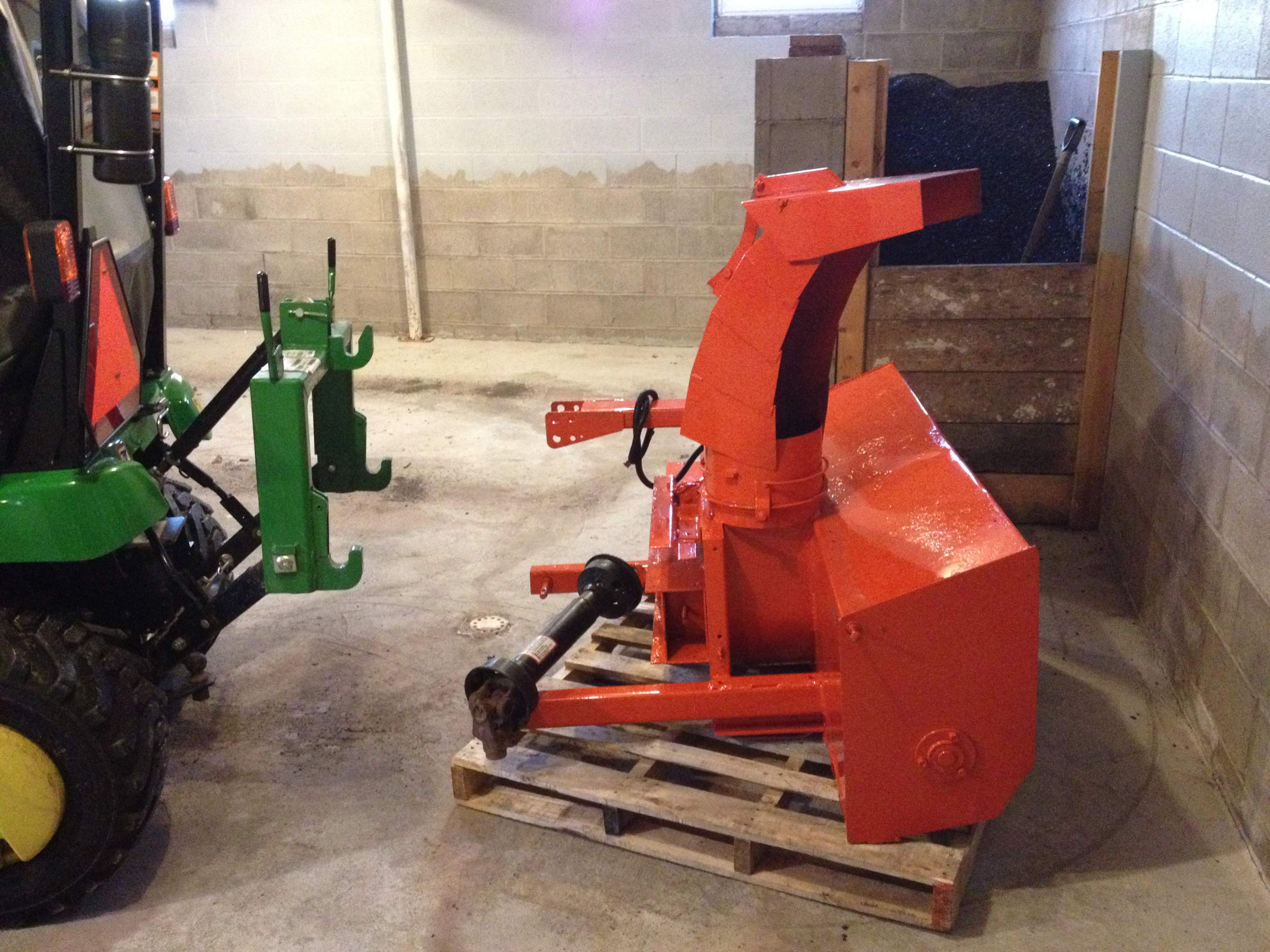

So I have a unique issue concerning a 3 PT blower I have purchased. Let me try to explain and see if anyone has other options that may help.
In a Craigslist ad, I spotted a really nice looking heavy 3pt 60 blower so I made the trip and after looking at it.. decided it was coming home. I own a 2010 JD 2305. Smaller machine, but will do just fine with this blower.
I have an issue with no protection in the driveline from the tractor PTO to the Blower input shaft, the PTO shaft is a 35n (heavy boy) that has no shear or slip clutch.
After researching, I found out that the blower is a 60 used on the front of an Allis Chalmers 5020 tractor running off a 540 PTO and was modified to a 3 PT set up.
The input shaft has what seems to be a 1 ス round shaft with a keyway. There is a hole drilled through the shaft, but no retaining ring to put a shear yoke on and trust it to stay on. The last thing I want is a bolt to shear on the blower and have a 540 RPM shaft to come loose and kill someone.
The kicker is the 35n series shaft and yokes, I was not able to find a torque limiter (shear pin) to fit on the yoke. The ones I found were for lighter 6n, 12n?
So I am down to what seems to be 4 possible solutions without getting a shop to start welding things..
#1 Try to find a 1 1/2 smooth bore to 6 spline PTO adapter, mount that on the blower and buy a normal snow blower shaft with shear yoke at the machine.
#2 Try to find some sort of female 6 spline with male 6 spline shear clutch to mount at the machine. Plug and play then.
#3 Try to fit up a new drive tube (square shaft) to replace the 35n series drive end with a standard yoke. Then I can purchase a shear yoke with quick connect for at the machine.
#4 Cut my square inner shaft and weld on a new yoke that is a standard light to medium use and gives me a shear yoke option.
Does anyone else see a solution?
Here are some photos for reference.
Thanks in advance

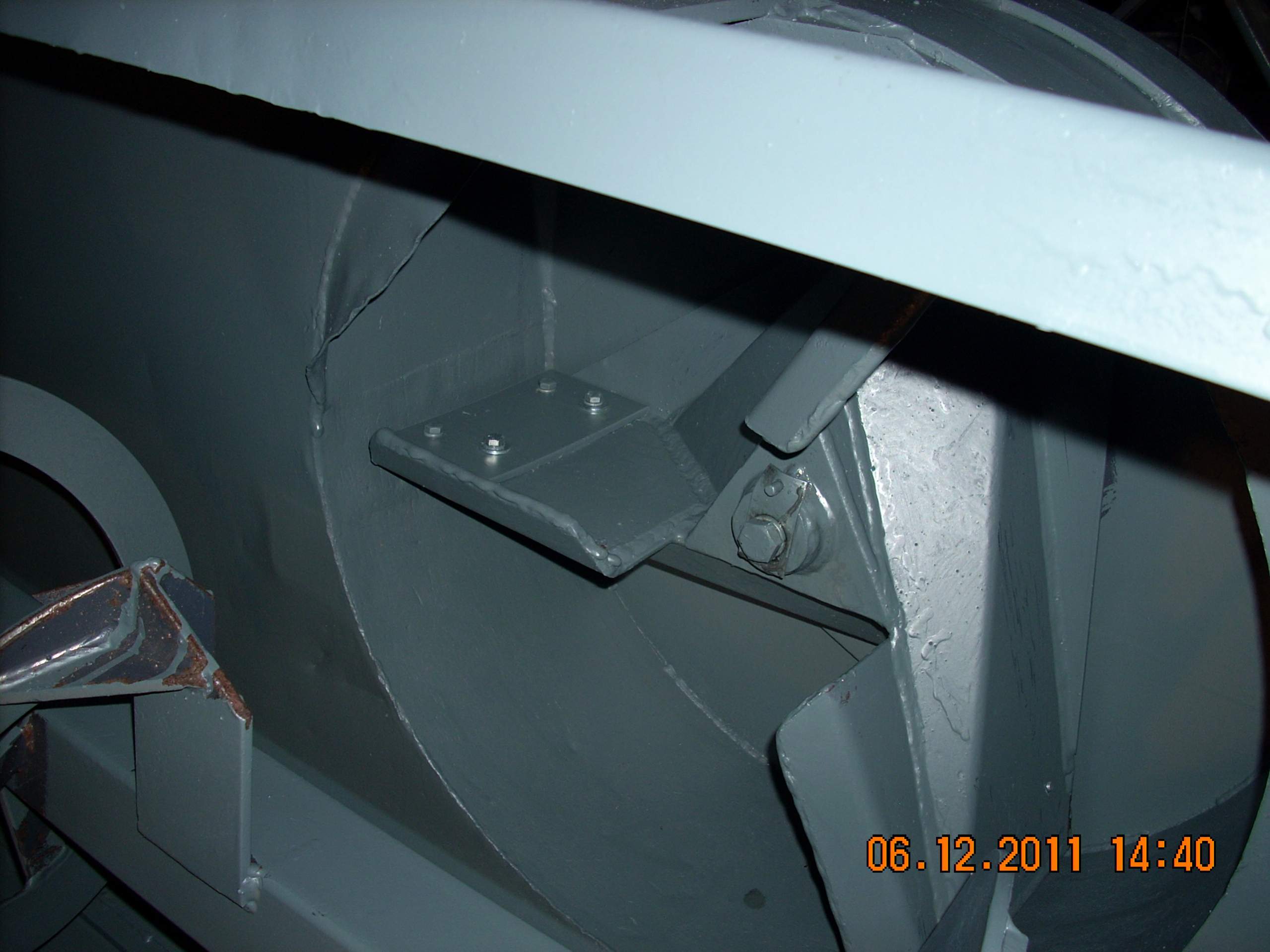

Typically, I would expect to see a shear bolt on the blower rotor, either parallel to the drive shaft between 2 tabs or perpendicular through the rotor. This would protect the impeller. The auger should be protected with a shear bolt near the large driven sprocket. I would not expect to see any protection prior to the gearbox. Your 4th photo of the input shaft and yoke, depicts an Allen set screw which tightens against the key in the keyway to fasten the yoke to the shaft. If the 2 forms of protection (auger and impeller) are present, go blow some snow. Anybody disagree???

There is a shear on the auger shaft, just prior to the chain drive. That is located all the way to the far left if looking at the blower from the machine seat.
The gear box appears to be sealed and bolted tight. There appears to be no easy way to change a shear if one did exist in there. The impeller has one single bolt in the center holding it on to the gear box. I can't see how that could be a shear.

Here are some more photos of the impeller and the shear bolt on the auger shaft. No protection in place and hence the PTO shaft issue I have now.

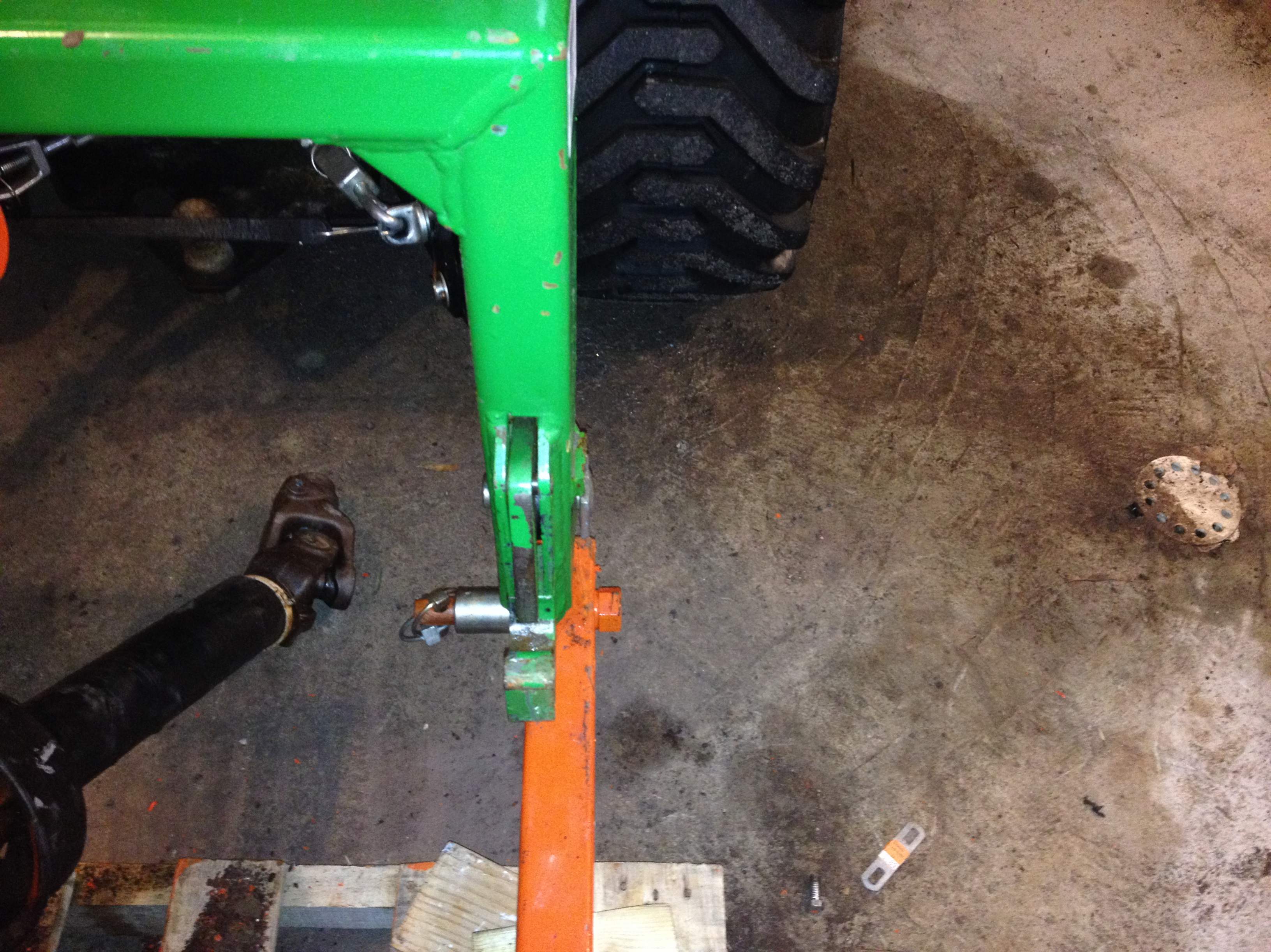

So update.. I had the day off on Friday and I spent a couple hours running to 4 different local shops in search for a shear plate yoke. Nobody had one, not even on a new complete shaft set-up.
So I bought the Eurocardan 4-LC4 shear yoke with flange from Agrisupply.com. It has the 1 3/8 x 6 spline with quick connect that will go on my tractor PTO, I then will buy a weld yoke #4 and new u-joint from tractor supply locally and weld in my 1 3/16 shaft. A bit of a pain, but worth the protection.
So on to the next step, welding on brackets for my Deere iMatch. Here is the machine and blower all lined up with the set position of where I want things. I have 1/2" steel and a piece of 1/4" angle to weld and support pins on either side for the bottom hooks of the iMatch.
Here are some photos.

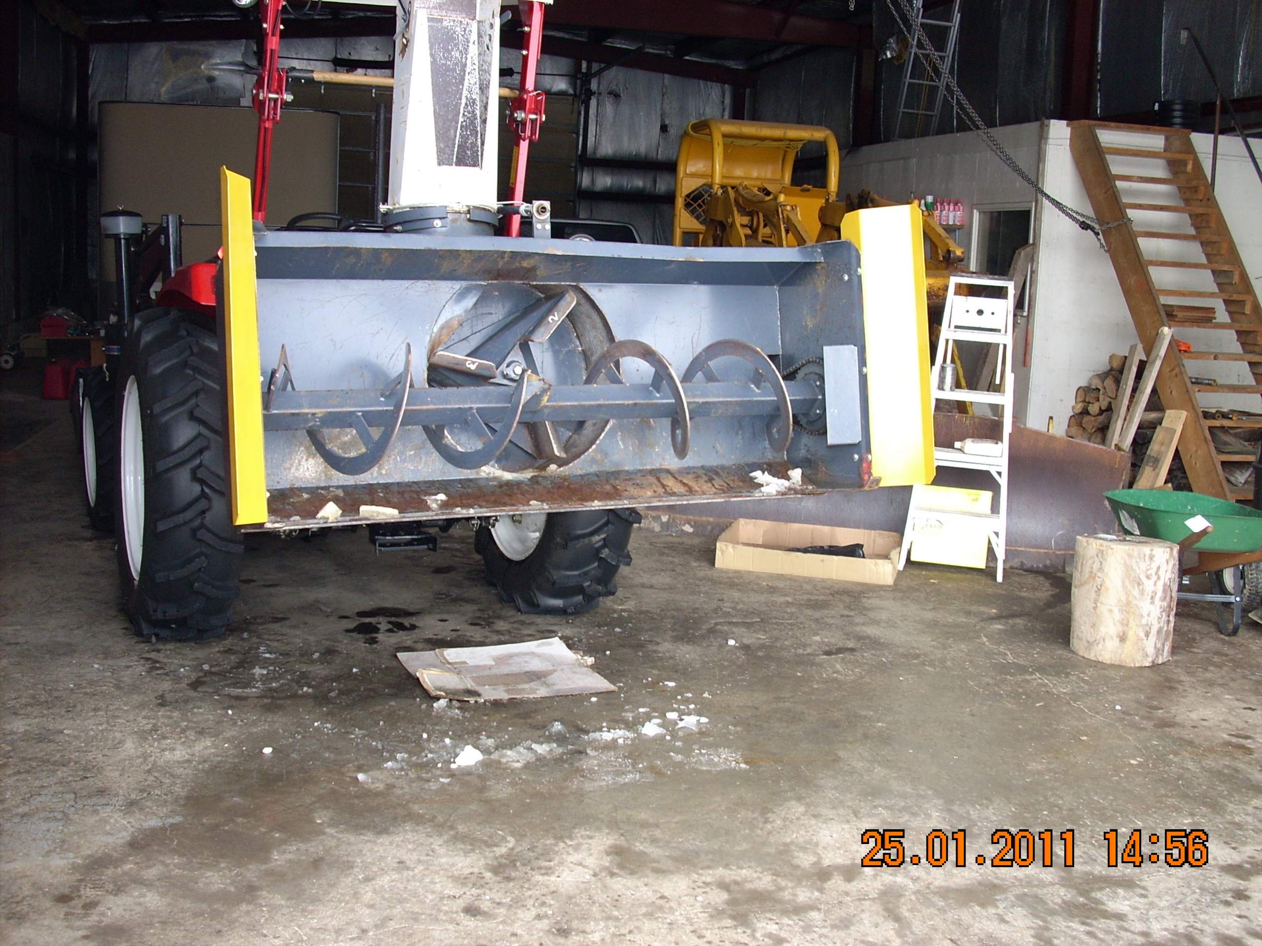

Just a thought regarding the shear bolt protection. Why don't you use a ful size bolt as per hole, but grind or file a groove on the shaft of the bolt. This will reduce the effective diameter allowing the bolt to fail earlier than it would otherwise do. In effect, it now becomes the "weak link" and will failas you want it to.
There is a shear bolt on the auger drive shaft at the chain sprocket - the single bolt going through the two small flanges. It looks to be bigger than it should be to me - perhaps the hole has been redrilled to a larger size to allow a bigger bolt to be used (say 5/16" instead of 1/4" dia).
I don't mean to derail the thread, but I see you have a three blade fan with what looks to be large radial clearances. If you use the blower at 540rpm, the output may not be the best. If you can, try closing the gap to make a more efficient fan. Using say 3/8" old conveyor belt to make tips, would probably work well. I used 1/4 MS plate to close up the gaps on my three bladed blower. I cheat a bit and also use 720rpm and the blower can really sling the snow a good distance.
Have attached a couple of foto's for you to look at.
Cheers
Jim
