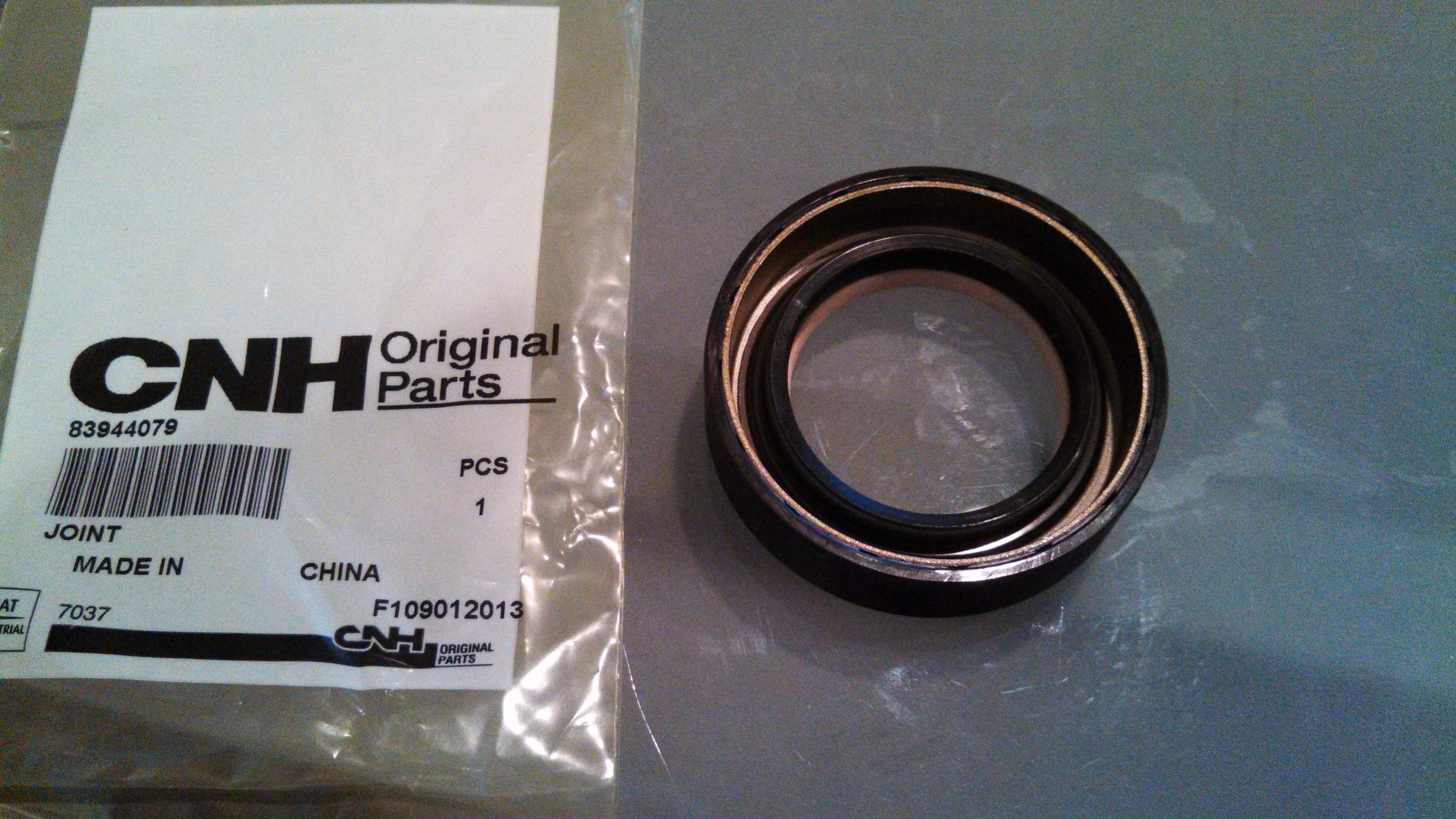

seal open on both sides? i'd have to see a pic. I'm not following. one side has to be clsed with a web.. otherwise you have 2 concentric circles and nothing inbetween. you don;t have 2 seals back to back do you?
   / PTO shaft leak any hydro question
You know how a normal seal has the flat part on one side and then the "open" side with the spring? This was a TISCO seal and there was no "flat" side. Imagine viewing a cross section and the metal would look like a T, as opposed to looking like a L. I will have to shoot you a pic. Going to the CNH dealer and seeing if they have any seals, instead of mail order again.

erird on T profile seal. in any case. spring and lip goes toward oil.. if you are lucky maybee you can press it out without deforming it, and flip is so the spring goes toward oil.
last cnh seal i bought was 'normal' cup shaped. maybee they changed them? If it seals.. it seals..

Hi! Here is a pic of the CNH seal I bought today. Way better looking than the Tisco one I put in backwards. I will have to grab a pic when I pull the other one out and post it. For the extra couple of bucks I think the CNH seal is worth it.
   / PTO shaft leak any hydro question #10
yep.. that's the common seal i have been using a while now. open end w/ spring towards oil.
that tisco one sounds like junk! witht he way it was built.. no wonder you slipepd it in wrong.
shame on tisco!
