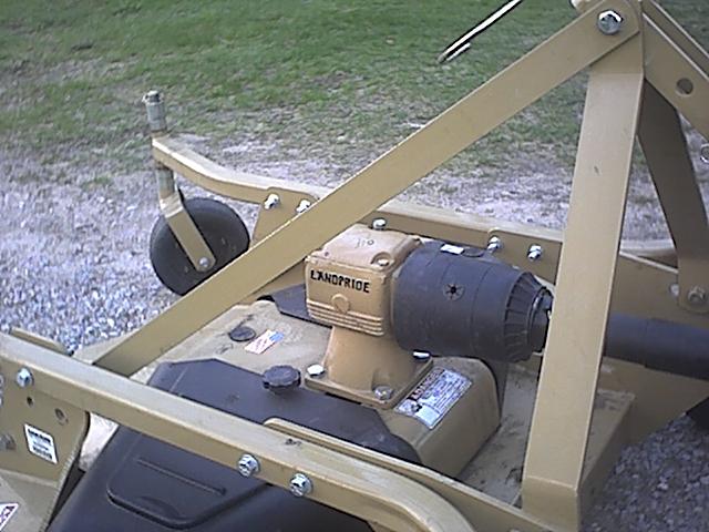

Back in February/March of this year I purchased a mower deck as part of a Kubota package (B7510, FEL, 60 blower & mower). Well spring up here North of the 45th has finally progressed to the point where I needed to mow the lawn for the first time this year (May 16). Shortly after starting to mow the PTO shaft fell off the mower. I assumed that I had not attached it correctly and took care to get in on securely the second time, and the third, fourth, fifth,…… What can I say, I’m a bit of a slow learner some times. /forums/images/graemlins/blush.gif
After close examination of the PTO connection to the mower I noted that the retaining ring was not sliding all the way back into place over the bearings that secure the shaft to the spline. I did everything I could to get it to lock in place but no luck. I swapped the shaft end for end and it is not the shaft. Either end locks to the tractor spline just fine and neither end will lock to the mower spline. I compared dimensions of the tractor and mower splines as best I could and if there is a difference, it must be very subtle. /forums/images/graemlins/confused.gif I have attached a digital photo.
This is the shaft that came with the mower. It still has the Land Pride sticker on the safety shield. I tried everything I can think of, short of getting out the file and making “modifications”. Given the safety implications of a PTO shaft that constantly drops off the implement I decided against trying to tweak this myself.
The grass is growing but I’m not mowing. /forums/images/graemlins/mad.gif
Anybody got an idea?

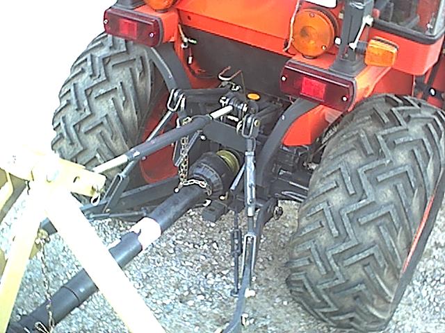

Sure would like to see more than I can see in that picture. Does the mower have a slip clutch or is it a shear bolt? And you're able to swap the PTO driveshaft end for end? That sounds like Land Pride is different from any of the implements I had.

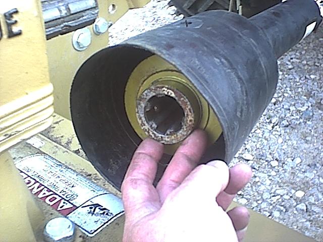

Here are a couple more photos. Hope they help.

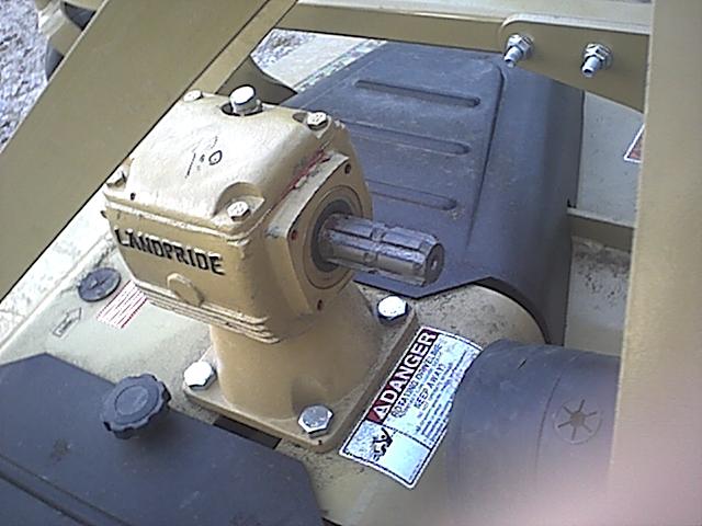

Sorry, but I can't see what's keeping it from going on far enough to lock. If they go onto the tractor PTO output shaft, then you obviously know how to do it and are holding the lock ring back to get it started. Is there a difference in the length of the implement input shaft from the end to the groove the bearings lock into or maybe a burr on that shaft? Otherwise, I just don't know.
   / PTO Shaft Keeps Falling Off #8
i can't see anything from the photos that would stop it from locking on, is it possible that it is something on the connection at the mower deck? and not the pto shaft, that is stopping it from slipping on far enough to lock?

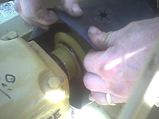

The spline can push clean through the collar on the shaft, so its not bottoming out. I can actually push the shaft on to where the bearings are past the groves (lands?) that the bearings fit into, so that doesn't seem to be it.
We check the mower shaft; visually, by feel and with a pair of callipers. If that son-of-a-gun is differnt than the one on the tractor, and it MUST be, I surely can't tell you where. /forums/images/graemlins/confused.gif

With the shaft off the mower and the tractor, can you apply pressure to the bearing that locks on the mower shaft, the one that is INSIDE the collar. If you can and it shows no resistance to movement with the collar in "locked" position then you should return the shaft.
