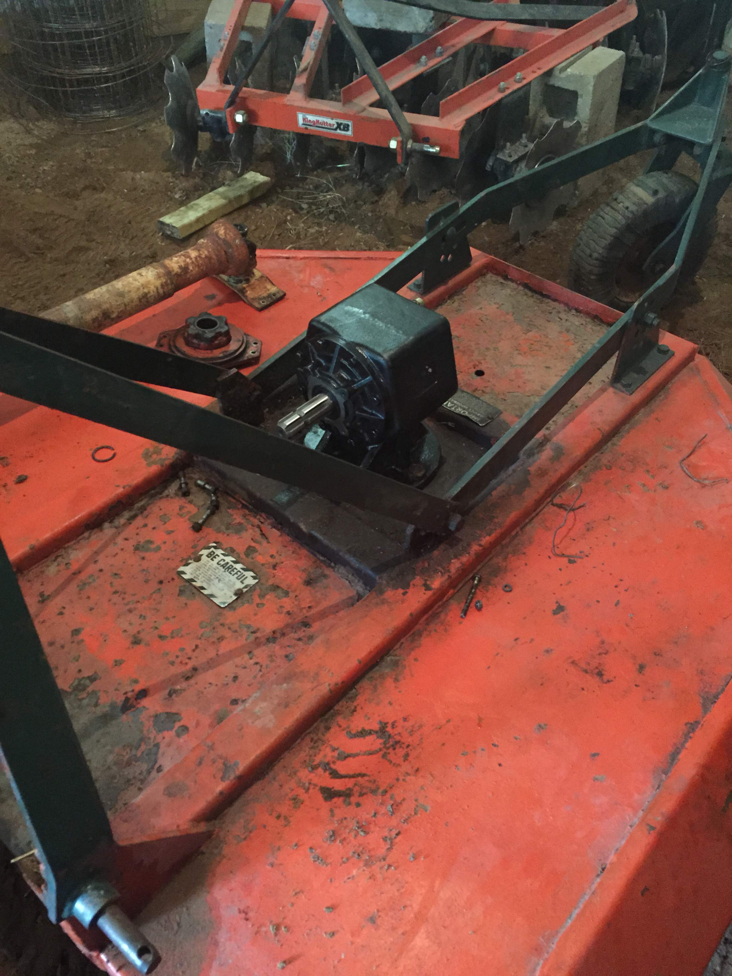

Alright guys, with advice from a few members I replaced a broken gearbox with a new one. My mower now has a nice new 75hp gear box.
Here's the problem, my old slip clutch doesn't fit. The new gearbox has a 6 spline output that will connect to the Pto shaft. What do I need to connect the gearbox to the shaft? Do I just do a direct connect, or shear pin or a clutch? I would prefer not to buy a clutch because of cost. Any advice will be great. Pictures of the appropriate attachment part would be appreciated.
Thank you.

I will attempt to add a photo of the mower. You can see that its a 6 spline input. In the background, on the mower deck is the old slip clutch. The slip clutch is too long and there is no way to secure it to the output shaft. Again, I am looking for an option or way to attach the pto shaft to the gearbox input shaft.
Thanks.
Here is a link to the gearbox. 75 HP Gearbox, Rotary Cutter Gearbox, Rotary Cutter Gearboxes | Agri Supply, 493
Here is a link to a shear bolt yoke. Is this what I need? PTO Shaft Torque Devices

That looks exactly like the shaft on all the rotary cutters I've seen. The piece laying on the far side of the deck doesn't look like any of the slip clutches I've seen, you may have some oddball shaft. We would need to see pictures of the clutch and shaft you have and where it attaches to the gearbox.
I think you may need a new PTO and slipclutch made for that gearbox. If available, any adapters you add will require shortening your existing shaft by an amount equal to the length of the installed adapter.
   / Pto shaft attachment question. #6
Your slip clutch doesn't look like anything I am familiar with.
This replacement shaft / clutch would be what would work with the way you are set up now.
PTO Shaft, Series 6 | Agri Supply #66655
Double check length of your existing before buying a new one.
